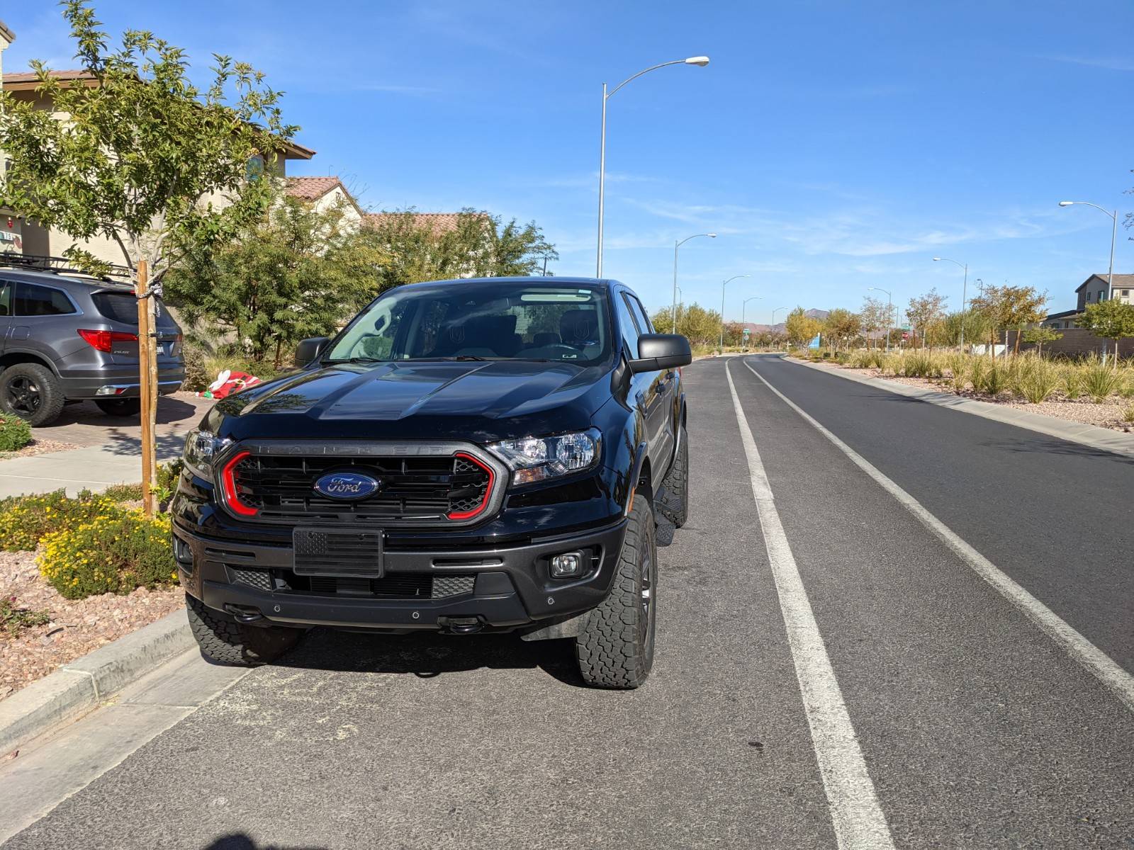

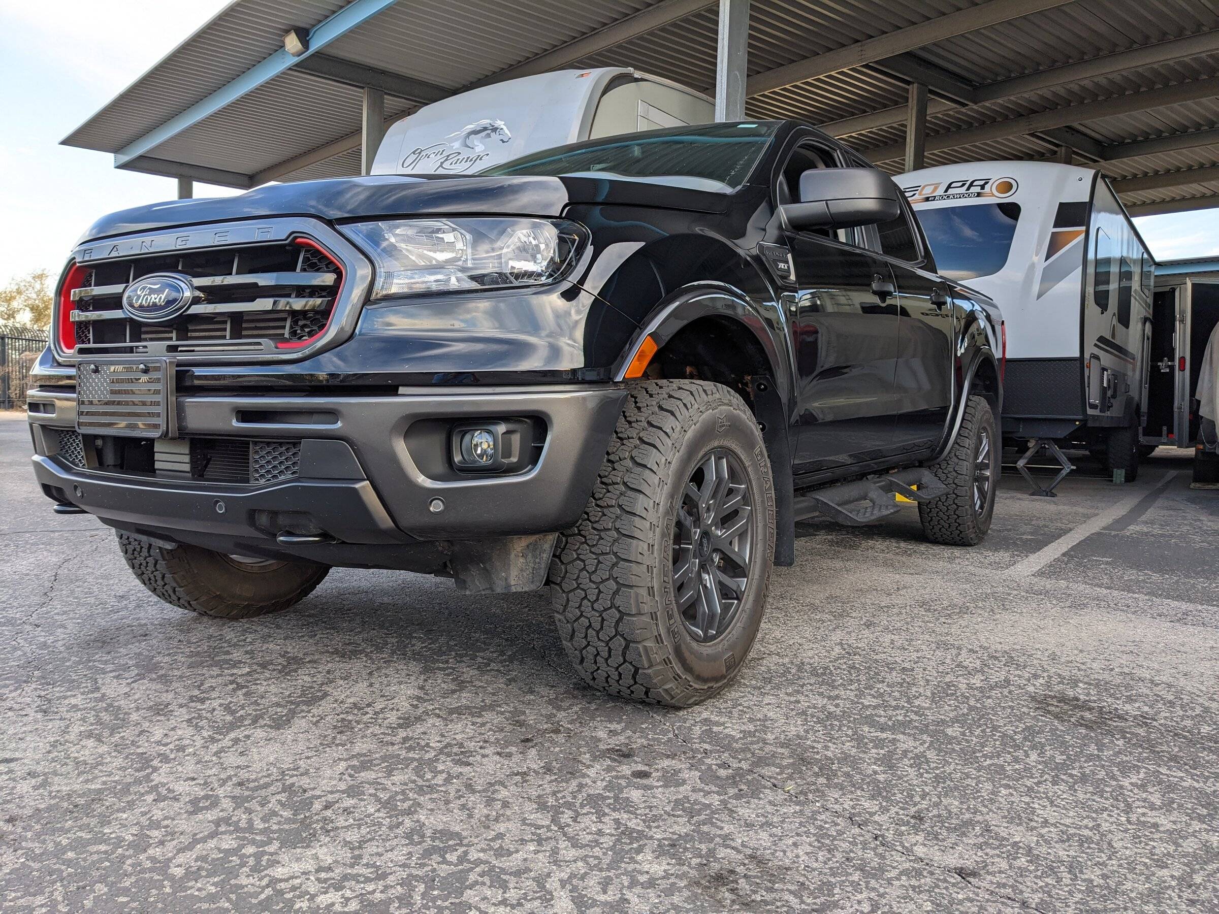

Well, 1" wheel spacers fit without a lift, MAYBE 1.5" with 1" life. I just had to push out my crash bars in the front. I get a tiny bit of wheel rub in reverse only in one direction so I might double check that side to see if the crash bar can move up some more. With the 1" lift, it would just gain in clearance.
So if you want to play it safe, get the 1" wheel spacers. 1.5" will likely be no issue with the 1" lift if you want the wheels to stick out a little more.
1" is subtle in pictures but here they are installed on stock Tremor height.

Thank you Anthony !
