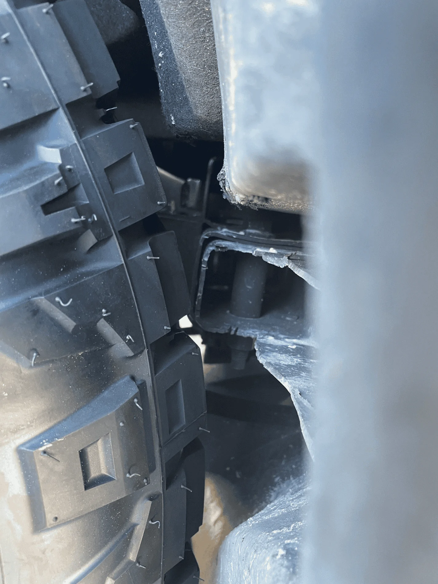

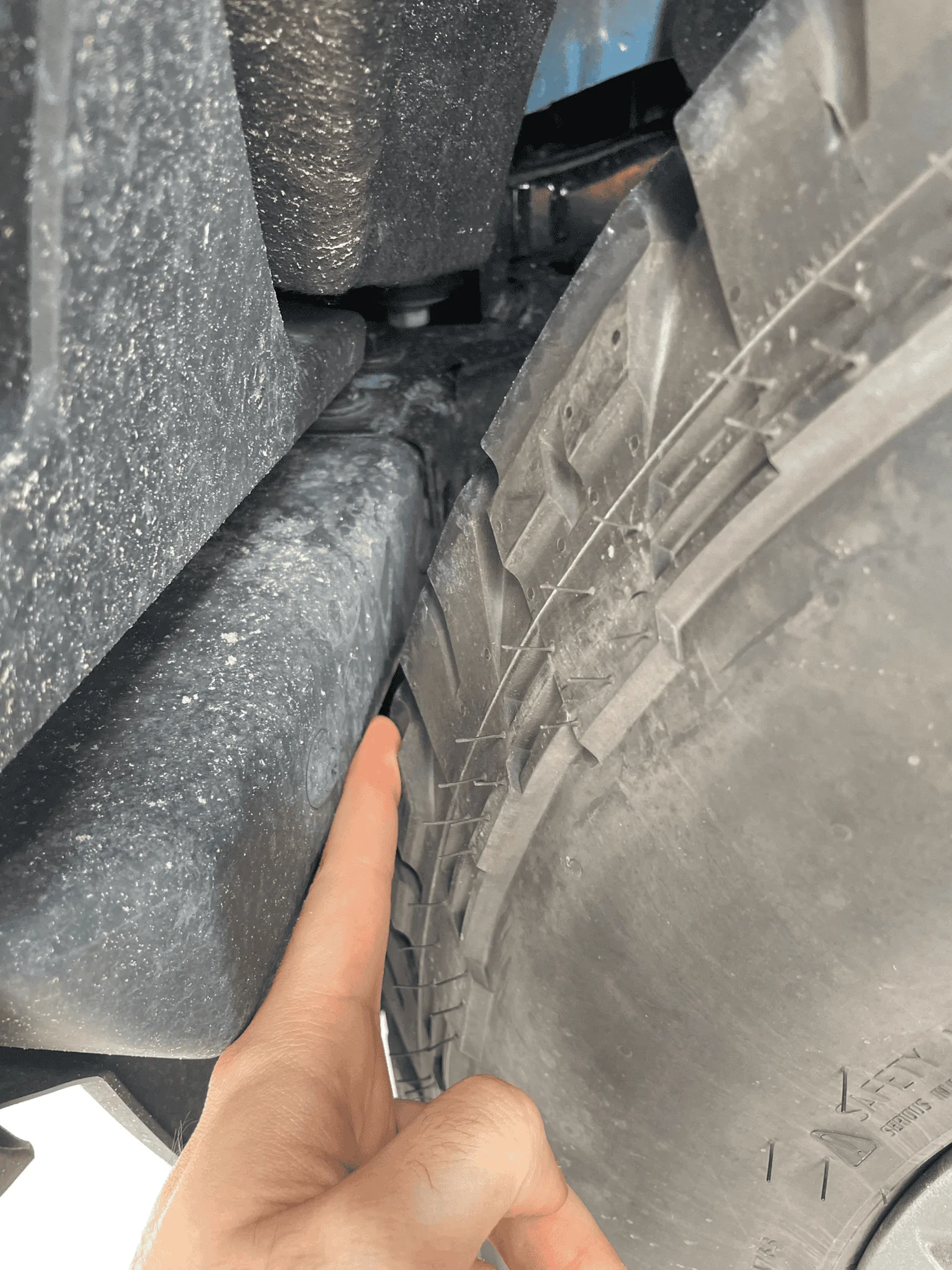

Hard to say for sure, i do know itll probably be way too close for comfort.
This is my tremor completely stock and its distance to the crash bar, almost a finger off the plastic cover which isnt that thick.
I now have 17x9 wheels at a +30mm offset, so very close to a 1" spacer, and 285/70/17s on.
Hard to tell from pic, but its goes a good bit into the crash bar. now of course my tires are quite a bit taller than stock, roughly 2"s, which makes it about 1" closer to the crash bar. Note the damage to the fender was by me while cutting the bar, which doesnt look that good either, but it worked for what i wanted.
Thanks, are those Nitto tires? I was gonna say that looks way closer than what I saw but your taller tires explains it.
I THINK I will just miss things with the 1" spacer but we'll see.
Good eye, yeah those are the Ridge Grapplers.
Im not an expert of how much closer the wheel will be with a 1" spacer, but if i were to guess it would be hopefully only a .5" closer. Id imagine it would be similar to adding 1" wider tires, not exactly but close i think.

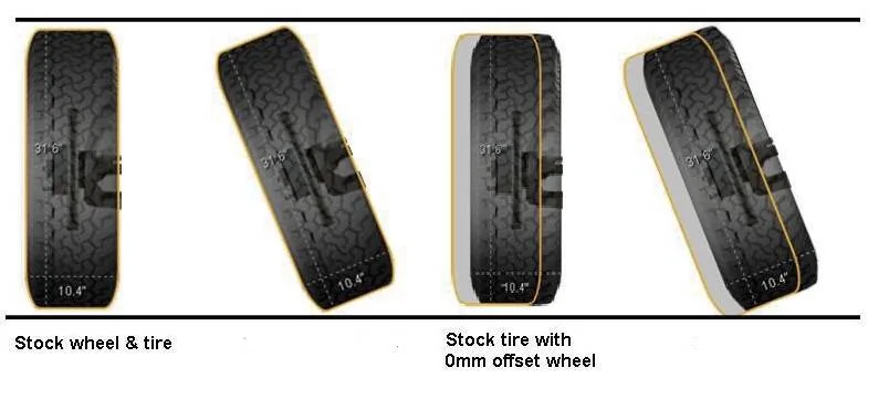

So what’s the deal with the rubbing (don’t mind my ignorance, I don’t have mine yet)? Pushing the wheels out with spacers make the wheels rub? Has anyone done the 2” lift with wheel spacers yet?
Here’s a thousand words below - the horizontal line represents crash bars - the grayed out tire represents the new position due to lowering the offset, which is the same as adding a wheel spacer…
Or, imagine it this way…turn your wheel so the outside edge is “pointing” at the crash bar, now push the wheel out with a spacer - that edge gets pushed closer to the crash bar.
I totally get it now. I feel like an idiot for not understanding it earlier. Thank you!
