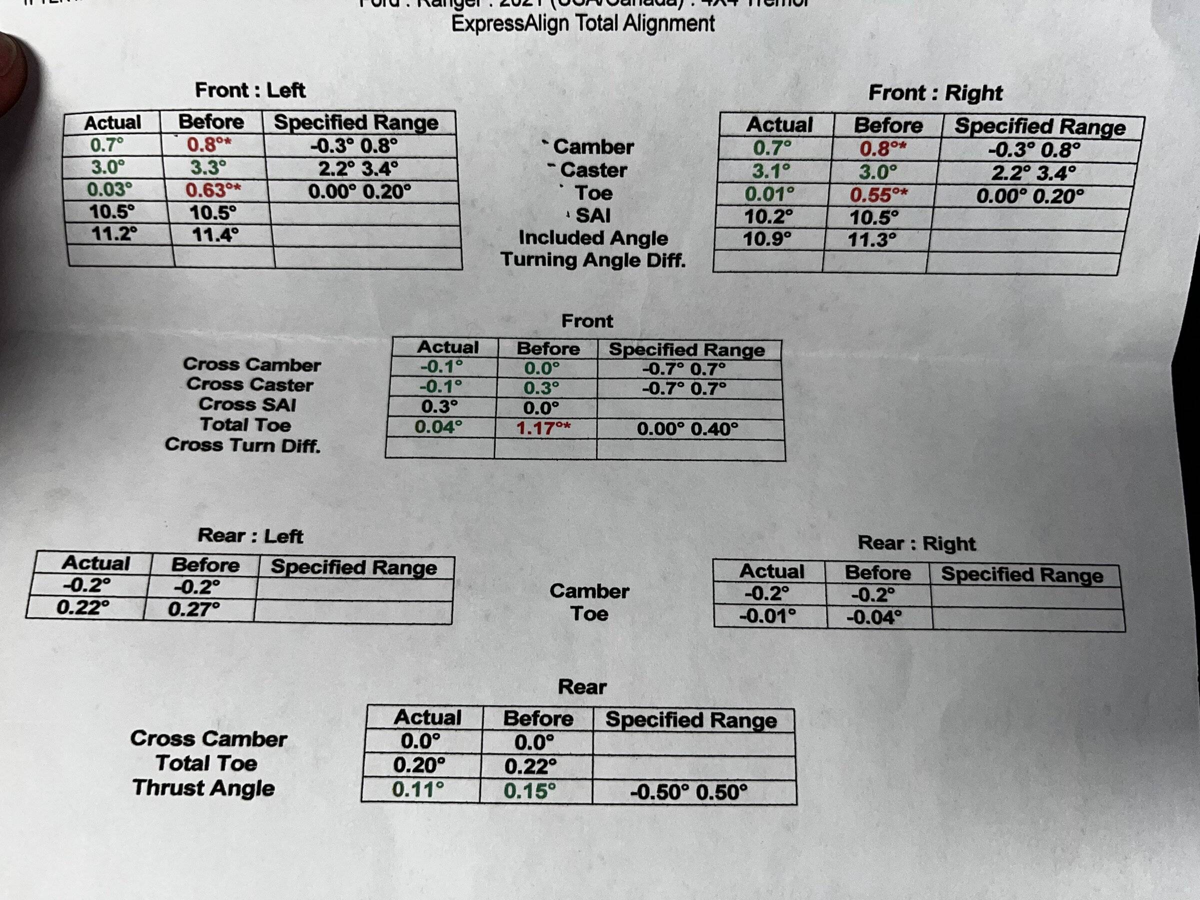

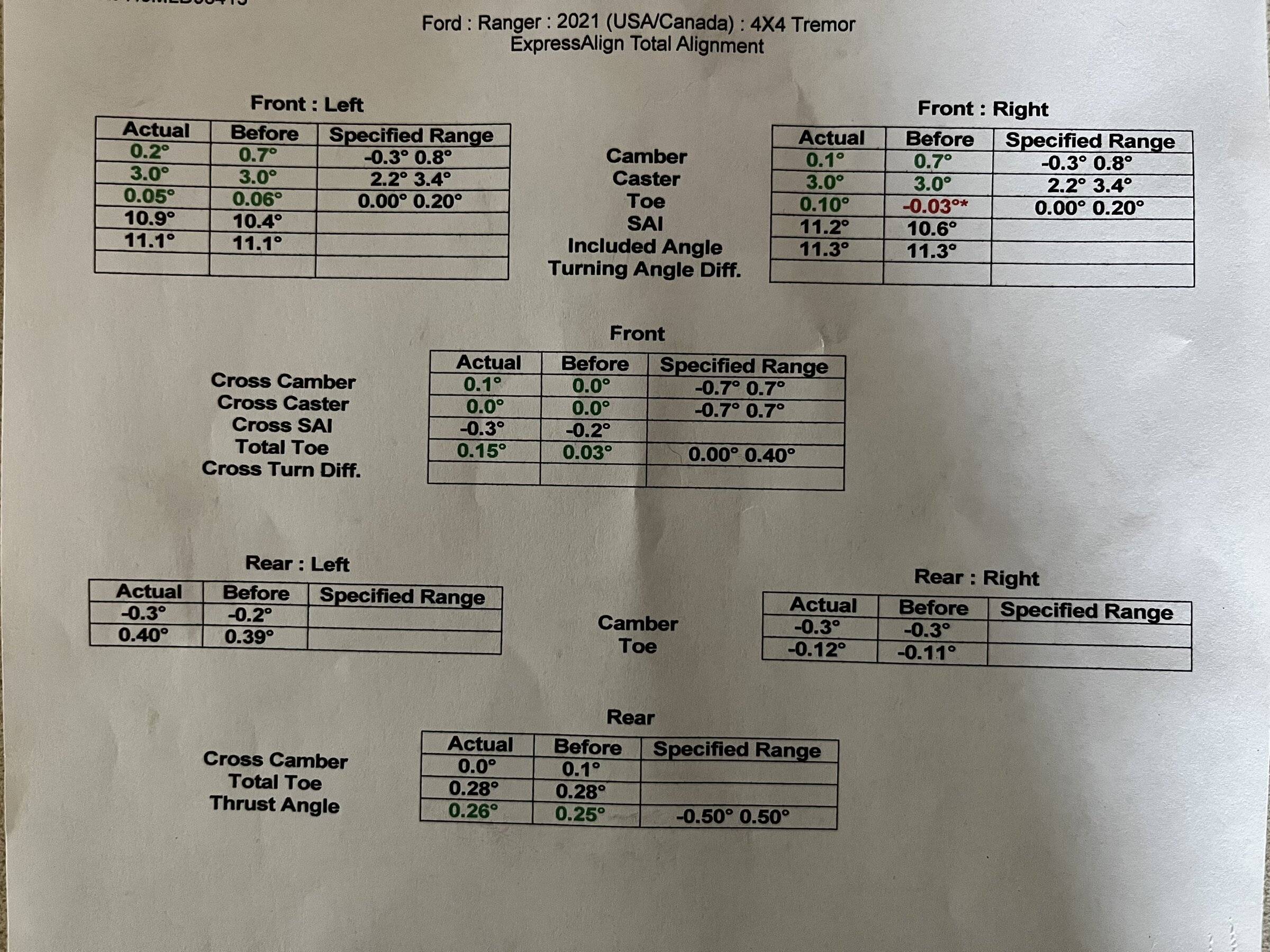

Got my alignment redone to try and reduce the camber values

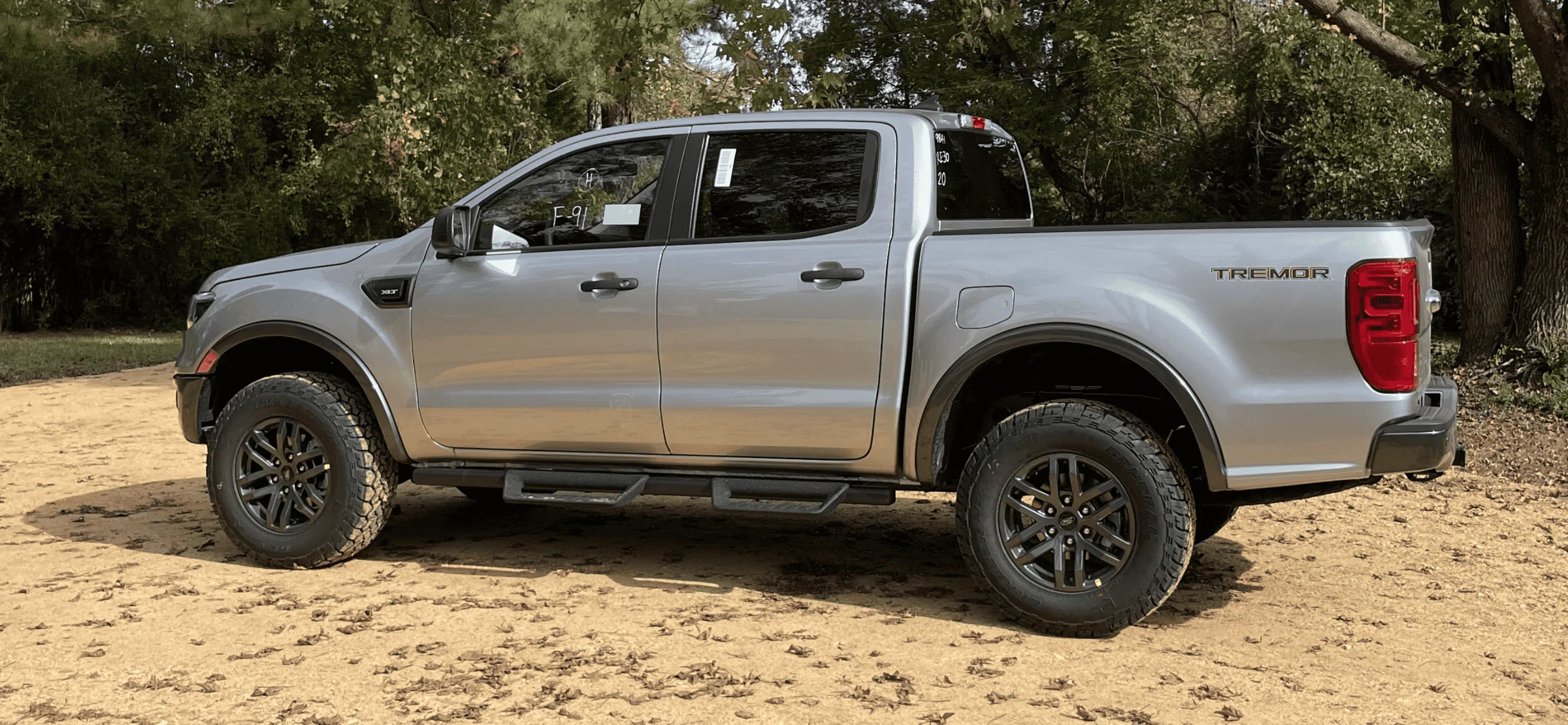

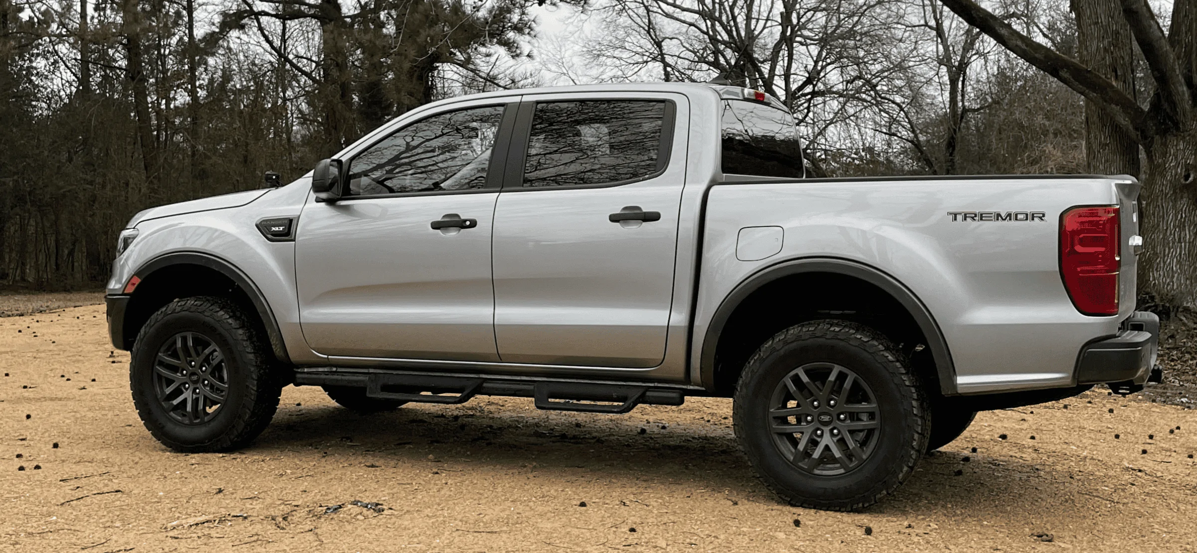

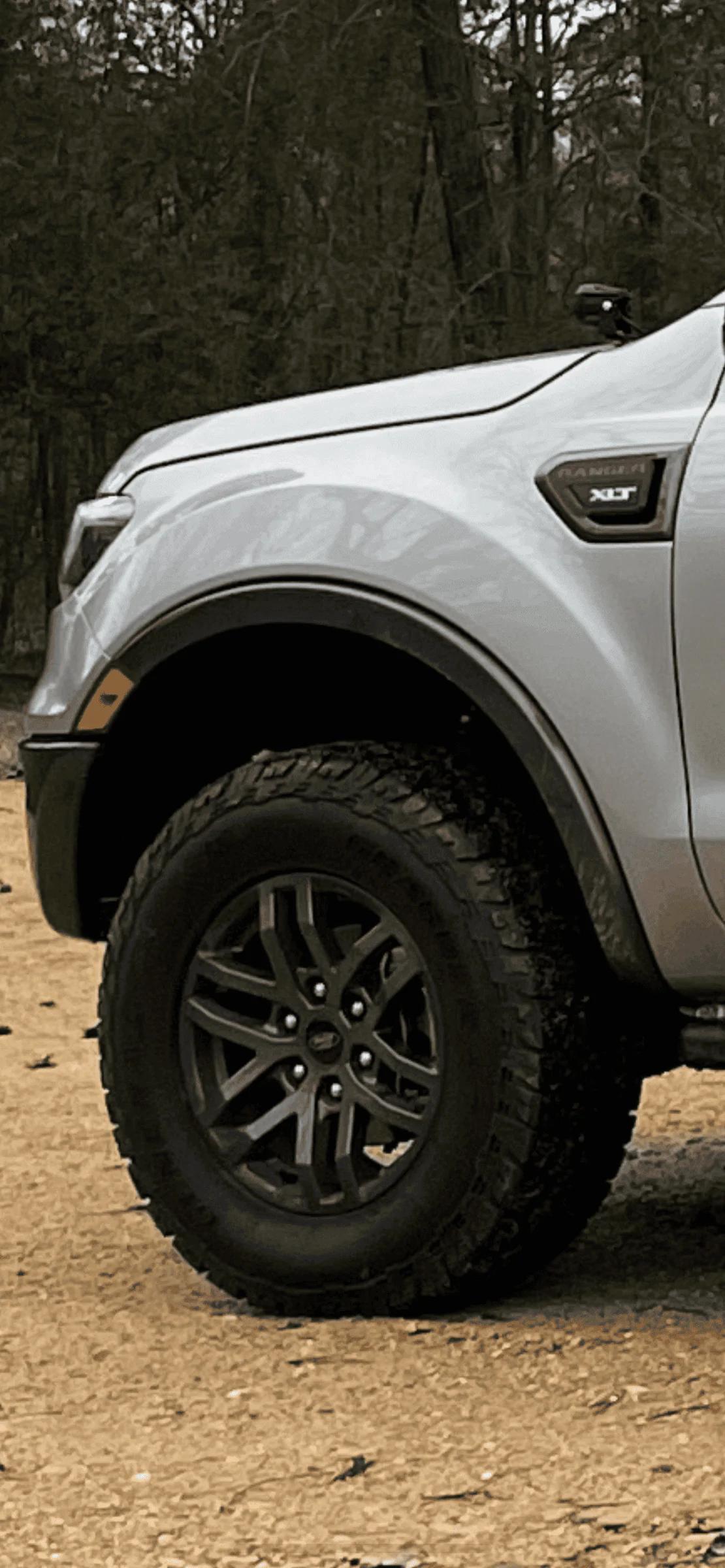

A couple of before and after pics… I went with the 1” because I tow often. My gas mileage average dropped at minimum 1 mpg after install. Overall I’m very happy with the look. It’s a little front high when towing my sxs and 12 ft trailer but not too bad. Remember to adjust your headlights or you’ll get bright lighted often.

^ that looks perfect. I'm going forward with the 1" as well. Exactly the look I'm looking for...little bit of rake but still a better stance than stock. thanks for the pics bud!

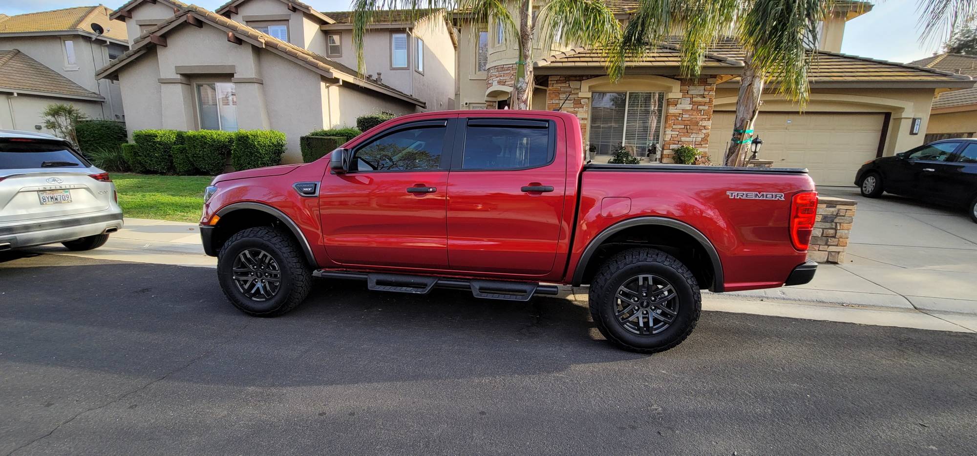

Finally got the 1" spacers installed today. Love the stance. Still some rake but I added 2 inches of fender space in the front (I had measured before/after).
Definitely can "feel" it when I picked up the truck from the shop this afternoon. I wish truck came with this stance from factory as IMO, 1" lift is perfect (even for towing).

Aligned it after, the vehicle is so new that our hunter machine did not have the specs for the tremor so I used a 20 4x4 ranger as the vehicle and manually entered the specs for the various angles. Also adjusted headlamps down so im not that guy at night.
