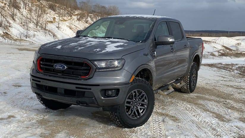

Maybe you're looking for something more like this? Will cost more to modify to this but it can be done. Now this you notice!

Everyone here has a valid point. To sum up, OP Tremor looks stock. OCL Tremor wheels look sunken in by about 2.5 cm.
