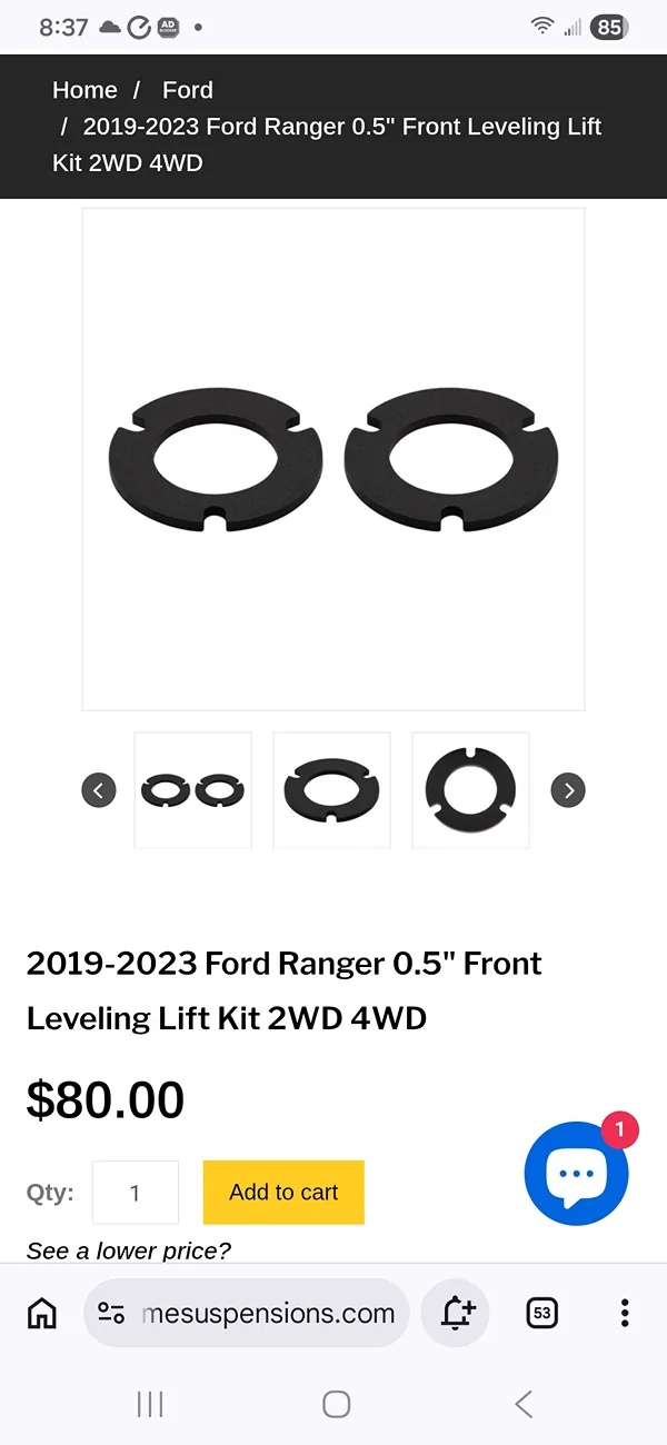

And if I had it to do over, I would have put one of theses on the drivers side to help with the "lean" instead of having to crank up the spring more on one side...
That's the point of having adjustable coilovers. To make the little adjustments needed to balance everything out.
NotBudule2
Robert
Jul 8, 2024
1,025
4,302
WV
21 Ranger
Ford has different springs for driver/passenger to make up SOME of the difference, Eibach does not , mine was leaning worse after and I would rather have had some shim on the drivers versus having the coils that uneven.
21rangerCactus
Nov 3, 2021
363
867
Louisiana
2021 Ranger XLT
Self employed
But then that spring and shock would be compressed 1/2 more then the other side. Where as making the adjustments needed only the shock is compressed. Which is fine because it's designed for it.
Just saying, that's one of the positives of having an adj coilover setup. I had it on my fbody and I have them on my GTO. Both needed 1/2 or so adjustment between each side to make it even.
