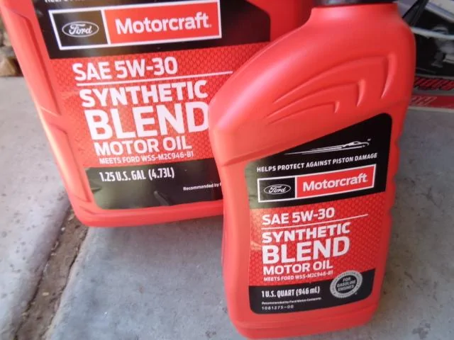

MOTORCRAFT SYNTHETIC BLEND!!--Specified in the owners manual
Actual the owners manual states that Motorcraft Synthetic Blend is recommended... what it specifies is an oil that meets WSS-M2C946-B1. There are a lot of oils that meet that specification.
Motorcraft Synthetic Blend isn't the best choice when looking at a variety of tests.

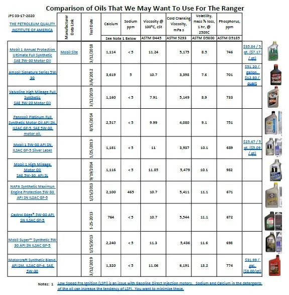

Amsoil oil and filter.
Only have 540km on the Ranger. After the break in I will be putting AMSOIL Signature Series and an Amsoil filter.
Amsoil has an insane amount of calcium... and that's not a good thing for GDI engines...
Something around 1,000 is good... it has over 3,600 :shock:

Amsoil’s 5W30 Signature Series has 1300 ppm of Calcium and 1000 ppm of Magneseum to meet Fords Specs for the LSPI Motors.. It’s a requirement from Ford in order to be able to recommend an oil to make sure the right protection is there and warranty approved.
