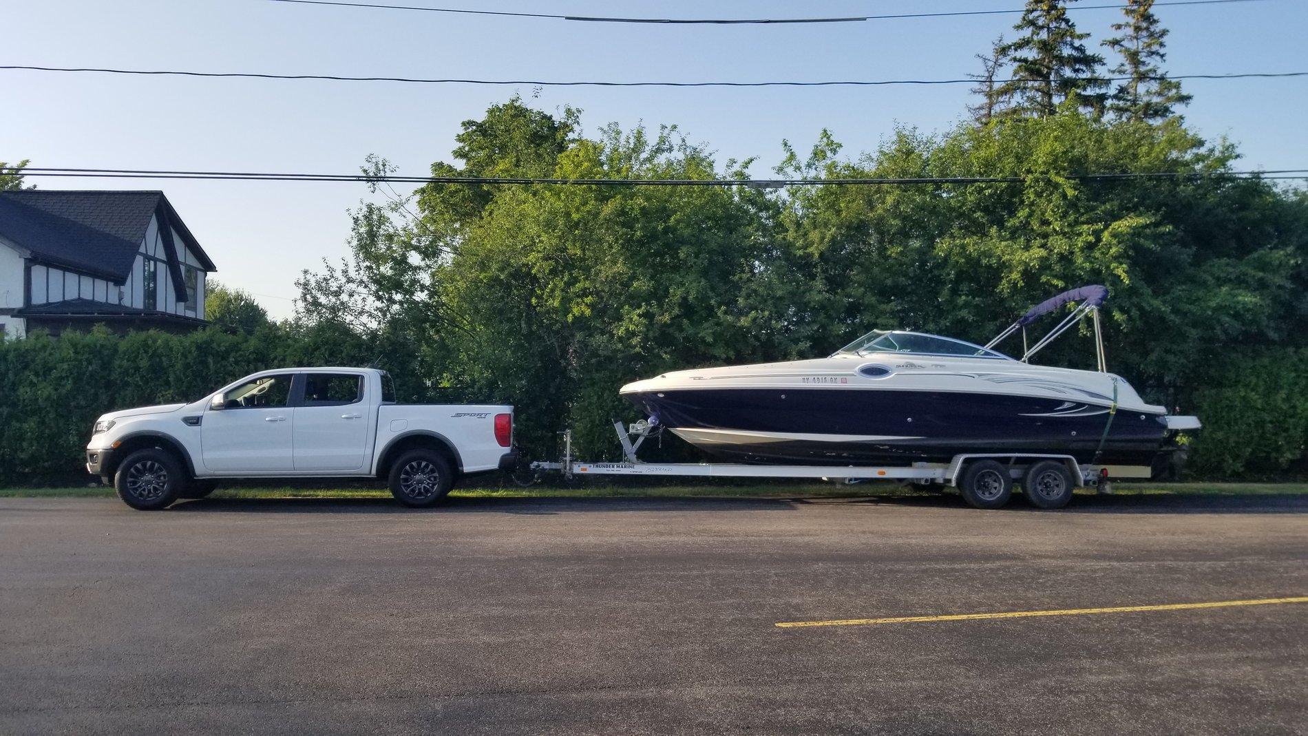

24' Sea Ray. 4,700 lbs dry, 6,600 fully fueled on cat scales. Very spongy in the rear but never felt out of control or nervous at 55mph. It stays in the water, only pull it out to work on it and clean it but if I was going as far and frequently as you I would get something bigger.

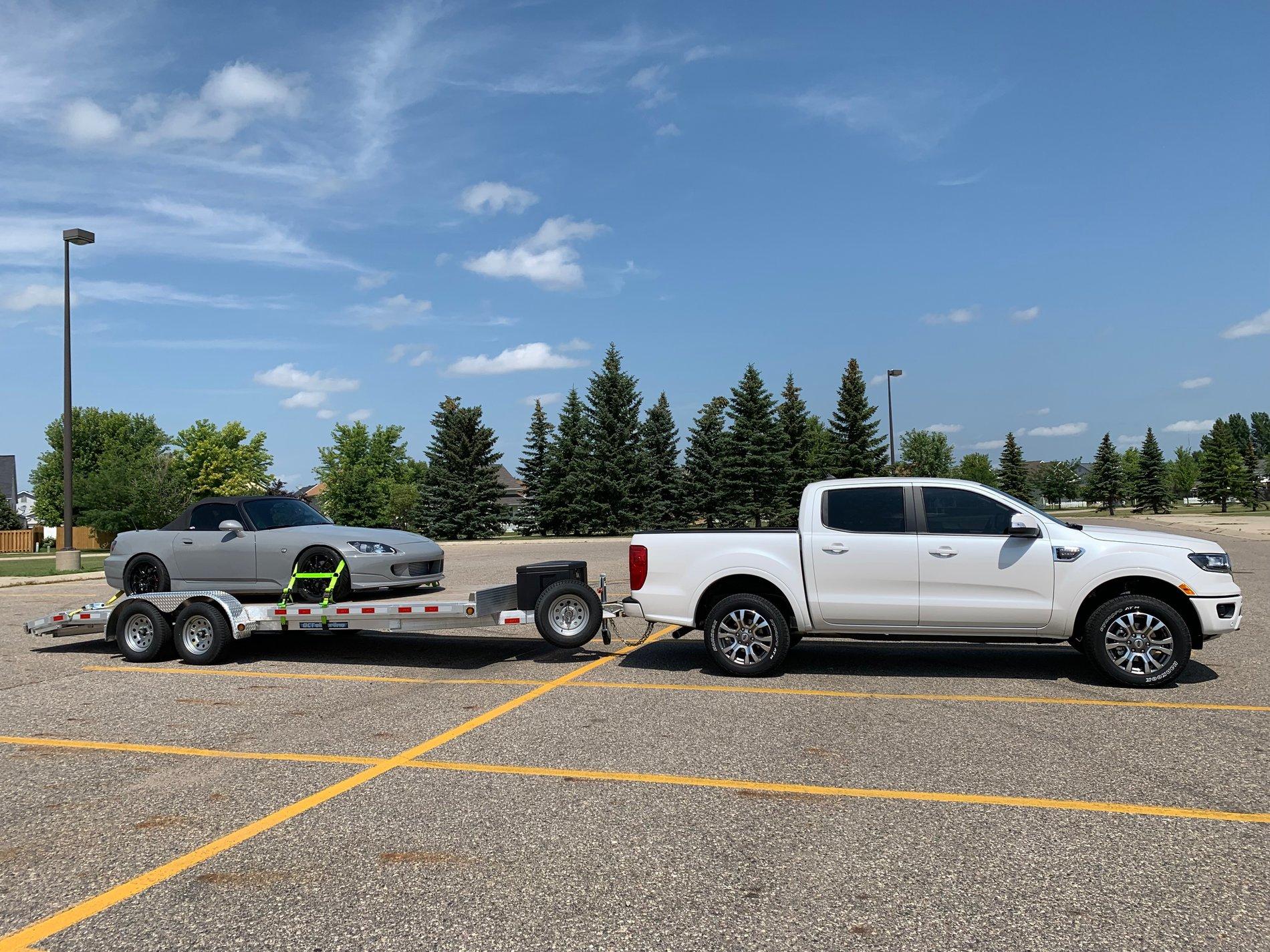

Pulled the car and trailer 150 miles each way out to PowerCruise and back this weekend. The Ranger pulls this setup 100% better than my '17 Tacoma did. The Tacoma was tuned (OVTune), had a shift controller (Shift Sense Pro), and even had airbags in the back to help with the extra weight. The Ranger is completely stock but with the RedArc Tow Pro Elite (had it in the Tacoma too), and pulls beautifully with zero drama. The difference towing with this new Ranger powertrain is unbelievable when comparing to the turd gen Tacoma. I got right around 15.5mpg on the way home battling a light wind. The Tacoma got 9-10.

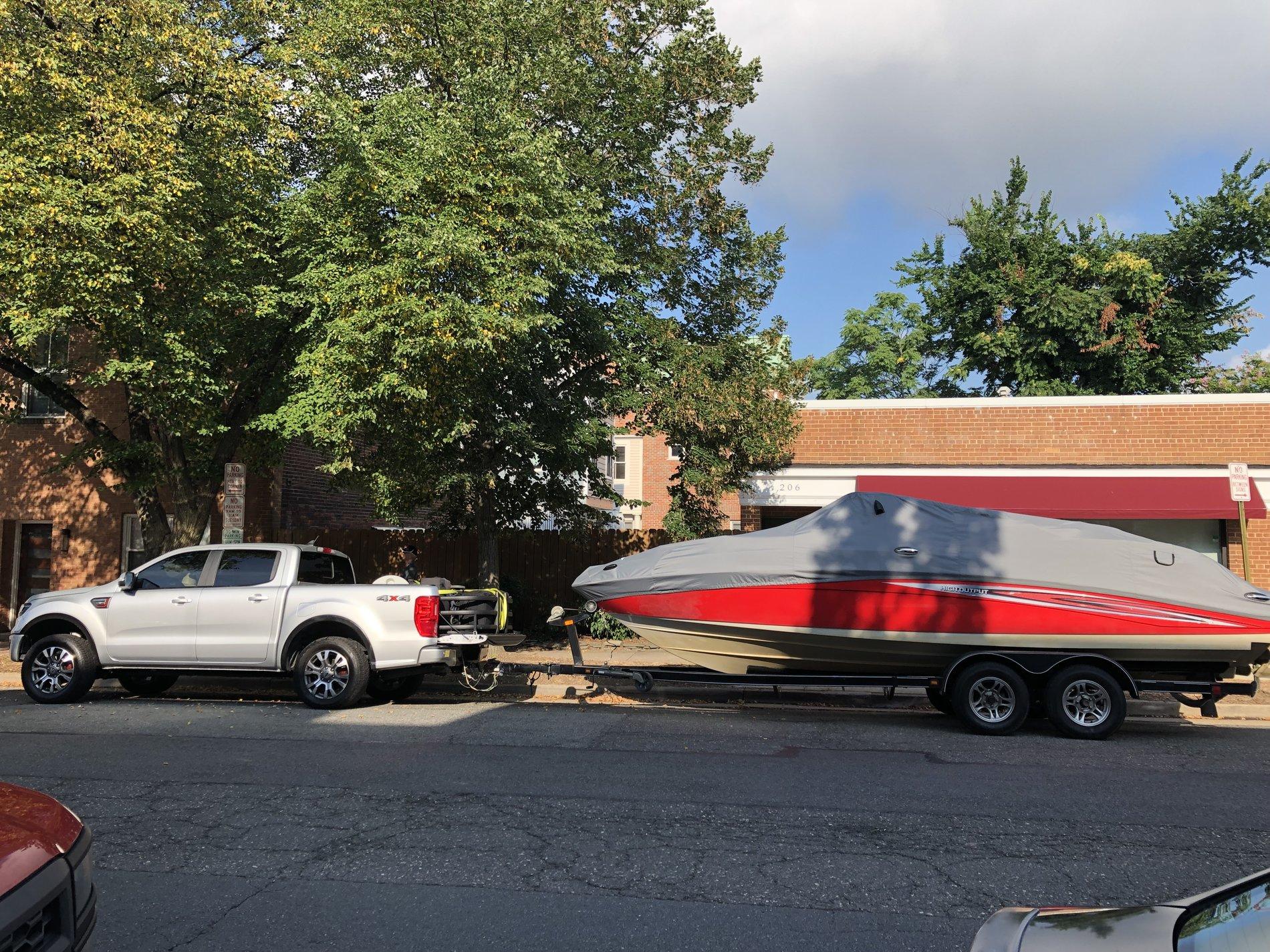

23’ boat 500 miles over the last few weeks including up and over the blue ridge mountains once. No problem. Trailer has surge brakes. Averaged 13.7mpg according to onboard computer at least. Very very happy with how this truck tows.

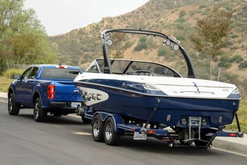

Seems bizarre that the article is all about towing a 24' boat but they neglect to tell you what that boat weighed. They did tell us that the Ranger weighed 4500 lbs, the occupants and gear was 400 lbs and the combined weight of the Ranger, boat, gear and occupants was 10,355 lbs. Guess that means the boat weight was 5455 lbs (10,355 - 4500 - 400).

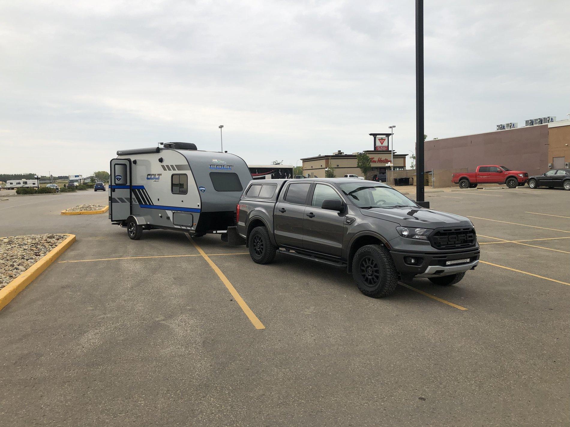

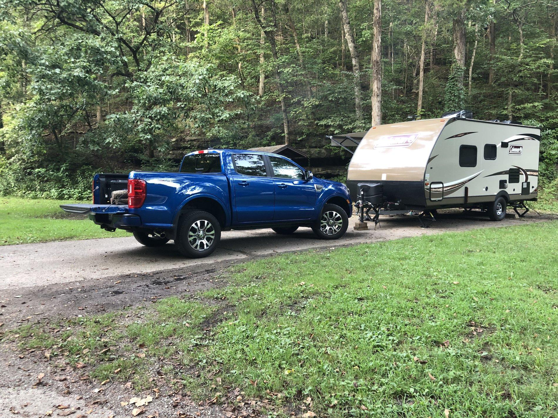

Took the new camper on its maiden voyage
And?? how,d it go? camper specs etc. We are mainly backcountry, canoe, hike, etc. tent campers, but now in our mid 50s we are considering a rig like this for some longer trips, rpod, humminbird, etc.
Thanks, Todd
