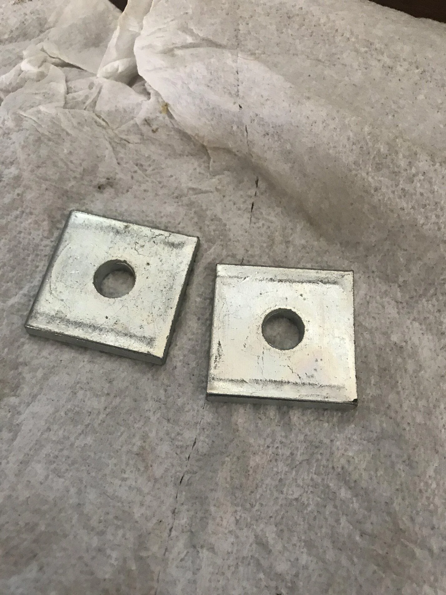

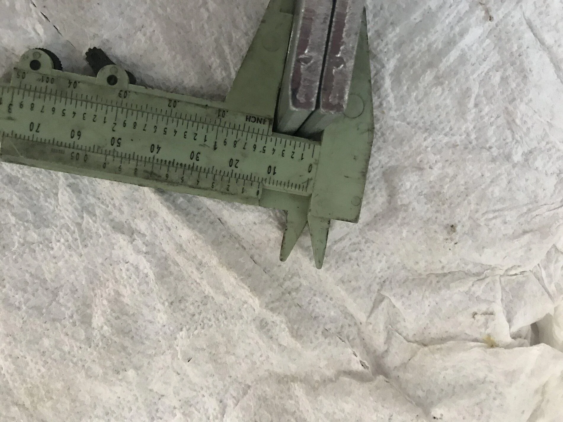

I have had what I call a miss, stumble, vibration around 1500-2000rpm since new. I’ve done a lot attempts to eliminate this with little dealer assistance. I felt sure it was fuel injector related but never got a CE.
Anyway the latest fix, as it appears for now, 2weeks, is shimming the driveshaft center bearing. I’m still skeptical because from what I noticed is it’s more prevalent in cold damp weather, whatever that’s got to do with I don’t know, maybe fuel grade???
I added 1/8, to 1/4 and now 1/2 spacers with longer bolts. The truck has never been smoother.
When it’s cold it’s a little balky but when hot I don’t notice the old vib at all.
Again, I’m still skeptical that it won’t come back in the Fall, if so, imo it’s fuel related, injectors.
Im retiring in Oct. and will have plenty of time to deal with the dealer if it comes to that. The saggy seat cover is also something I want fixed.
My truck is a 2wd and has a bit over 15k miles, Eibach’s coil overs for a 2” front level. Stock tune. I run mid-grade or premium fuel (I also have been consistently using Exxon fuel for a month now) Most of my driving is city and in that 1500-2500 rpm range. I’ve loaded 2 different tunes to rule out Fords tuning but only had the stumble/vib move up in the rpm range.
The spacers I used are from Unistrut hardware that some folks may recognize. The only issue with these would be that they are not perfectly flat.
It’s working for me.

Do you have the part number or link for those? I am doing the same thing and need 3/4 of an inch drop.. I am going to use those or maybe 3/4 square steel tubing? Currently have body shims installed for testing.
No I don’t. Any place that sells Uni-strut should have them but, I kept playing with them and found my erratic vibs would show back up.
I’m back to stock now.
