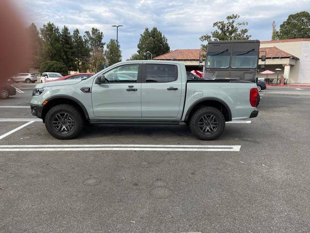

Here is the final ride height, 37" at all the wheel openings.
