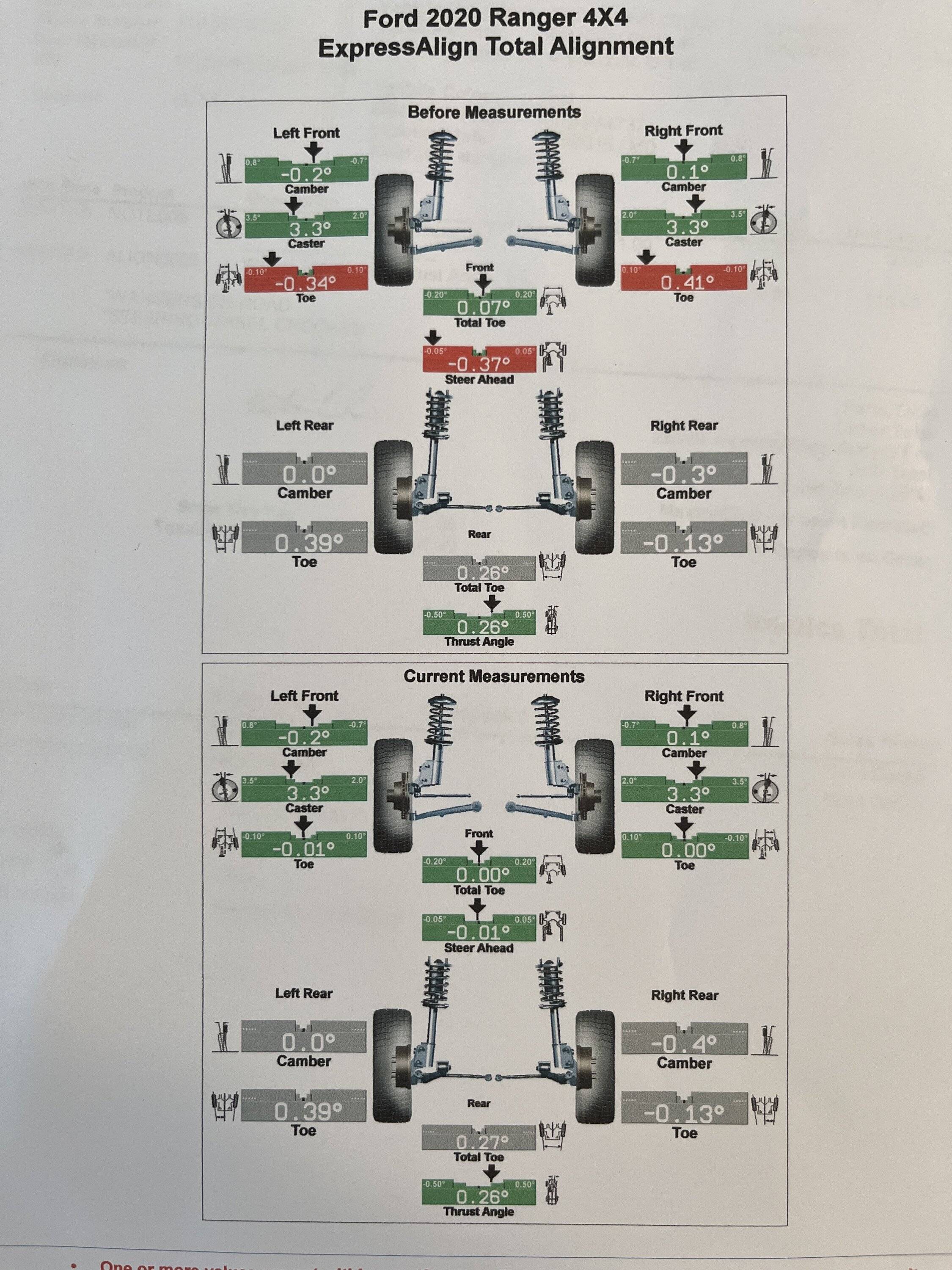

so i go my alignment straight. but as usual i got it back with a crooked steering wheel. they tried to say its road crown…umm no.
so i gotta take it somewhere to get that straight. literally.
it’s crazy.
here’s my sheet for actual numbers-

A little negative camber and maximum allowable toe in would help.
