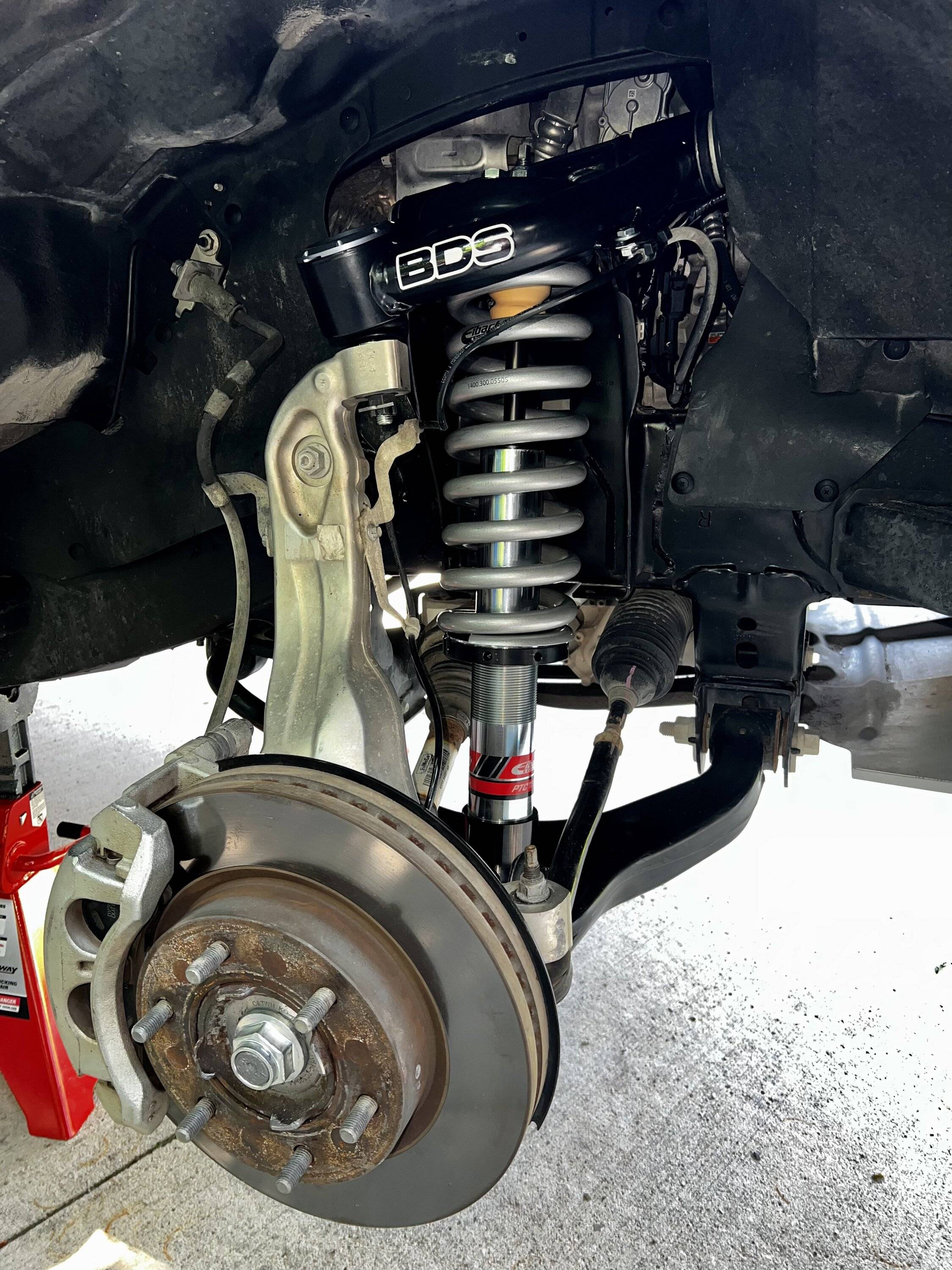

Just wanted to update. I decided to go with the Eibach Pro-Truck coilover stage 2 with rear shocks and BDS uca’s. Install was a snap and pretty simple, just took my time and enjoyed my Saturday. Want to thank you all for the great input/suggestion, it helped a lot. Also a big thanks to Frank at Stage 3 Motorsports for giving me a great deal on everything and shipping stuff out so quick. I took it for a 10 mile drive afterwards and could immediately feel the positive results, namely no more horrible brake dive. Alignment Monday morning then just drive it and enjoy.

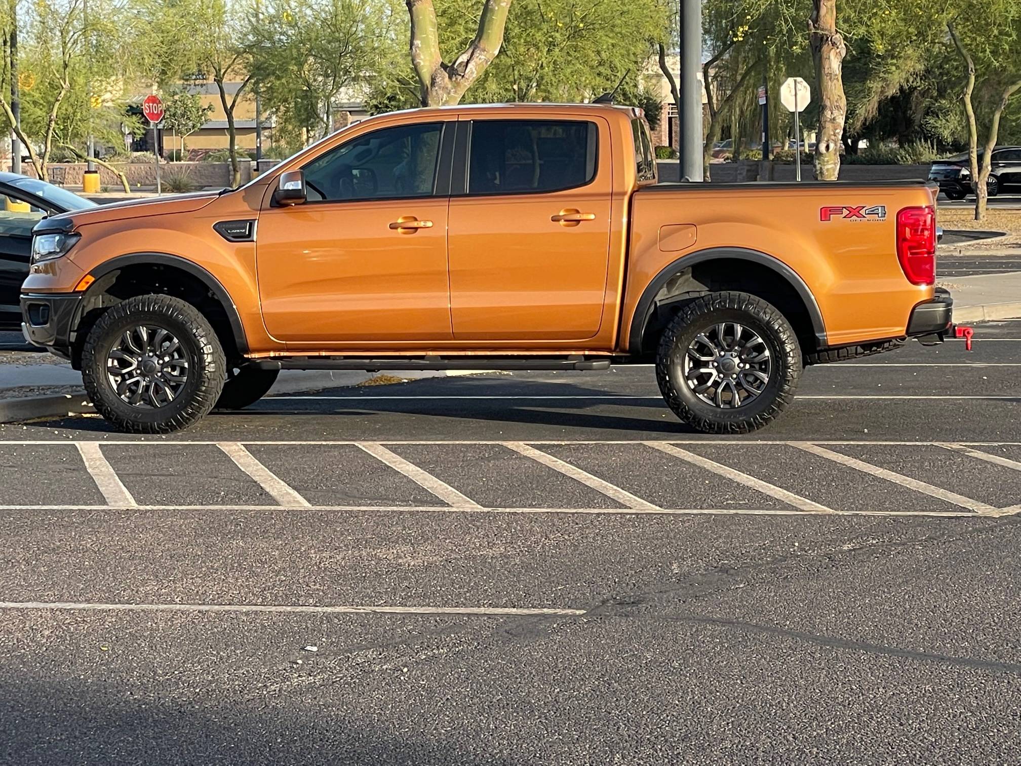

Just to give you a second opinion I just had the Eibach coilovers installed a couple months ago. I had then set to 2.5" and didn't do any new UCA's and it's been fine. I just did a 5,000 mile road trip and off roading a few times and I love them!

Love it ! Drives/handles like a different truck now, free of all the annoying Ranger handling issues from before. I set the preload to give 3 1/4 “ lift. The UCA’s were easy to do since everything was apart and the BDS were at a good price. They come with good Moog ball joints, not uniballs, which I believe to be better for areas where salt is used in the winter.

Hey Chris, I just replaced the shocks and didn't add any blocks to the rear because I don't really haul anything to heavy or tow so it sits perfect the way it is. The tires are Nitto Ridge Grapplers 265/70/17 on the stock wheels with no wheel spacers.

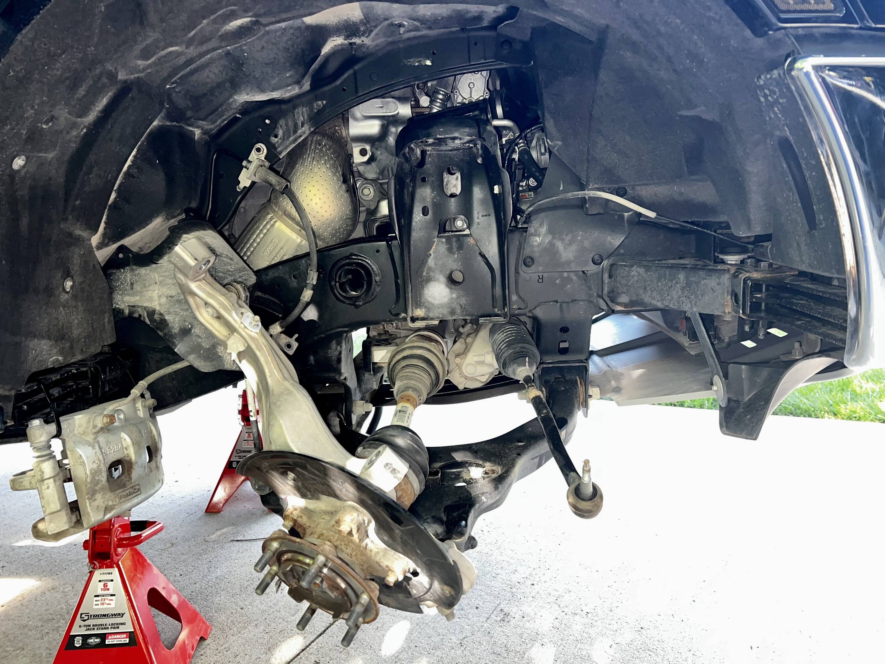

Hey Rob,
Completing a job like this is so rewarding. There’s so much I like about your approach here…
  • double jack stands
  • calliper and rotor removed
  • calliper zip-tied to the ReadyLIFT beam
  • axle nut removed
If you hadn’t taken those steps, your install likely wouldn’t have been a “snap”. Even if nothing went wrong, if you hadn’t removed the heavy calliper and rotor, it would have been a PITA wrestling the knuckle and upper ball joint back together. When it’s done the way you did it, that knuckle is so easy to work with - best extra two minutes of work ever!

Thanks Duke ! I have all the fine folks here to thank for sharing their installation experience that I read up on before starting. I work as a mechanic for a living so some of it was standard operating procedure, but stuff like pushing the axle out of the knuckle saved a lot of grief.

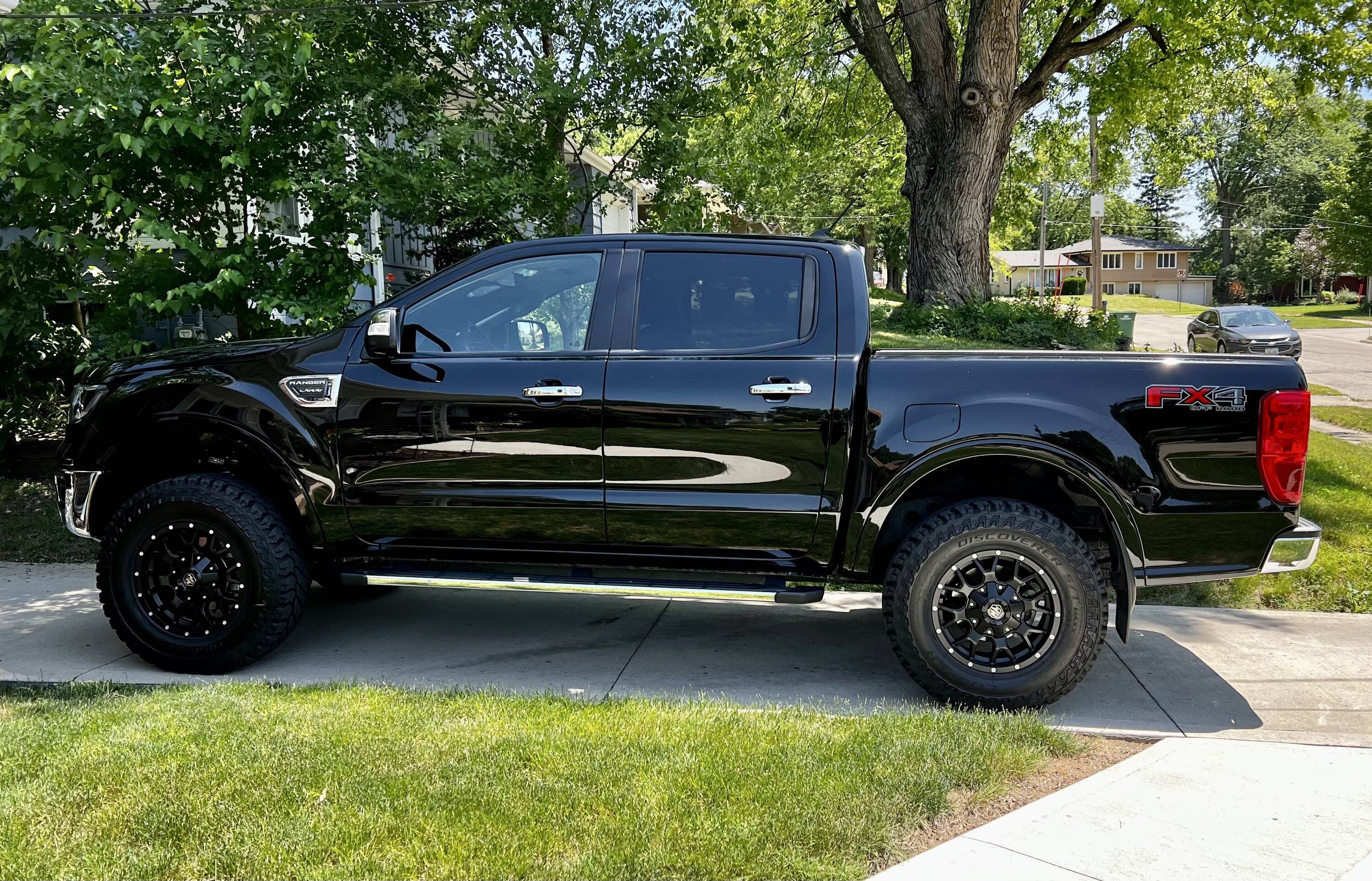

No block in the rear. I had the same rake as yours and now it sits about 1/4” higher in the front than the rear. I think you would be pleased in the construction of the BDS. They are extremely well built. Hit up Frank here at Stage 3, I’m sure he’d cut you a great deal. This photo was taken after my alignment.
