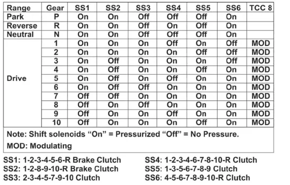

Theory on what happened.
One of the valves in the valve body is starting to slow down or stick just slightly. When you turned off the adaptive trans, the ECU goes into a default strategy which would also not work well since that strategy assumes everything is moving as designed.
When you turned the adaptives back on, the ECU learned that the valve was slow and probably raised the line pressure or delayed something else to make up for the fact that it is taking longer for that particular clutch to apply.
To go from 3rd to 4th there are two valves that need to move. If one is moving at regular speed and the other is slower then you'll end up with a rough shift. If the ECU knows that one valve is slower, it can slow the other one down so they both complete their functions at the same time.
You can try some Lubegard in the trans, the esters in it can help clean up the valves.
