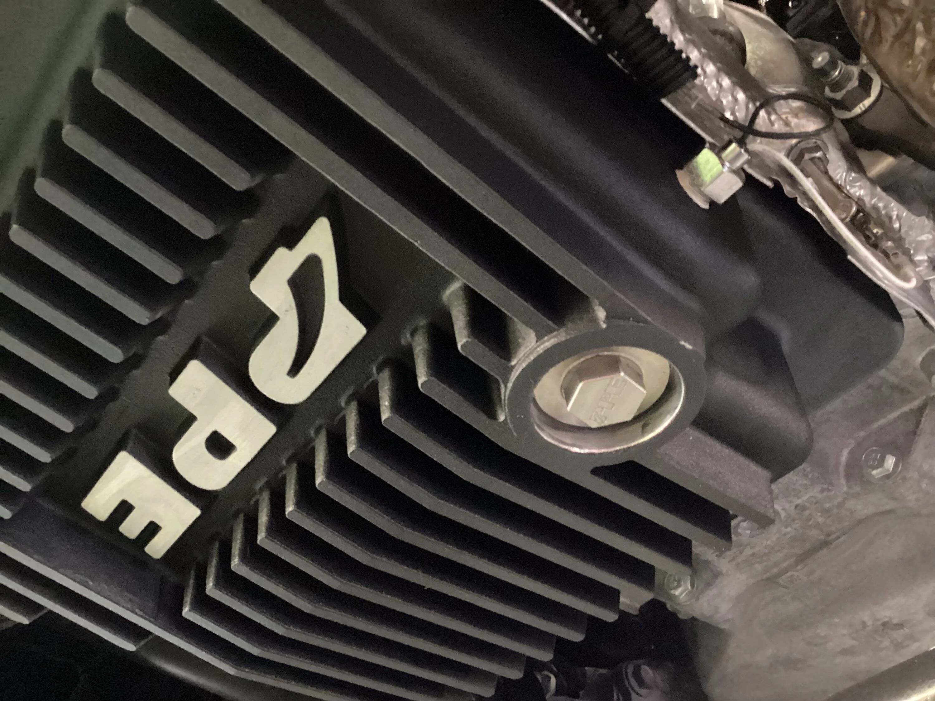

That’s funny post pandemic quality control . Mine was built Nov 20 & bought it 1/21.
I have extended warranty, PPE pan and fluid and filter change.
waiting on forum member to make more dipsticks for sale.
Good Luck everyone, 8000 miles 50% towing 4500 lb camper, no issues yet.
9,203
28,400
NWO Robot Polisher
Beautiful pan! 8,000 miles? Report back when you're at 95,000...
