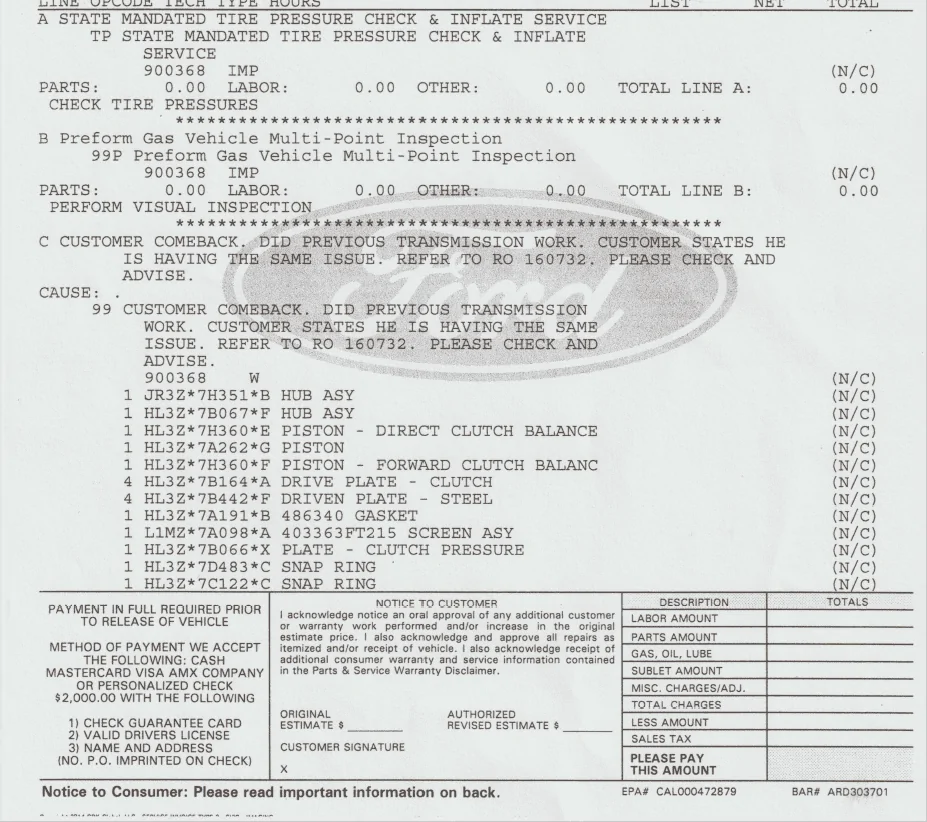

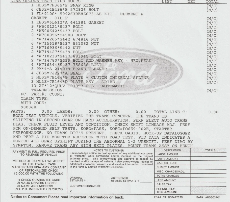

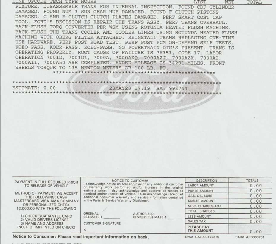

Hello everyone, Happy Friday-
I'll be brief, have a 2019 4x4 XLT SuperCrew w/ ~34K. Regular daily driver, work is about 5 miles a day. No mods really, Ford performance tune and an upgraded Fox suspension.
A few weeks ago started having challenges going from 1st to 2nd, super high whine then "clunk" into 2nd with a jolt. Took it to a local Ford shop, they had it for 2 weeks, said fixed, went down to pick it up, 30 seconds after leaving did same thing, obviously hadnt been road tested and was not fixed. Turned around, said a prayer to the good Lord to help me not lose my sh*t on them, they kept it for another 3 weeks, just got it back (luckily all warranty work).
Apparently new repairs made, I believe all they did last time was take some valves apart and clean them, this time around they actually got new parts and replaced them. Something about a new TSB blah blah blah.
Anyway, I'm attaching the work order if anyone wants to check out what they did (sans my contact and truck info at the top). Key phrase on 3rd page "Root cause of failure is 7H350, Code 17", lots of 'found this damage, found that damage, found this damage' on 2nd page. Don't know if it will help anyone, but here ya' go.

very interesting! thank you for sharing. I wonder why they could not find all the stuff to repair the first time. esp as you didnt even really leave the lot just u turned back to them. i think that confirms my theory that ford has laid down the law that all 5g trans problems get a relearn flash first and sent back out..

There's a lot of pretty big hard parts in that list, something came apart in there and chewed some things up.
Odd that there's an engine oil filter in that list and no oil. Weird that they would change it in the first place.
My guess would be for accessibility, for removal, and just replaced it vs reinstall old, however no mention of oil being added that was lost in removal. (Hmmm)
being that they documented everything (brake Cleaner), might be worth a double check on oil level to be safe - (Good Catch)

a real competent mechanic would have set the eng oil filter on top of the filler neck to drain back in while he did all the other work.

I like the cost cap part..... Ford deciding if fixing or replacing is cheaper.
Of course they have a tool for that?

It all started with a BANG into second gear...sadly, I know how this story will end...get extended warranty while you can or start saving...

Had it back for about a week now. Operating smoothly. Hope it lasts.
I have to say after not having it for 3 weeks while driving the loaner they gave me (a Ford EcoSport), I really missed not having my tune. That EcoSport was definitely the little engine that couldn't...
