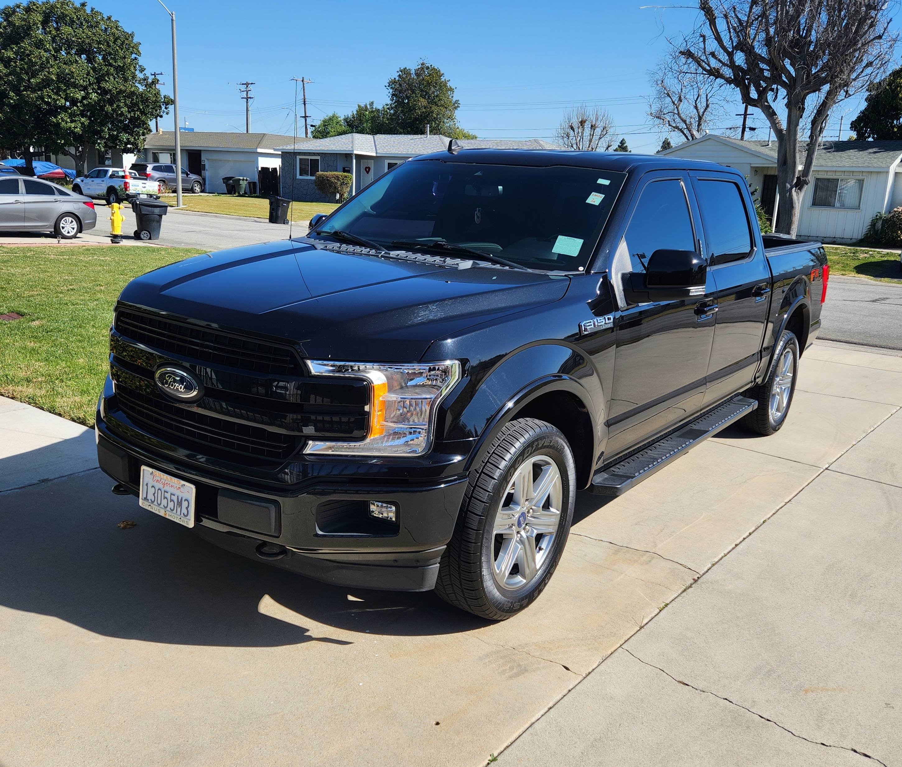

Dropped off the truck. The transmission guy was telling the service advisor YES of course it's warranty covered, it has codes! When I showed him my paperwork and powertrain malfunction alerts. Advisor always trying to get you to pay.
Here's the loaner. 2019 Lariat
