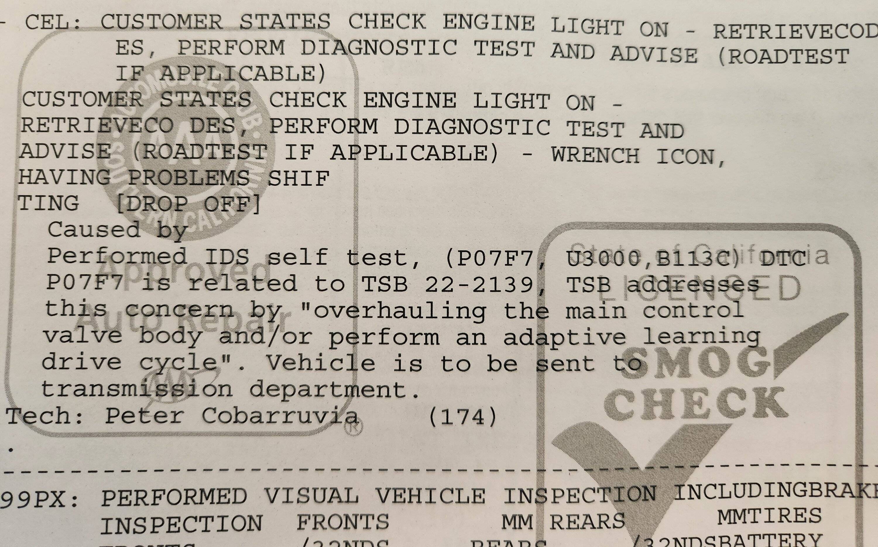

I forgot to mention, I took it to a ford dealer in long Beach ca, because it was closer. The guy there gave me the run around for 2 months till finally said they were so overwhelmed with transmission issues, it would be best to try the dealership I bought the Ranger from Ontario Ca. So I did and have the appointment Monday.
Anyway, here's the paperwork with codes.

FYI, that first link is for the 10R140, not the 10R80..... And that one in particular appears to have nothing to do with the transmission and just a sensor problem.
Fyi, the 10r80 and 10r140 share some electronic components, so even though a different transmission, the fix between them could be the same.

Did they fix it?

No, they said they were so overwhelmed with transmission issues that it would be better to take it to the original dealer. He said to give him a call if they can't either but that I would have to drop it off for possibly 2 months before they look at it.
Avoid Caruso Ford in Signal Hill Long Beach.

Wondering if they’ll change the valve body and do the reset. I’ve read through the tsb and performing only an adaptive reset is the easy way out. If that doesn’t fix it I’m guessing they need to perform the whole tsb. How did your transmission shift prior to this issue? I’ve got 5500 on mine and it shifts really bad in sport or tow mode. Normal mode is better but I get a ton of lugging around 1100 rpm since I’m in way to high a gear. I get really rough downshifts in normal mode after driving in tow or sport for a bit. Weirdest thing. Having mine looked at early March but I doubt they’ll say much is wrong if no codes are thrown.
Yeah they should. It's still under warranty plus extended warranty with wrench light and check engine light on.
