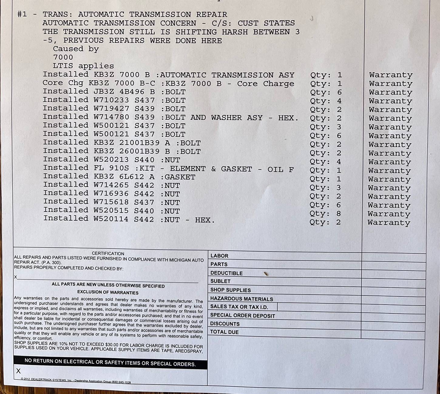

Yes, the part number for the new transmission on a 4x4 Ranger is
KB3Z-7000-B. The reman is part number KB3Z-7000-BRM. All of the people posting copies of their warranty paperwork are showing the KB3Z-7000-B including my truck. Both part numbers are legit Ford numbers. Attaching pics of my repair order and tag on my new transmission for reference. Note there are core charges for both new and reman.

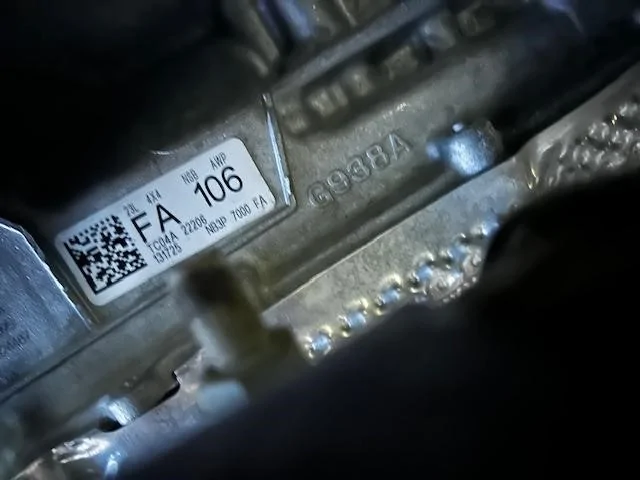

Well, the Tag on the Transmission is the only way to tell for sure and that is the (Engineering Part #)
The Repair Order P/N = The Service Part # - (-B) indicates 4WD and (-A) indicates 2WD
If the Engineering Breakdown follows the Service Part # (protocol)
This is the breakdown
KB3P:
K=2019
B3 =Ranger
P = Transmission / Axle (Engineering Division-Who is responsible)
7000 = Base P/N
-UD Last 2 (Letters) = Revision Level of that part number
This is the point where we need Ford Parts Help in deciphering as here is my Aug 16, 2022, build date:
Transmission Part Number:
Note: This is day 1 of the TSB - Cutoff date for the CDF Drum replacement (Vehicles built after Aug 15, 2022)
So (N) = 2022
with a revision level of (FA)
So, I am assuming I have the revised CDF Drum installed, not verified though as I can only base my assumption on the TSB cutoff data and the parts data tag of (N) vs (K)
I can at least verify that the transmission was originally produced in 2022 vs 2019.
I think the details of the Revision Level (what's included in that revision is the most important information)
Now normally the revision levels start at B (this would equal revision #2)
When they reach Z they extend to a 2-Letter revision - so AA - would equal revision #27 and AB would equal revision #28 etc.,.
But for some reason, I do not think they are following that type of revision code reasoning.
As Rev FA or UD would be way too many revision levels.
So, we are missing a vital piece of part breakdown (revision level) data (explanation)
Phil - Are you Free? to explain
KB3P:
K=2019
B3 =Ranger
7000 = Base P/N
So (N) = 2022

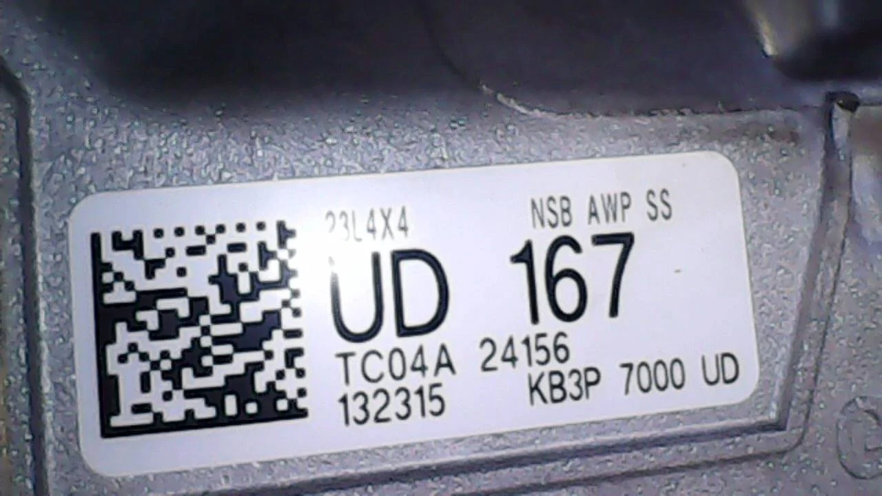

I’m also curious about the 22206 number and wondering if that is the transmission production date ( June 20 2022)? On my new transmission it’s 24156 ( June 15 2024?). The six digit number could be a serial number? Also on my tag there is the extra “ss” next to the “awp” . The 24156 and 132315 also show up on the sol strategy/sol body id tag which is on the opposite side of the transmission. It would be nice to have an explanation of all the data on the tags.

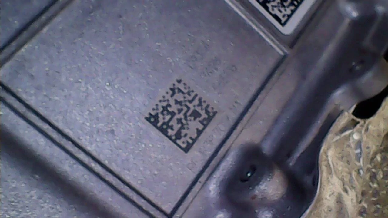

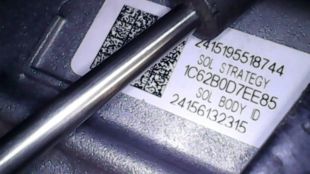

Here’s some more data off my transmission. This area is just towards the rear of the transmission on the passenger side next to the id tag . Image is kind of hard to read but here is what I got when I scanned the bar code
G938A24128565108RFJR3P 7006 NA
