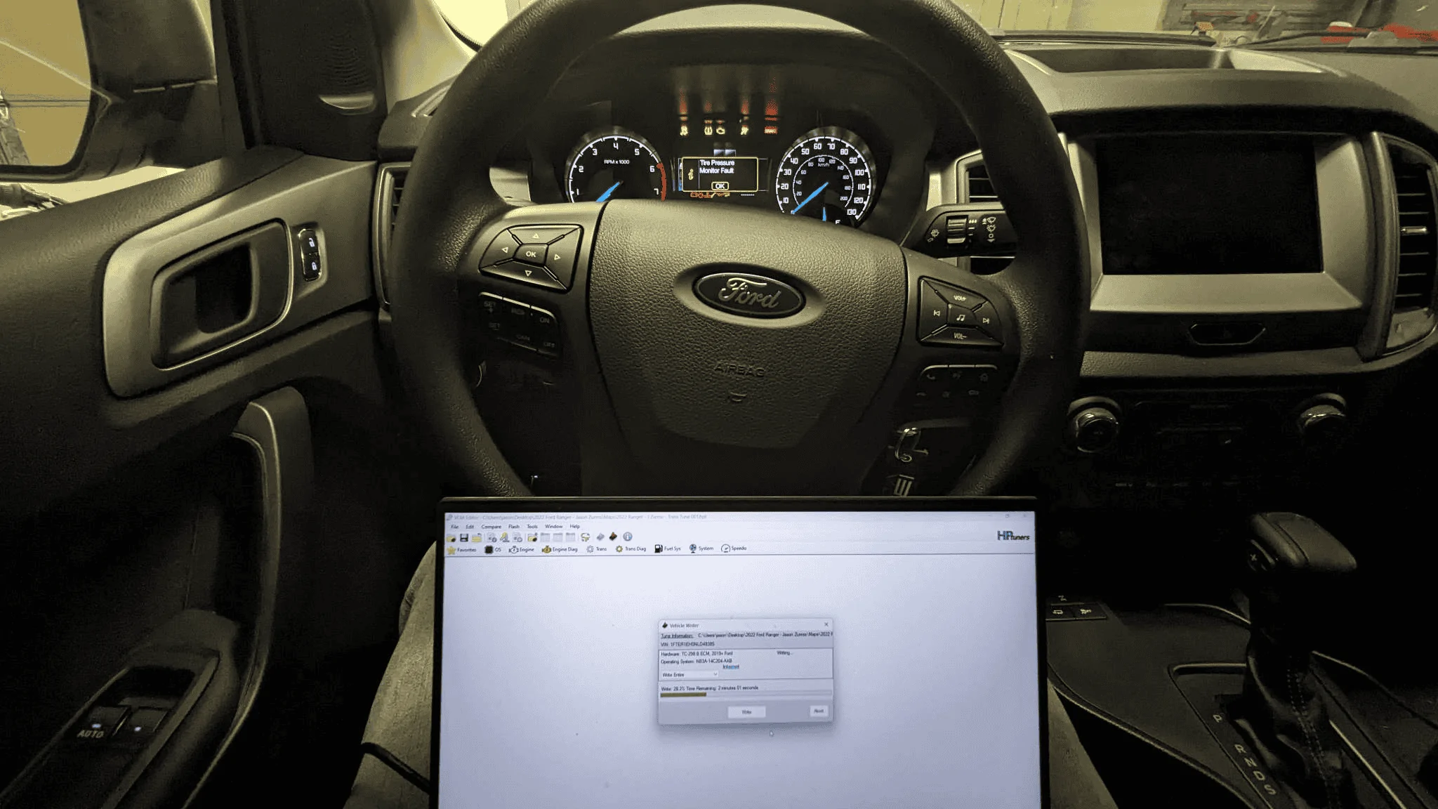

Yeah transmission is finicky. If I’m going up a hill in normal and just keeping it around 20 I can come close to getting it to stall because it’s in 7th gear. Gets annoying because sometime I like to zone out a bit and just cruise and this transmission lets me know when I’m doing that. That and the feeling of all road imperfections (maybe suspension or tires, fully stock truck) are my only two gripes. Other than those the truck acts and performs like a truck I can actually get stuff done with. Truck really wants you to accelerate until fully up to speed.
This is the first thing I fixed on my truck, once I got the first 1,000 mile assessment out of the way. I made a new map for fixing this with the transmission in Drive mode. I wanted something between Sport and Drive, without all the engine braking of tow mode. My truck is much more enjoyable to drive now.
That sounds like it would be perfect. I have no idea how to do this but I probably would if I had the ability. Just unhooked the battery tonight to reset the adaptive learning so I’ll see how it goes.
