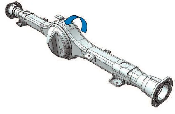

Loosening the center bearing is worth a try...it may not prove effective in eliminating the shudder, but might minimize or reduce it.
One thing that I did not cover with startup shudder is the effect of acceleration that causes the rear axle pinion to rotate upwards, which can induce this shudder as the U Joint angle is changed under acceleration The pinion angle is usually slightly rotated downward a slight amount to compensate for this pinion rotation. A simple way to determine this is to gently accelerate from a standing stop to maybe 25mph. The repeat with a very hard aggressive acceleration and see if the shudder is much worse. If much worse shudder, then your vehicle is sensitive to pinion angle change. There are tapered shims made to change pinion angle, and slight changes in pinion angle can produce pretty significant results. I believe the shims come in about ¼° increments but they could be even finer. Not something for the average backyard mechanic, but likely the dealership is familiar with the process. This would likely be covered by a TSB that would indicate for problem vehicles the shim to use to help the startup shudder. Hopefully this makes sense....It is mired in spring wrapup, axle twist, Shock absorber placement, etc.
I hope I have not muddied the waters too much by tossing this into the mix.. This is best left to Ford engineering to address, but for those that are inclined to DYI, it might be a challenge to install a couple shims and see if it helps...

Hi Phil,
Does the pinion angle change enough to make a difference under static spring compression? Someone reported no change in shudder with 400-lb tongue weight while towing.

HI David,
The pinion angle would likely not change due to load much if at all...However, under torque it will change, I just do not know by how much as this has to be assessed by Truck Engineering and I was long retired when 5G hit the ground....Someone in Dearborn probably knows the whole story on the pinion angle...But maybe this is down under done by the Aussies???
