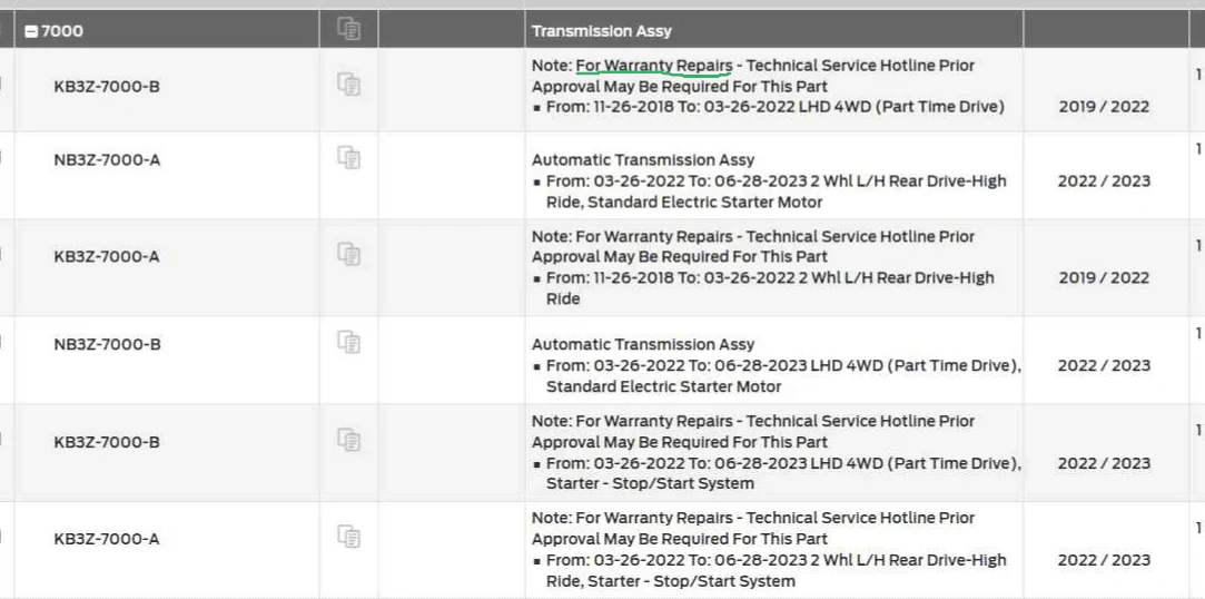

I just had a brand new transmission installed in my 2022 with 17800 miles on it this week. I was told it was new and questioned it and was reassured it wasn’t a reman. If it was a reman you would think it would be tagged as so. Others on here have purchased the new transmission out of warranty with the same part number. Maybe @LevittownFordParts.com can confirm for us?
Hi Steve,
I'm not saying its reman but based on the part # off the Repair Order its a warranty spec unit, See below
Ford is odd in that many parts have a warranty spec version, Even brake parts (rotors, calipers).
If a customer asks me for a part we always provide them with the retail spec version. Internally I honestly do not know what the differences may be.
- Benny

Hi Steve,
- Benny
Thank you
