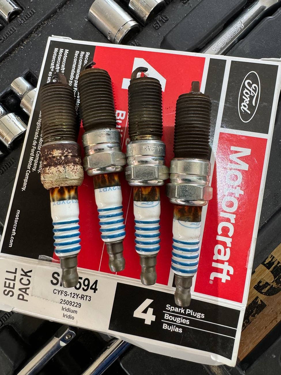

I was going to say - the manual says to replace at 100k - I did mine about 40k and they were already looking a bit tired. I can only imagine what 100k plugs would look like.
This is what 105,000 mile plugs look like. The very back one, #4 I guess, is the one with the rust around it.
I'm glad you were able to get #4 out without too much trouble - those do look very tired.
Need to show the electrodes, can only see the one, I’m sure the rest are similar. That’s a mighty big gap! I’m at 65k maybe I should take a look
