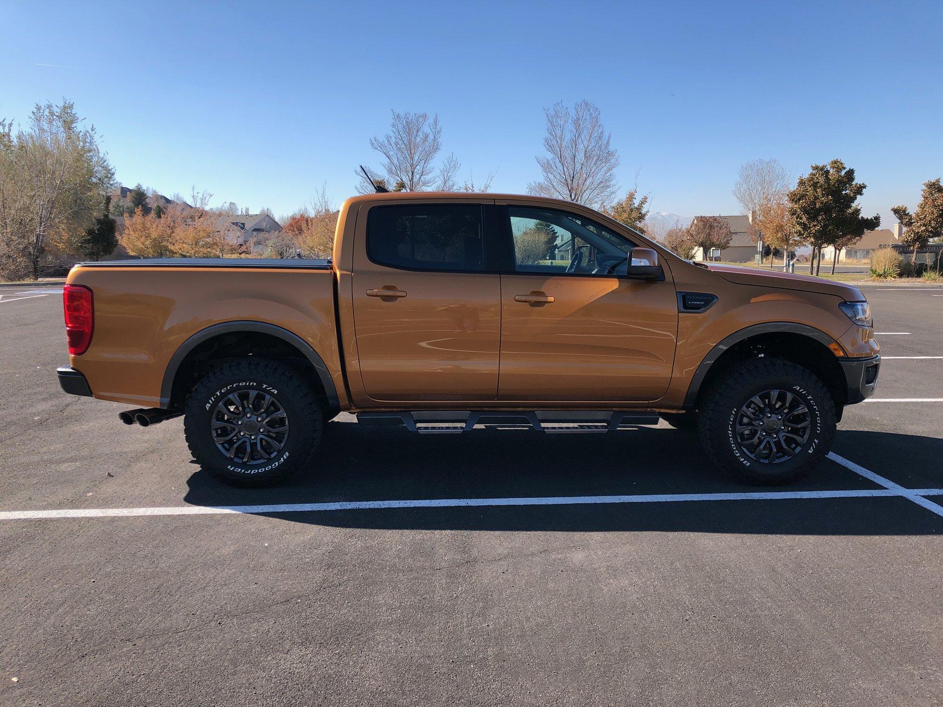

I have LT-275/70R17 BFG KO2's mounted on the Stock Sport Wheels with the Ready Lift 3" Level Kit. I have had no rubbing issues at all, therefore no further modification was necessary.
I am digging the way these tires look with the sport rims. I have the Fox leveling kit and will probably go this route. Thanks for the pic!
You won’t be disappointed! Not only do they look great, they perform great in ALL conditions! Enjoy! :thumbsup:
