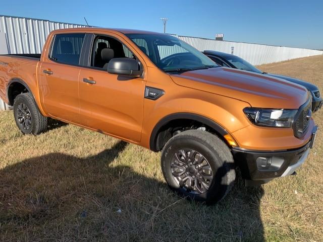

Not the best picture and its dirty but there they are 275/70/17 BFGs. On my 2WD with 3" Level from RangerLift. No spacers, no rubbing, no cutting and crash bars intact.
Yup, great fit and looks excellent! You’ll love the tires! Happy New Year!
