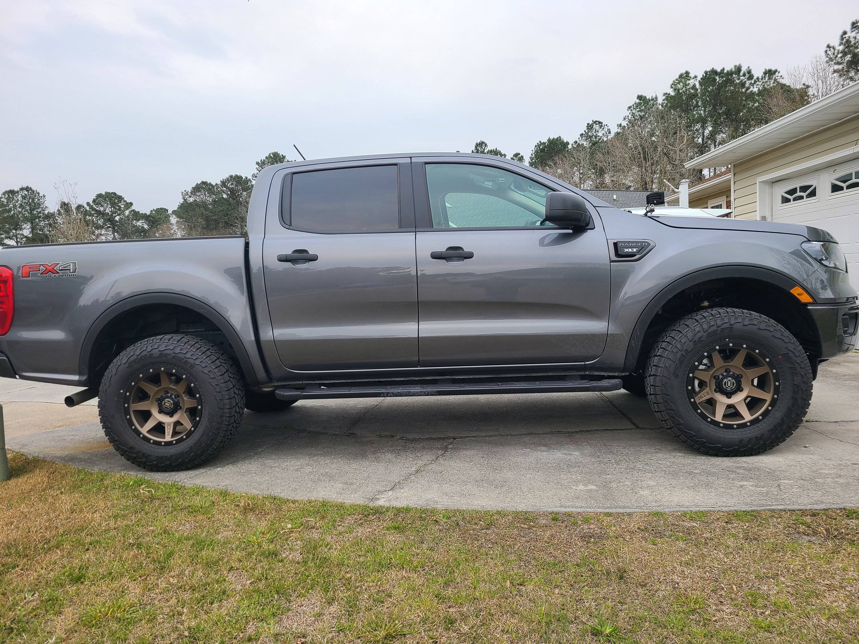

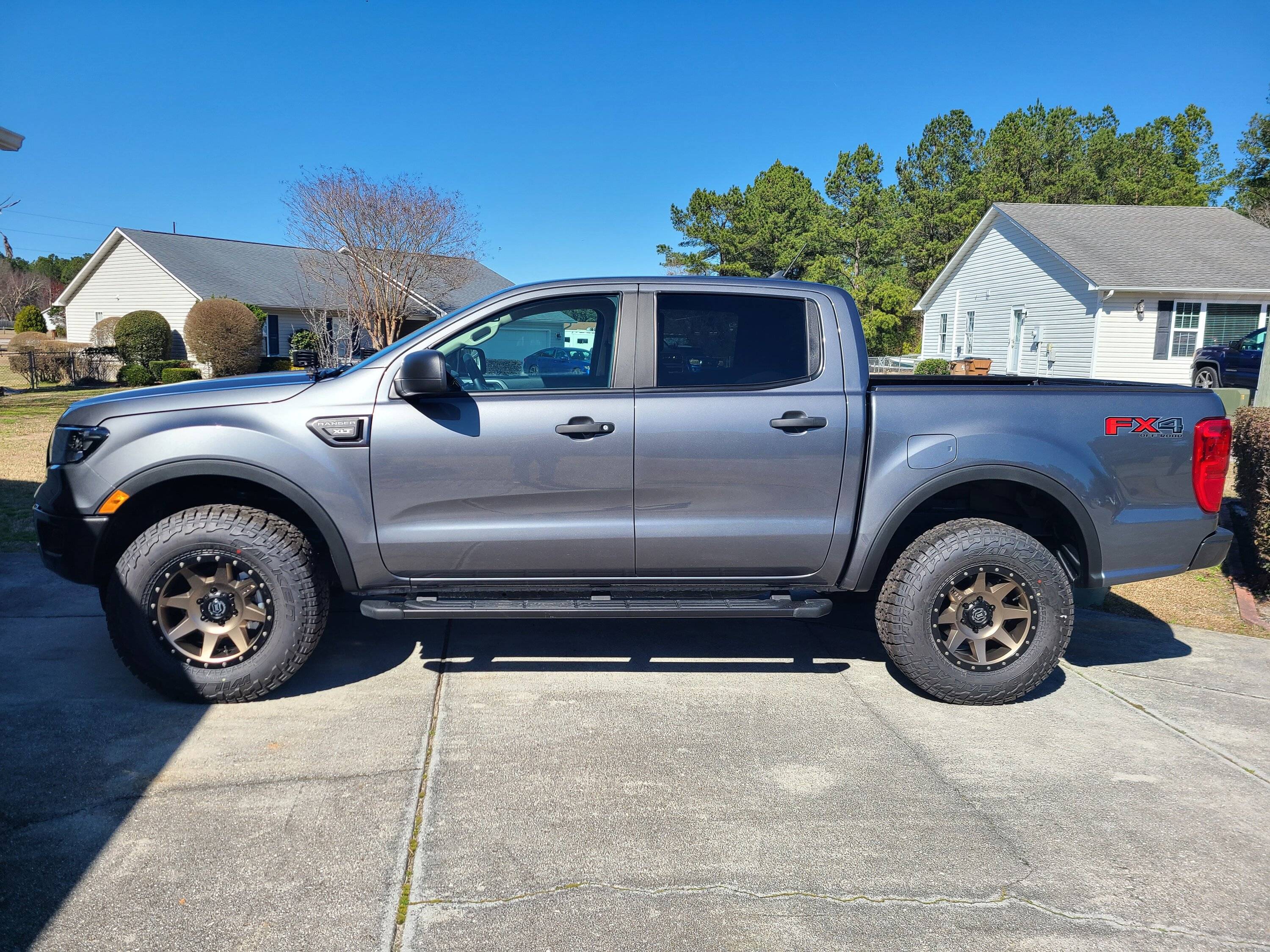

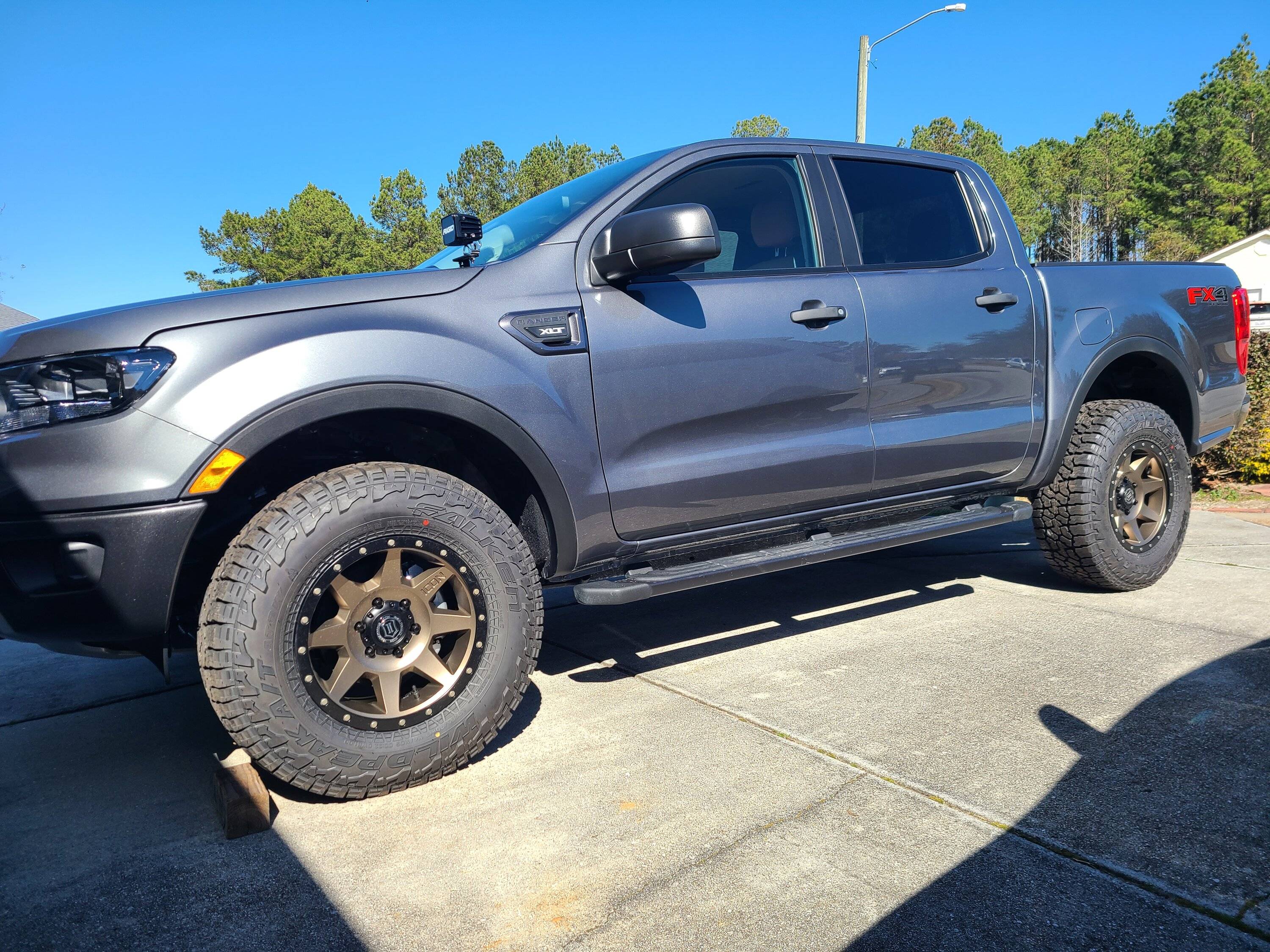

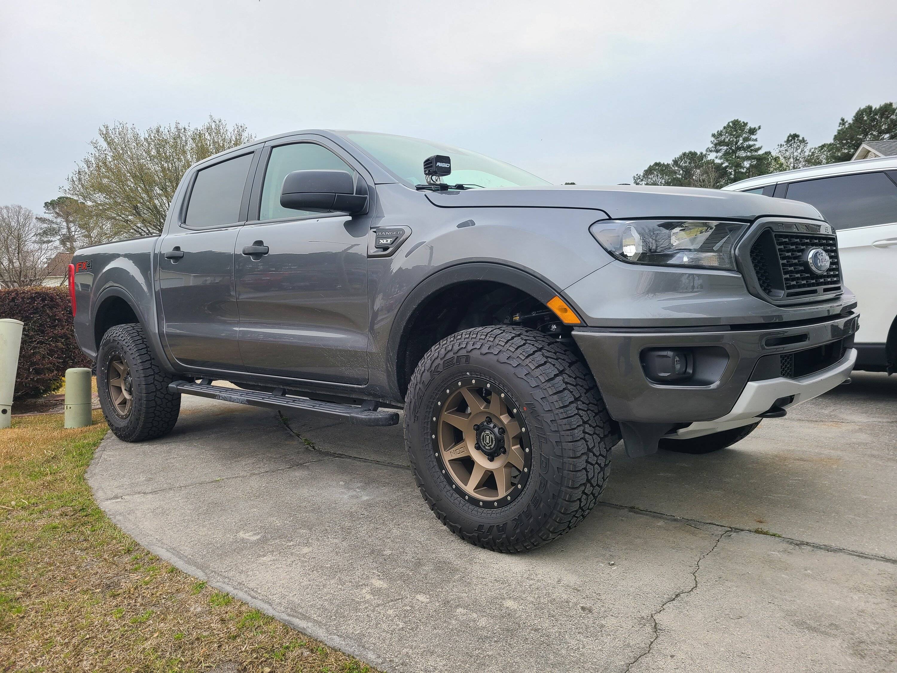

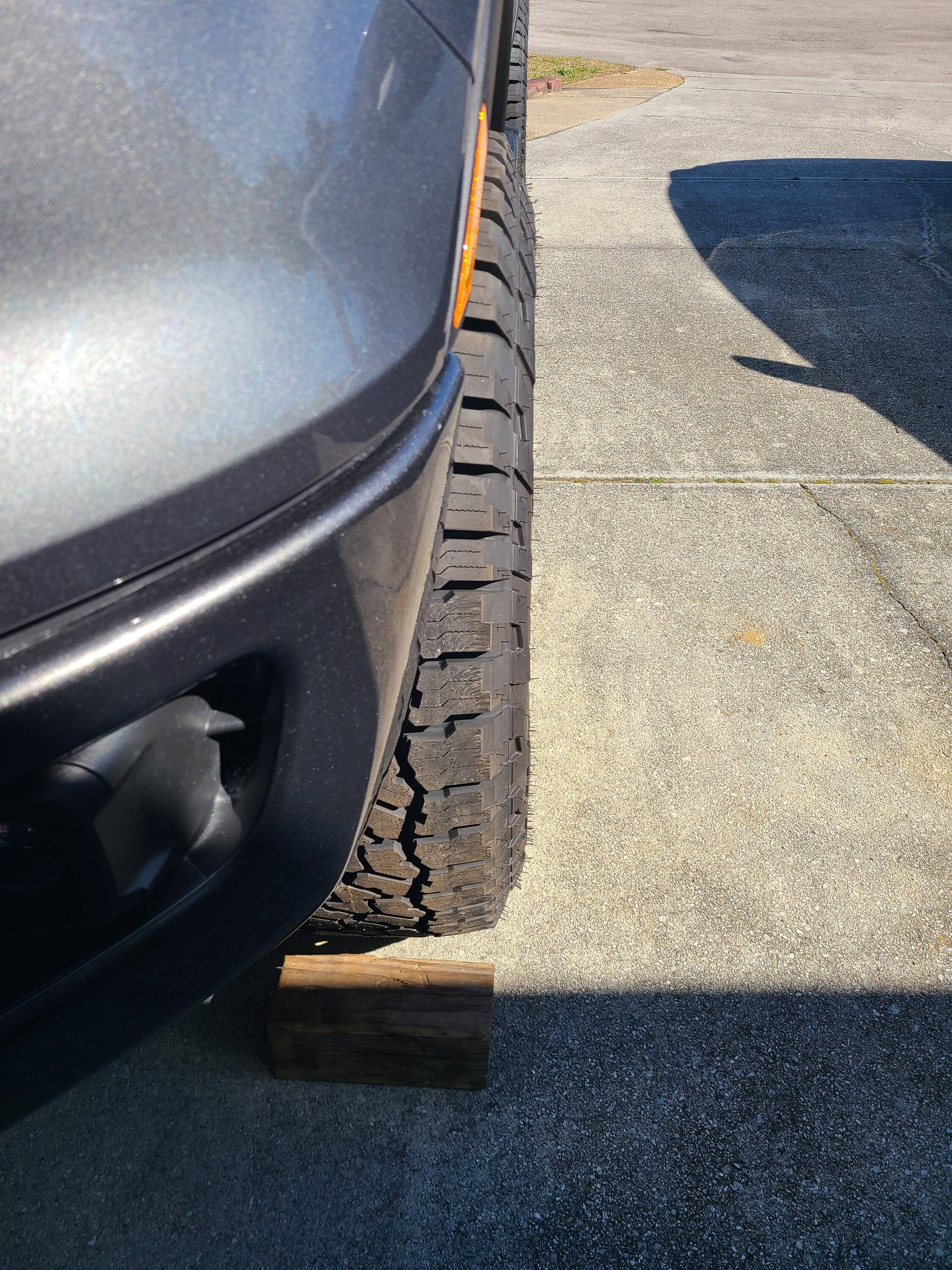

I just wanted to step in and say thanks for this. I'm considering the exact same tire brand and size, but using the stock FX4 17 inch wheels on my Ranger.. So seeing this work is really helpful. Any pictures with the FOX suspension set up? I'm assuming you don't have any rubbing issues and/or had to mess with the crash bars, right?
The pics are with the Fox 2.0 suspension level. Love the ride on the road and off road (heavy rutted forest roads) I also installed the Icon UCA which helped the alignment.
This setup gave me a positive scrub angle of about 23mm which isn't really a bad thing.
I DID NOT get the 2" of lift advertised, only got a fat 1.5". To get that 1/2" I will have to pull the coil overs and move the ring. Fox tech said that it is a 2:1 ratio so move the ring 1/4" will get 1/2" offers lift. The tech said that moving the collar more than 1/2" was a no go and that if I wanted more I would need to change springs. The only rubbing I get is full lock in reverse on a piece of the fabric wheel liner that is kind of poking out. I do have the high cleance crash bars installed. The install wasn't really that hard just buy extra blades for Sawzall, 1 per crash bar.

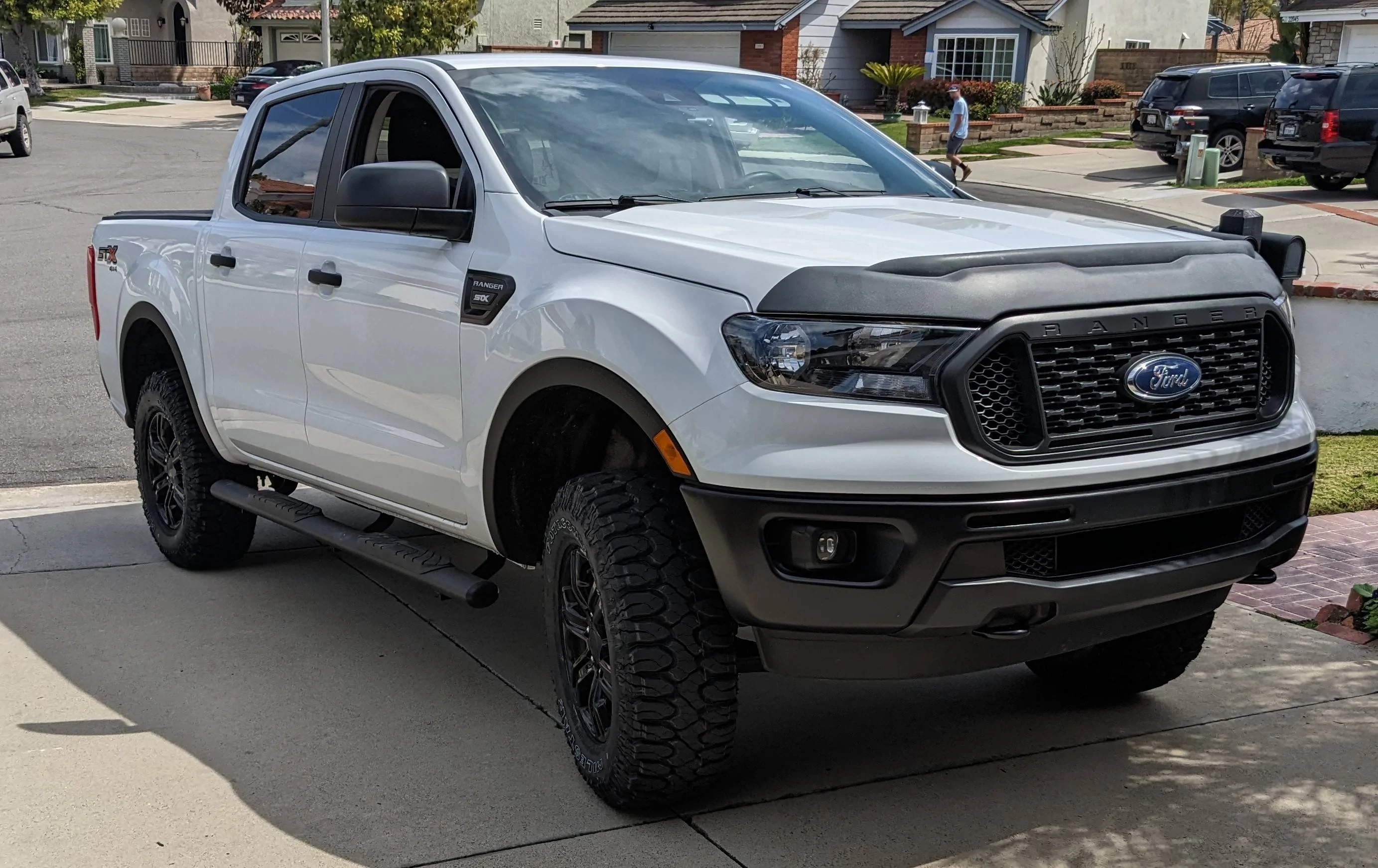

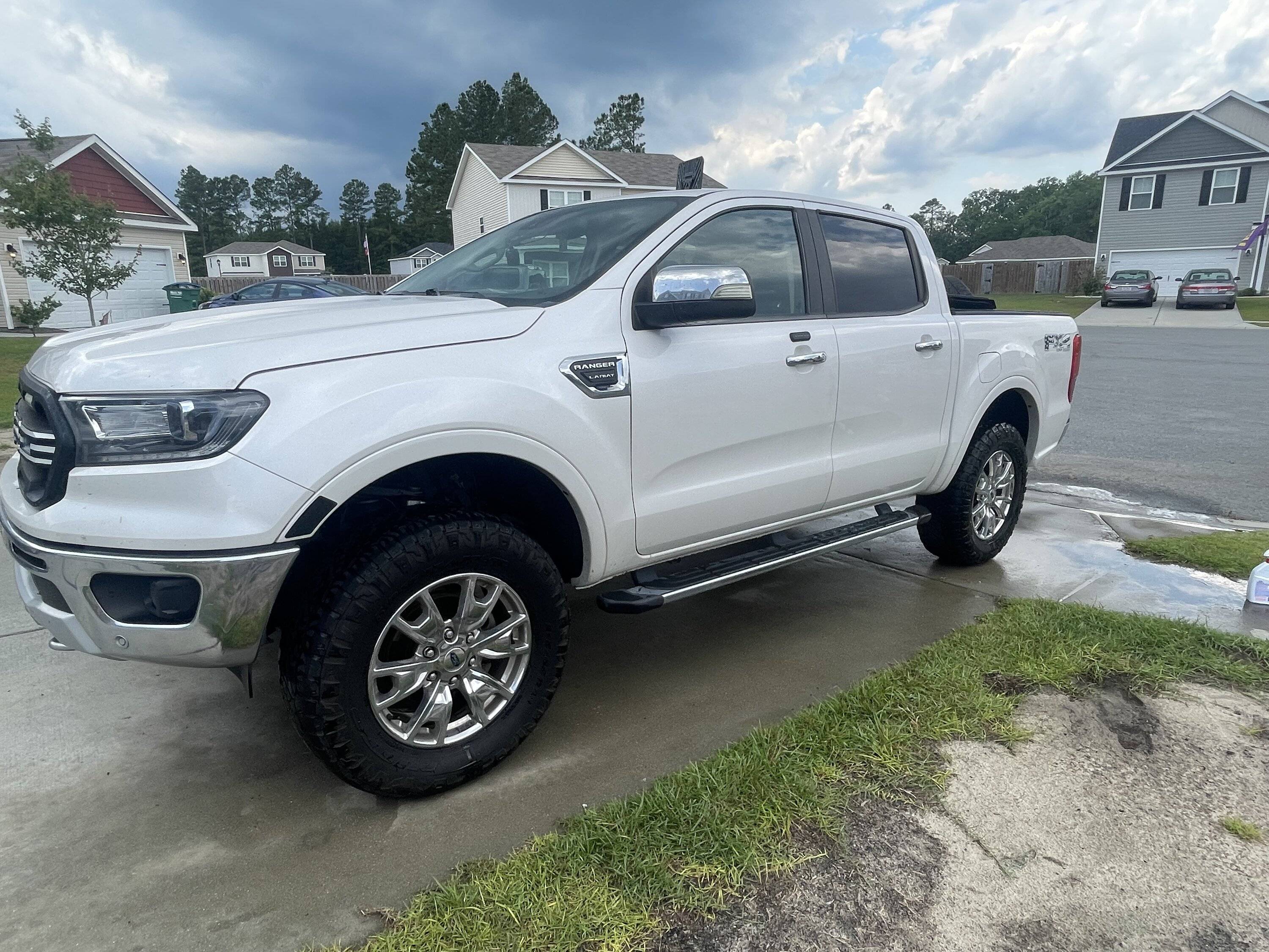

So for those sticking with stock rims...I've got the factory 17" and added 265 70 17 - these so far (just installed a few days ago) ride nice for me. Running Milestar Pantagonia MT's on my stock 17 rims. I also leveled with a 2 1/2" kit. I believe in the coming weeks or so I'll add some spacers onto the truck. Not 100% sure yet...as I may decide to save up for wheels instead...

So for those sticking with stock rims...I've got the factory 17" and added 275 70 17 - these so far (just installed a few days ago) ride nice for me. Running Milestar Pantagonia MT's on my stock 17 rims. I also leveled with a 2 1/2" kit. I believe in the coming weeks or so I'll add some spacers onto the truck. Not 100% sure yet...as I may decide to save up for wheels instead...
Looks great, I may copy this for my Tremor. Out of curiosity, did you need to cut/remove crashbars?
EDIT: Actually, I don't see Patagonia MT available in 275/70r17 size, sure on that size?

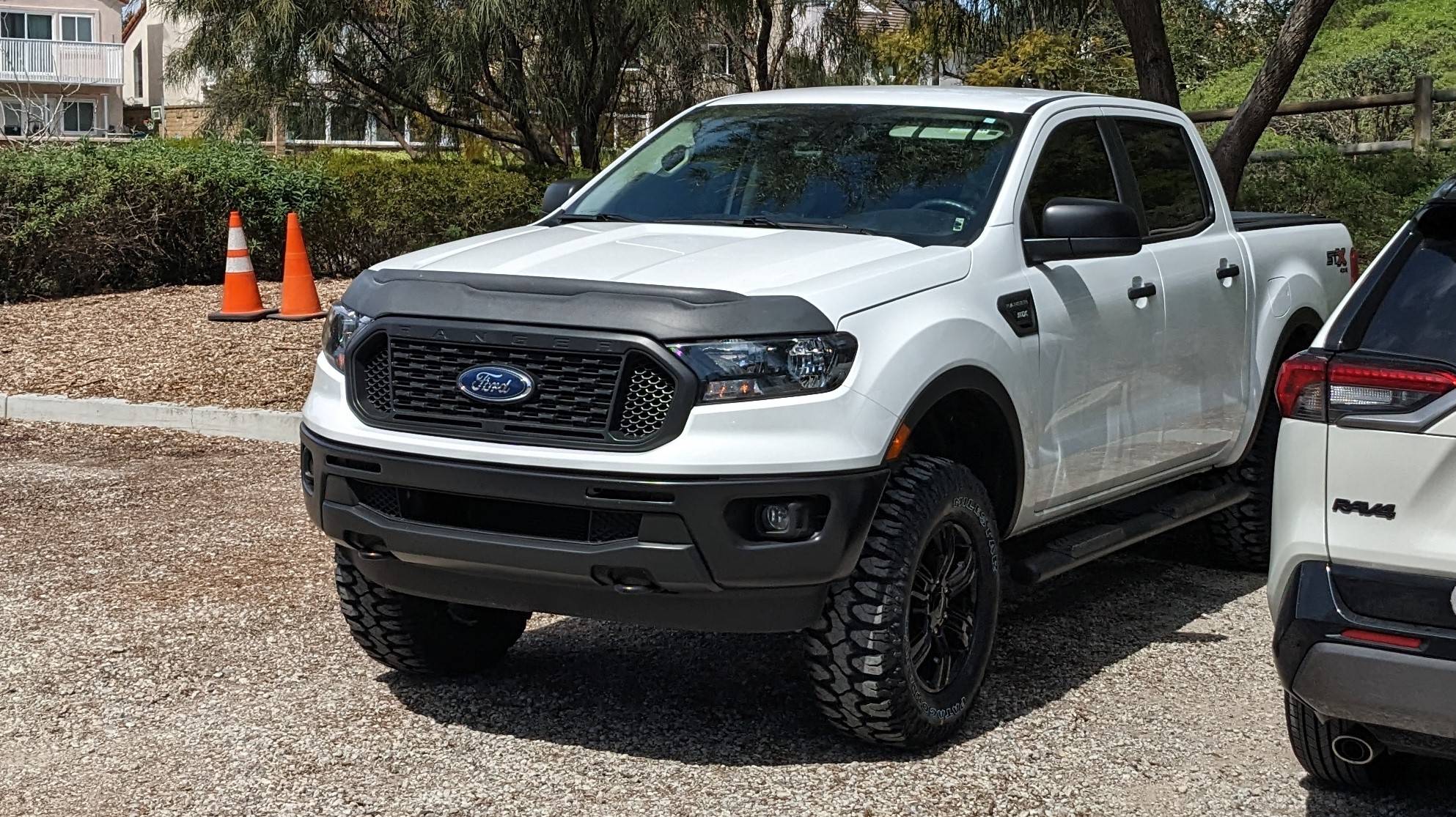

bluemonstr
Mar 3, 2022
SoCal
2022 Ranger 4x4
Analyst
APOLOGIES - that is 265 70 17. My mistake. :( I'll be correcting my original post on this as well.
No, I didn't have to cut/remove the crash bars. I did level the truck 2.5".
I do plan to remove the crash bars though, as I may also get spacers 1.5". IF I do that, then I will cut them out.
