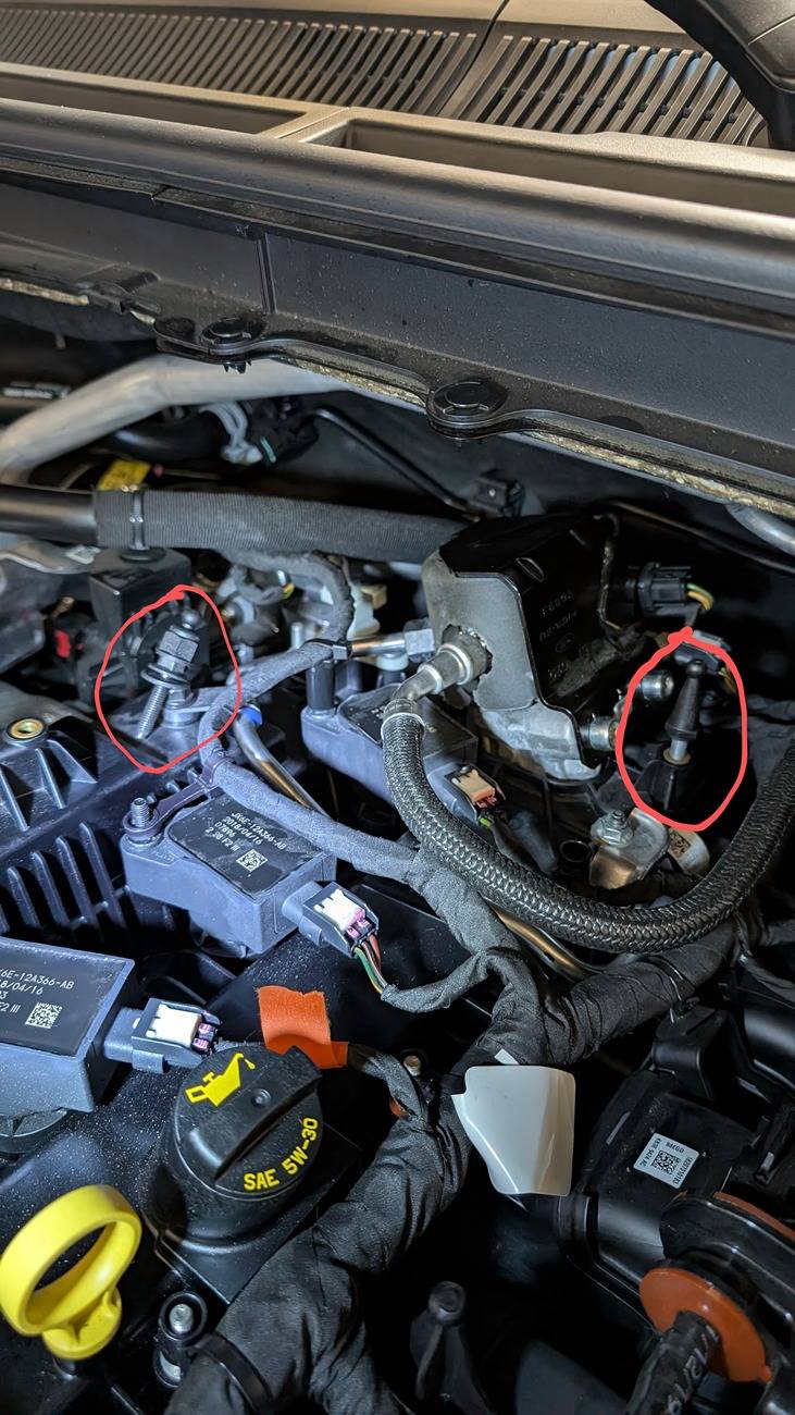

I did just that.

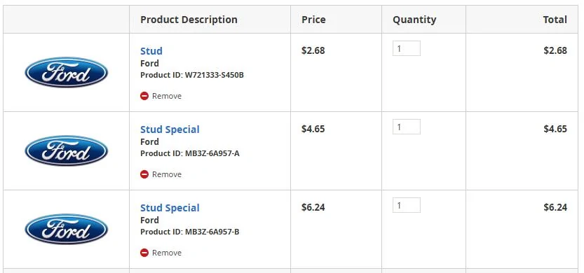

Only the cover arrived because not everything was in stock.
W721333S450B Stud HT2
LB3Z9K540B Insulator
MB3Z6A957A Special stud
MB3Z6A957B Special stud

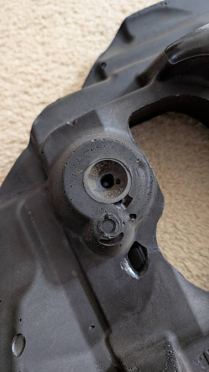

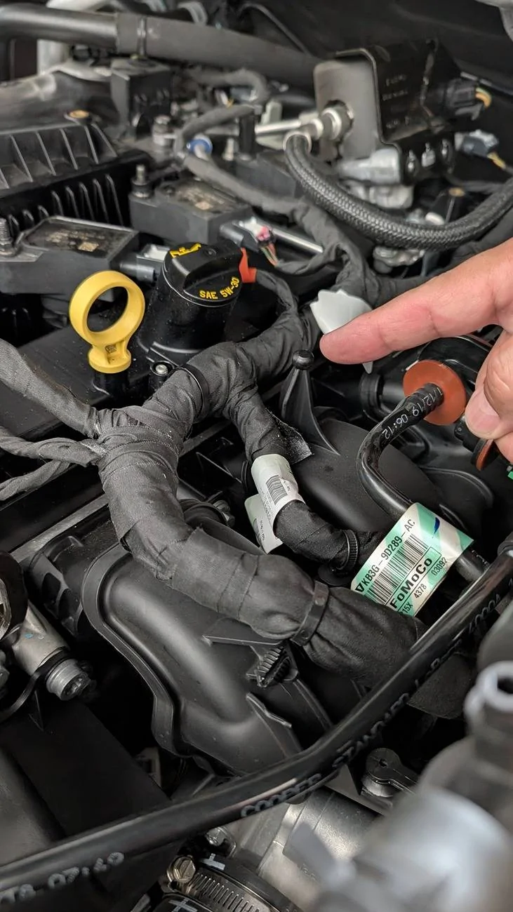

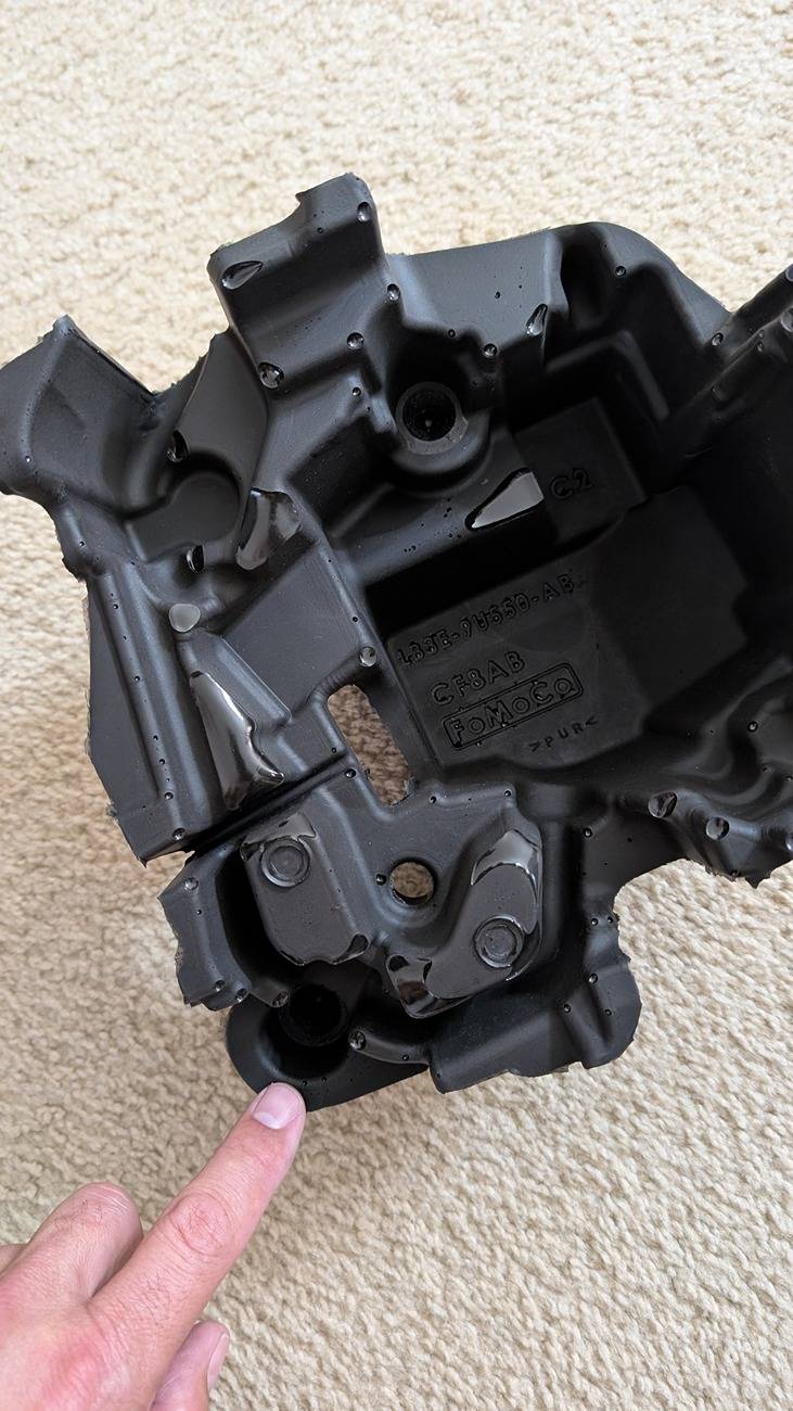

Just so you know, it doesn't use the same type of studs as the engine cover. It uses the type where you push down and it snaps in place.
The engine cover has one. I pointed where it snaps to on the engine. (See pics)
The last picture shows two places on the fuel pump cover where the special stud snaps to. I'm pointing to one.

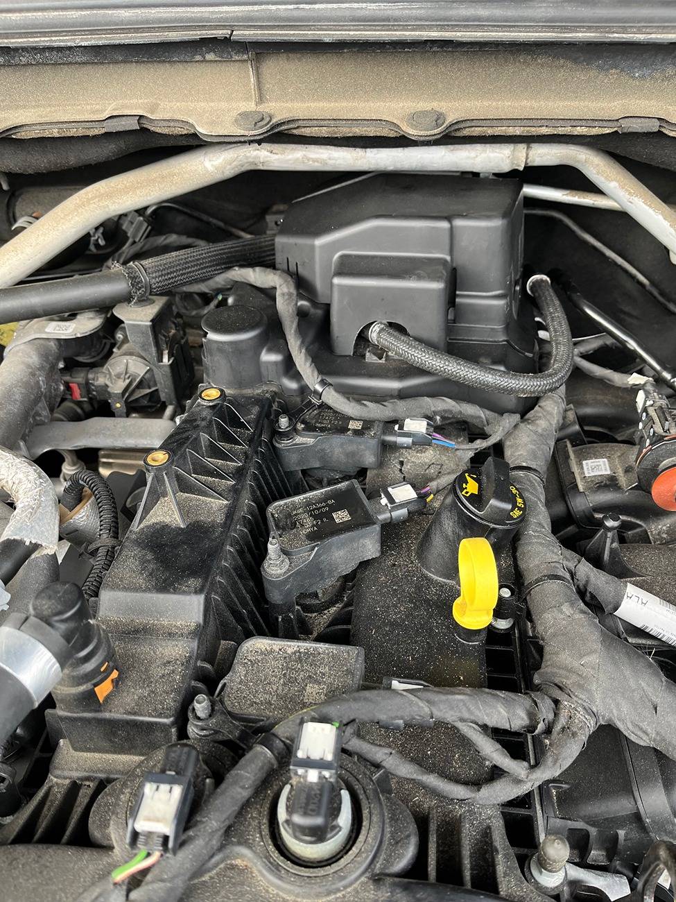

These are the parts. It arrived today. You can see where "stud special" screws on to the "stud."
You have to remove a bolt in order to place the "stud." I circled where it goes.
