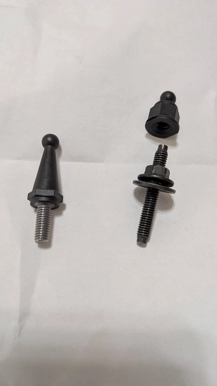

The clamp stud does the cone fit on that stud? or do others need to order the stud with it?
I am thinking that as far as hardware - only 3 pieces are required to be purchased, as the Special Stud (cone) will just screw onto the existing stud. (Correct?)

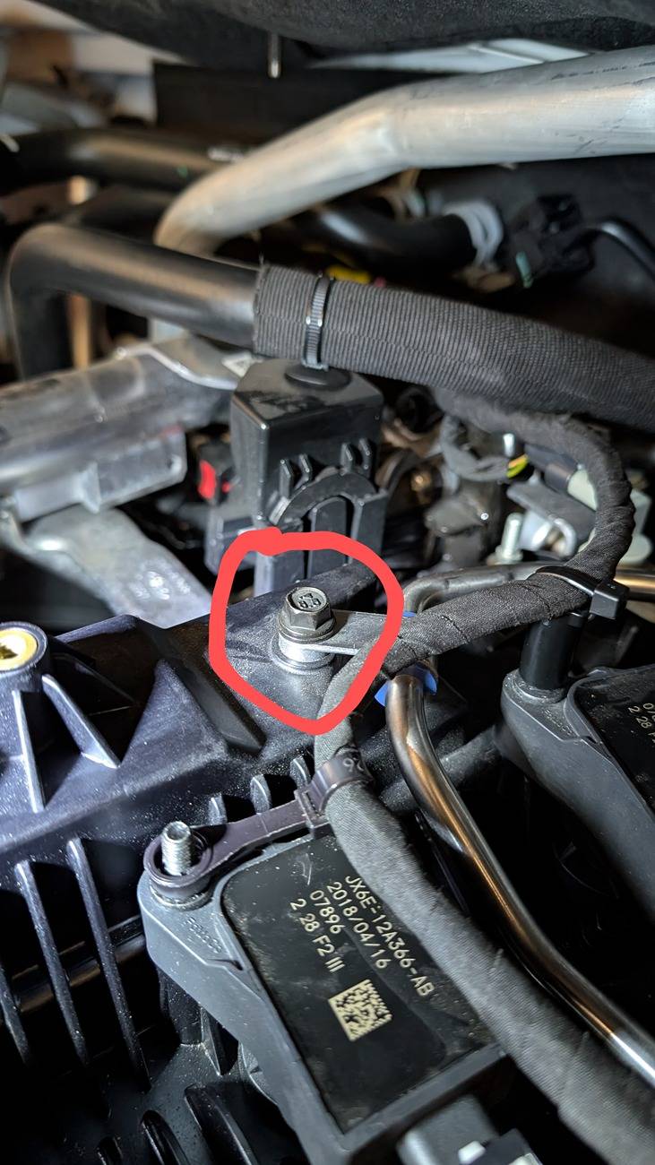

There's a bolt where the stud goes. (Circled) You have to remove it to place the stud.

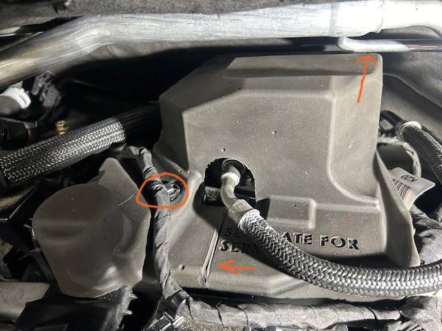

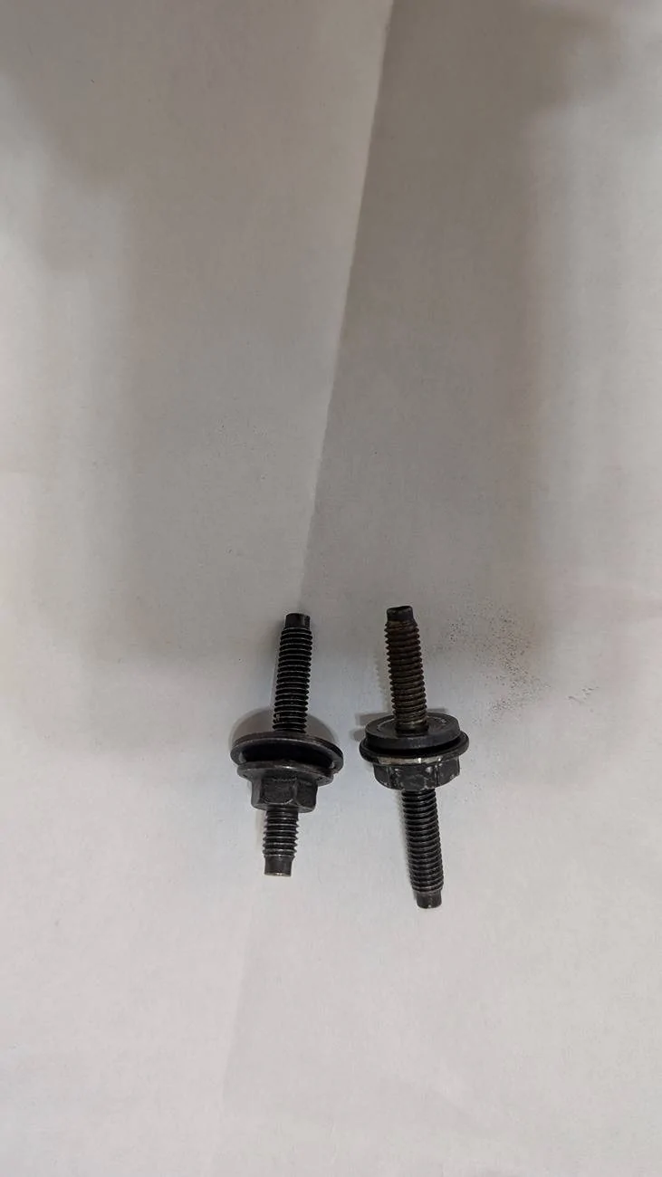

The next picture shows a stud for the engine cover, (right) and the stud for the fuel pump cover. (Left) It's not the same.
4,554
23,156
These are the parts. It arrived today. You can see where "stud special" screws on to the "stud."
You have to remove a bolt in order to place the "stud." I circled where it goes.
Those are great pics! Thank you so much! =)
And, my inner child just can't help it, STUD SPECIAL!

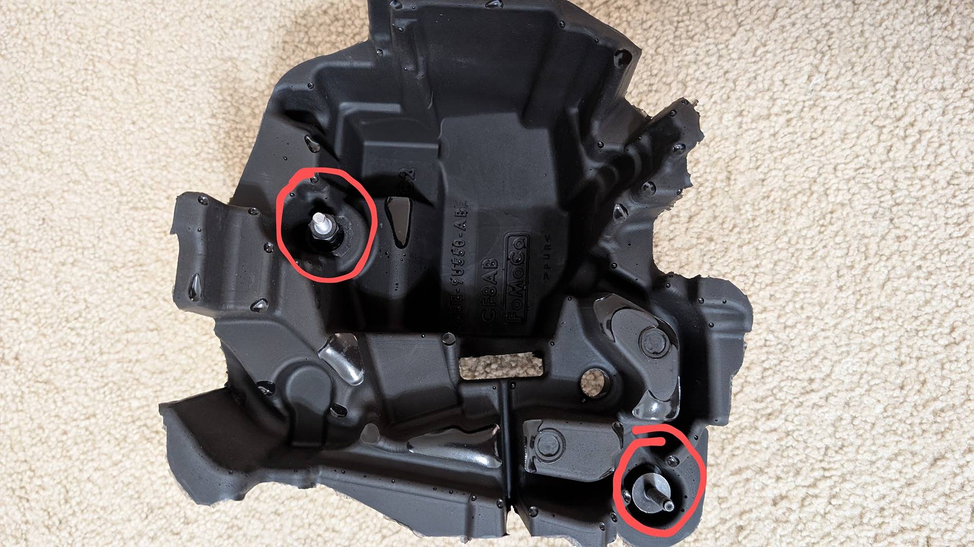

Here's a picture where the parts snaps to.

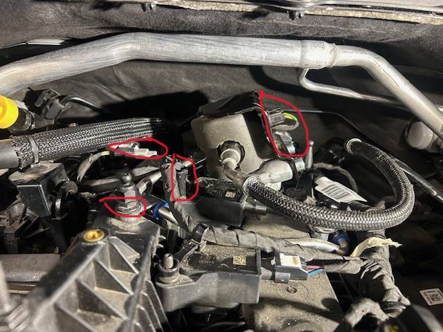

Preinstall Notes:
Mine has a stud, at this location already installed - not a bolt.
So, all I needed to do was add the (Special Stud- Cone) on top of it
The stand-off for the wire harness needs to be pulled off, this actually routes over the top of the cover vs below it, the cover will not drop down with it in the way.
There is actually a hole in the cover to allow rerouting
This cover is already hampering the fuel line disconnect, and adding the cover over this makes it worse.
You MUST have a LOW PROFILE; fuel line disconnect tool to wedge between the fuel line and the pump.
Note: Mine already had the stud (Left), so just added the Special Stud on the top of it.
This harness stand-off needs removed (circled) so it can be rerouted over the top of the cover.
Highlighting 3ea - Electrical Connectors that you need to watch, so you do not damage them with the install of the cover. Be very careful to not hit them with the cover as you install it.
1 ea - To the Left of the pump
2 ea -To the Right of the pump
Forgot to (Circle) it - but you can see the other (Special Stud) I installed to the right of the pump.
