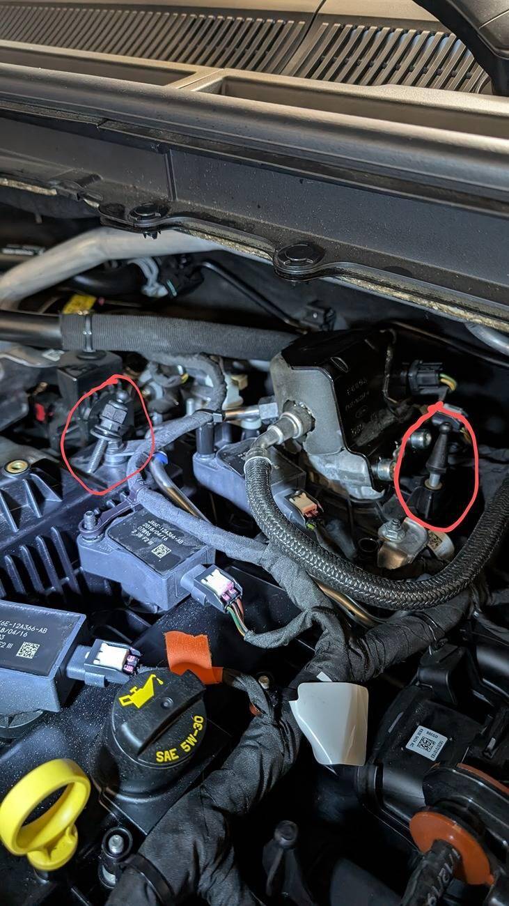

Hardware Clarity:
If you actually want to add the hardware:
I installed the hardware with mine, but it is not truly needed, as the cover fits TIGHTLY, however it may help in getting the cover properly placed (Aligned)
Ref: The pic below
The Left (Stud) OE may be a bolt or stud - mine was a stud, and I only needed the (Short - Special Stud) Cone.
If you have a bolt - like in the pic, then you need the (Stud) to replace the bolt, and then install the (Short-Special Stud) on top of it.
The Right - (Special Stud) Cone - is a 1-piece design, this is not installed (OE) and must be added.
Left Side:
Stud: PN: W72133S450B (Only Required) if you have a bolt installed OE) to swap bolt with the stud
Special Stud: (Short Cone) PN: MB3Z6A957A (Required)
Right Side:
Special Stud: (Long Cone) PN: MB3Z6A957B (Required)
