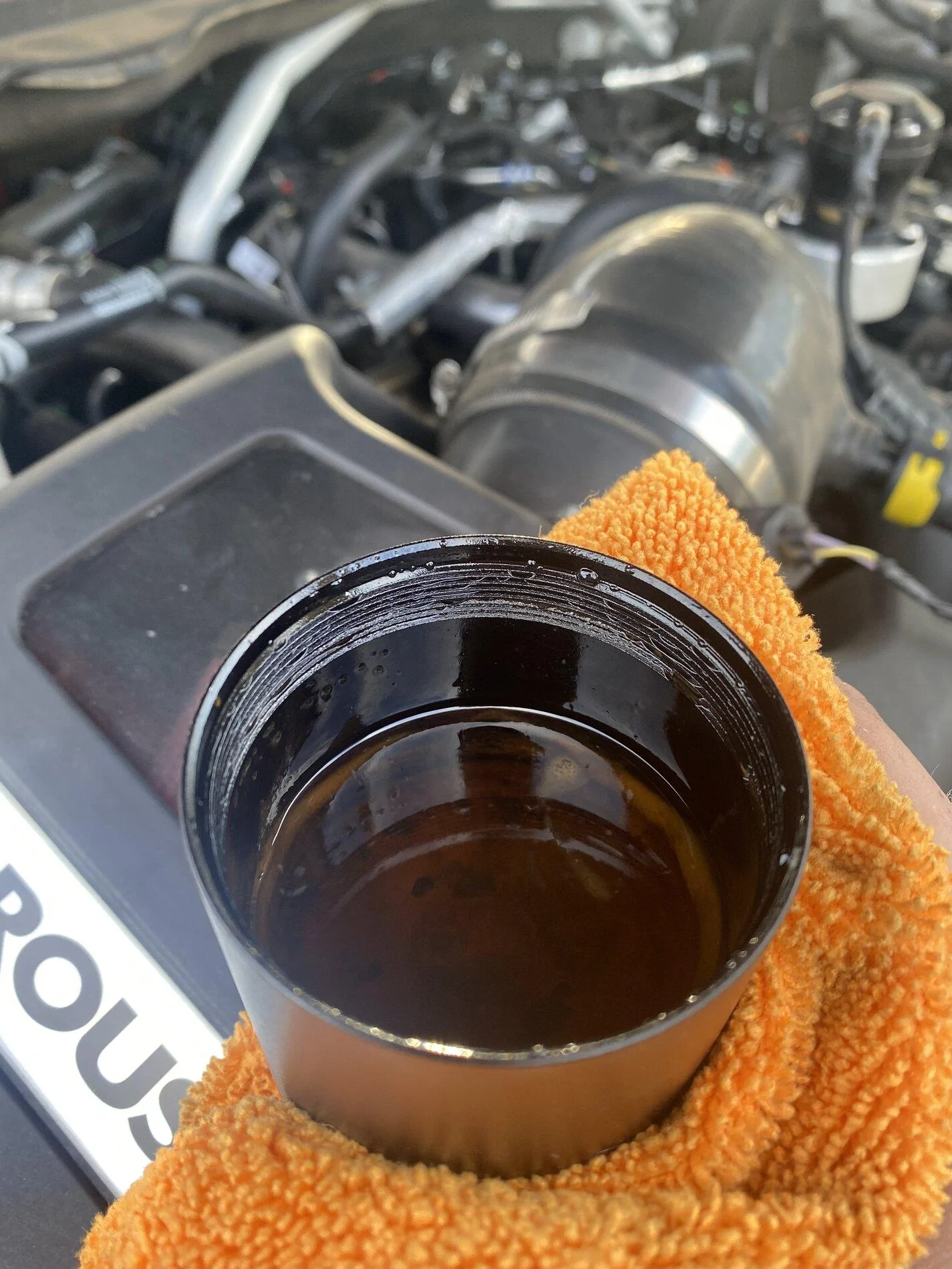

Smells like gasoline for sure

Reminds me of the old glass fuel/oil separator on my old 81’ diesel VW Rabbit...lol

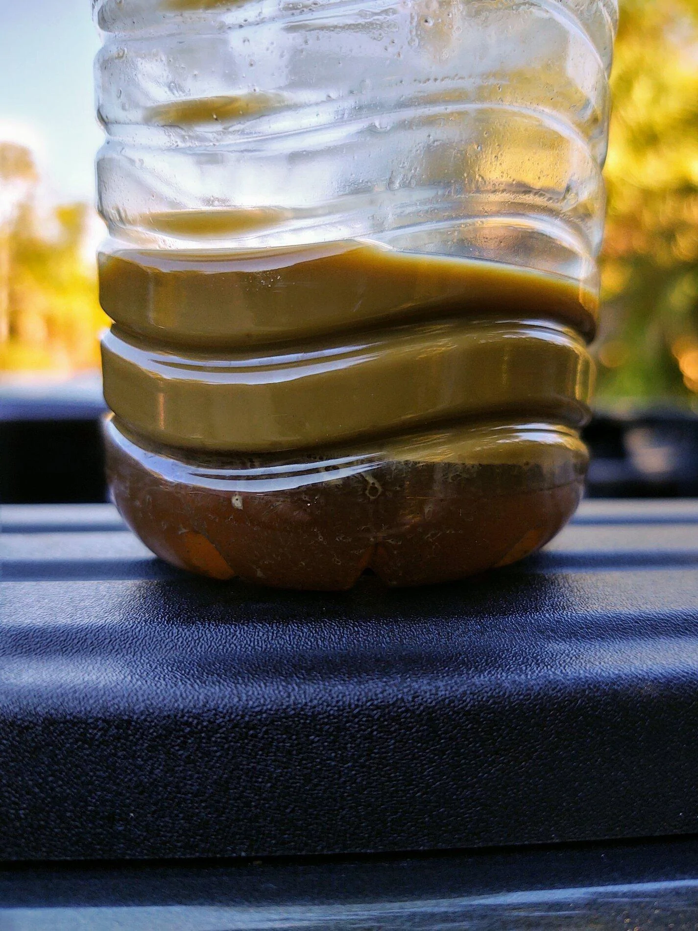

First time I've dumped since the last oil change (2nd one) from around 15K miles, now at a little more than 17K. If snake oil smells like varnish remover, this is what I got after letting it settle for an hour or two:

Pretty arid in Windsor Colorado.... well compared to Florida anyway.
