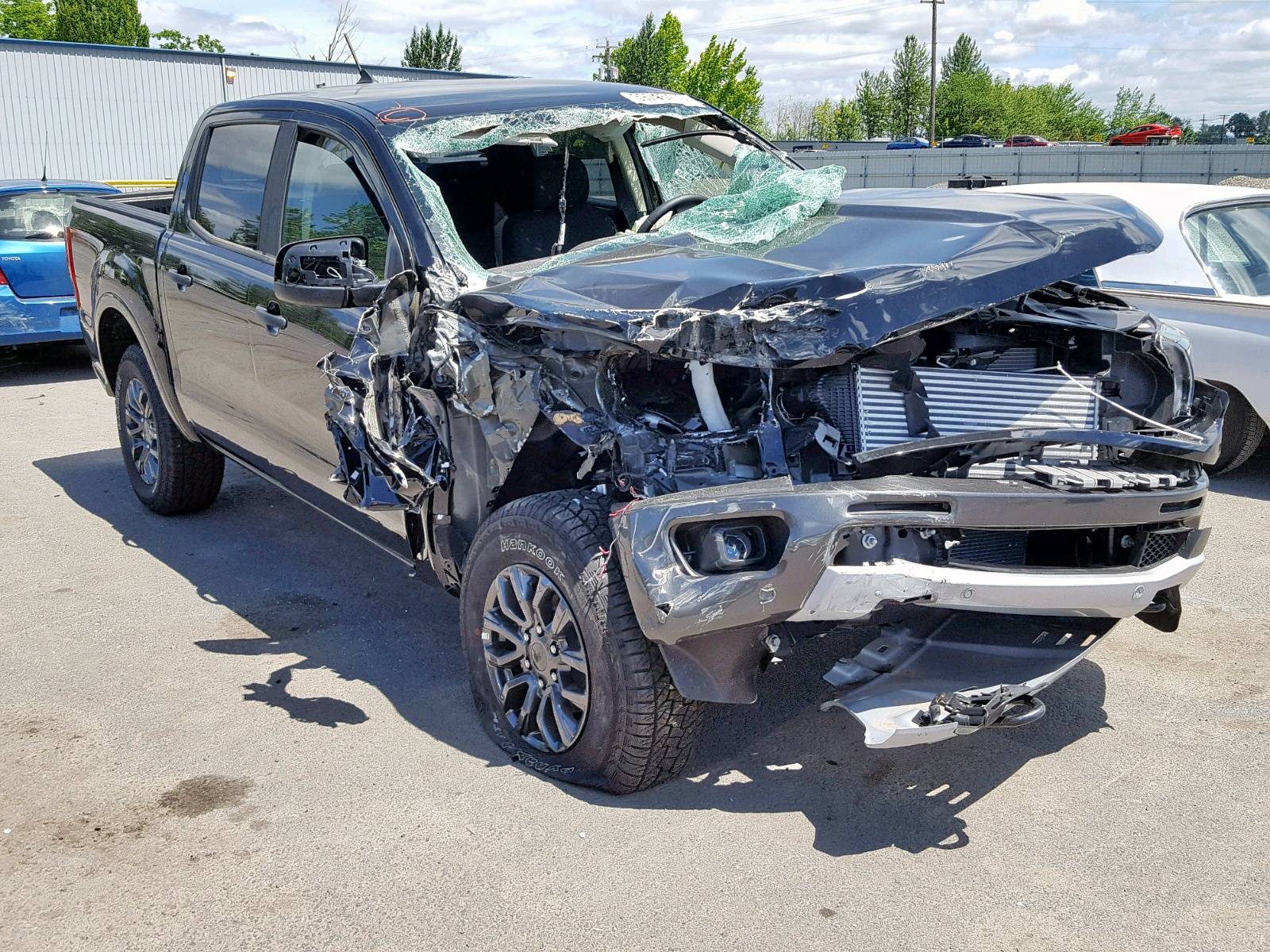

Yeah, my 'catch can' had so much fuel in it the truck exploded! Ford won't warranty it as they stated that Ranger must have been in a war zone and ran over an IED! My insurance company is suing me for fraud - just can't win for some reason.
Holy shit! Hope you’re ok, well after seeing the gas in the cc and now this picture might just have to take it off completely!

best post I can ever recall seeing here, beware of those catch cans ! although my can catches next to nothing I still going to wear my fireproof driving suit.
