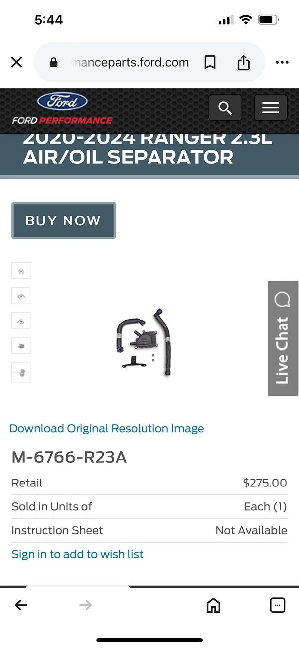

I looked at the above along with two others mentioned here.
My concerns with the Ford product are the capacity and draining process.
What part numbers from Ford Performance?
Just Google Ford performance catch can ranger. It will lead you right to it. Pick the M-6766-R23 link to see the installation pdf.

OP here. I've looked at the three favorites mentioned here and the UPL looks good enough for me.
Easy installation, good access to the can for draining. The 19-23 Ranger 2.3 Ecoboost Single Valve Oil Catch Can Separator Plug N Play™ is also easy on my wallet.
The 19-23 Ranger 2.3 Ecoboost Dual Valve Oil Catch Can w/CSS Plug N Play™ is quite a bit more pricey. Comparing features the dual valve 2 oz. more capacity.
Does the "Dual Valve" version offer any thing else to justify the $130 cost up, and more complicated installation?

I like the OE look of the Ford Performance kit, but capacity, emptying by just removing and pouring out, and no cleaning procedures mentioned.
Has anyone had one apart or has any experience emptying and possibly cleaning it?
You listed my concerns. Plus the price. I've never done well with wiring connectors. I reckon 20% of connectors I've taken apart went back together with electrical tape holding them together.
Yes, several times. I take the top cover off ( 4 allen head screws) then draw out most of the brew with a syringe. Then give a rag or paper towel a few squirts with brake cleaner and wipe out whats left. Then spray down the top cover and screen. Or you can remove the hoses ( fairly easy clips) and then remove the seperator ( just slides over a tab) and pour it out. But you wouldn’t be able to clean the inside. Top cover has a reusable rubber gasket. Again this only collects what comes out of the valve cover and goes into the inlet hose for the turbo.
Also no wires involved
