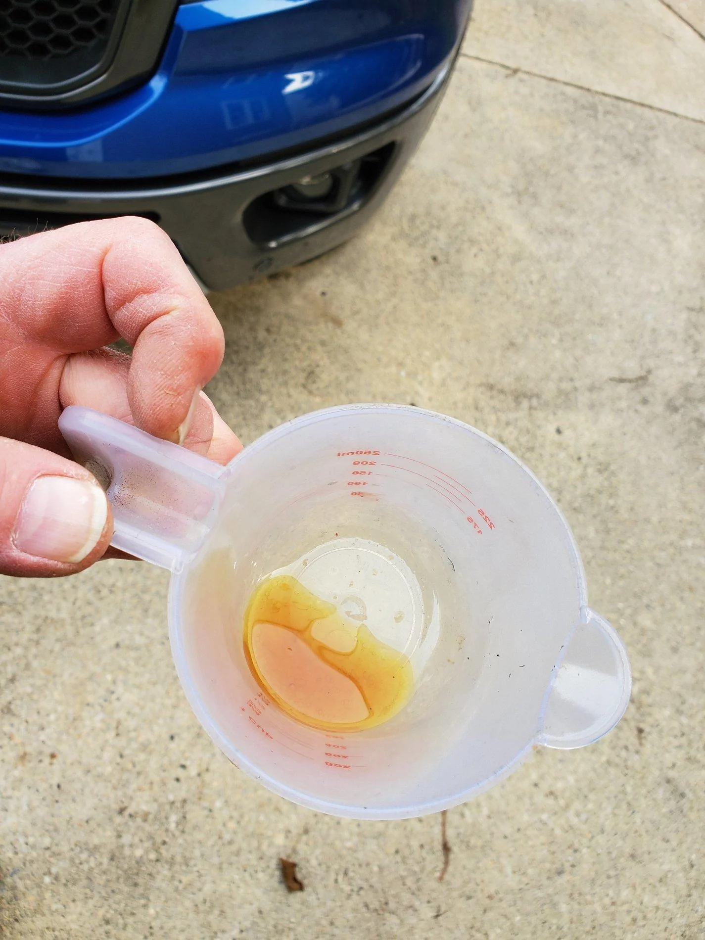

damn... 2500-2600 miles. I installed it before my trip to Ohio for Thanksgiving. Looks like I should check it a bit more often!
1.0 Number of miles since last dumped the catch can. 1st dump
2.0 ml / ounces of fluid collected (pour into a clear container and post up a photo). 2+ oz
3.0 Type and grade of oil I'm using. Shell Rotella gas truck 5W30 full synthetic
4.0 Octane and type of fuel I'm running. 93, Shell and Racetrack
5.0 Leadfoot or Grandma? Moderate, can't remember the last time I put it to the floor... It responds so well to just a little right pedal you don't have to!
6.0 Mostly Fuel, Mostly Oil or both. I'd say fuel.
7.0 Mileage with CC. 25-2600, Total Mileage 7750
8.0 Short trips, Highway or Both. Mostly highway cruising from TX to Ohio and back 70-80mph.
Thanks for posting this.
Sure looks like fuel for the most part. Fuel that would have helped to clean the back of the intake valves.
