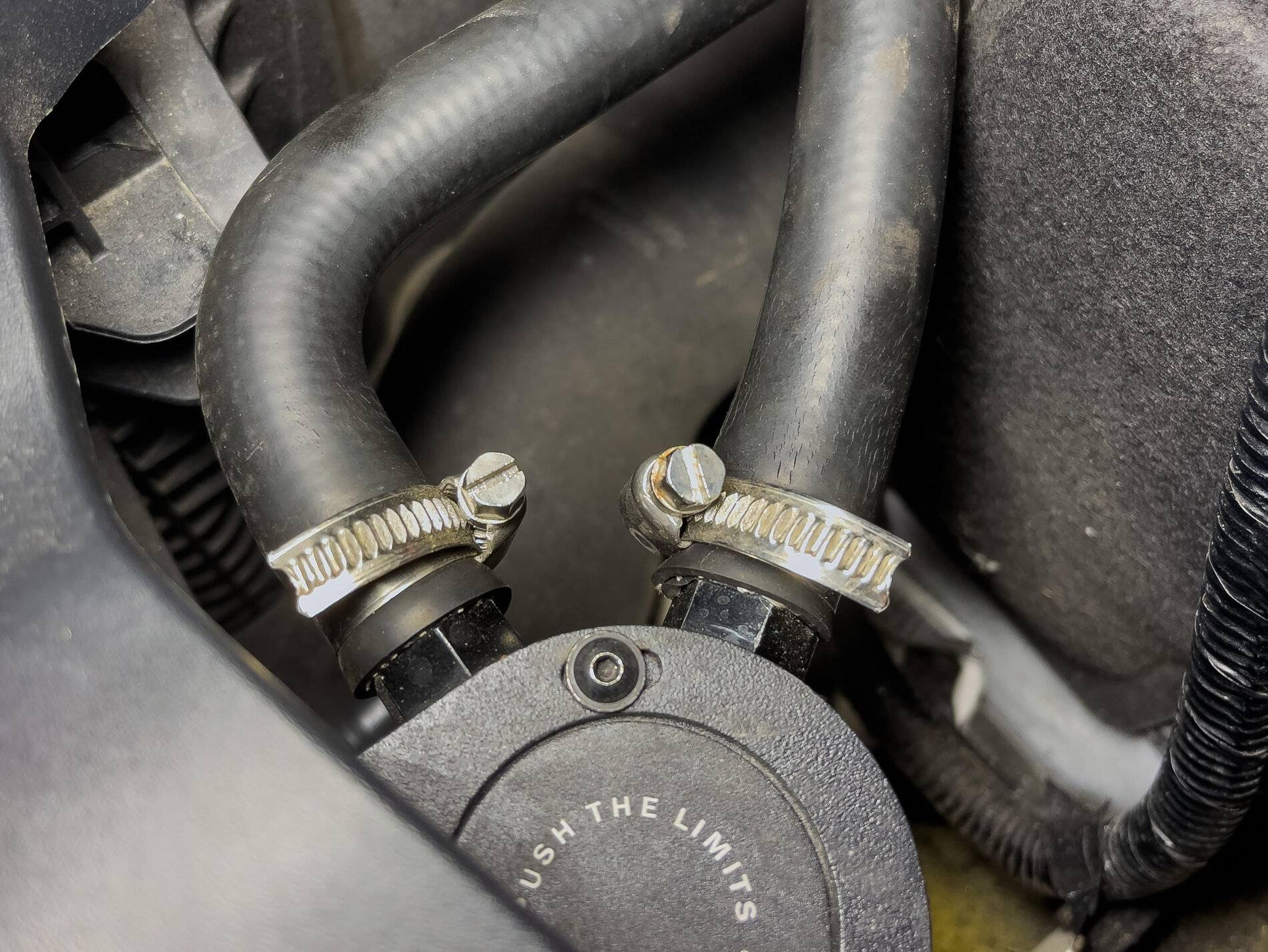

So Mishimoto sent me new hoses for my catch can but I completely removed the can. First, I have no idea how they make it seem so easy to remove the hoses from the factory ports; I do not have huge hands. Second, after about an hour of wrestling and cutting my hands, I finally removed the old Mishimoto hoses. They had a light coating of a brown "powder/residue" on them. A quick sniff confirmed that the hoses stink of exhaust/fuel, just like the old days working on cars. To make sure, I put the wife up to the sniff test since I had been exposed to it for over an hour. Same conclusion, smelled of fuel to her. So I made the decision NOT to reinstall the catch can since it was extremely difficult to remove the hoses from the factory port.
Took the Ranger out to run errands, 30 minutes of drive time, parked her in the closed garage, no odor. Yesterday after an hour trip home from work, parked in the closed garage, 30 minutes later, voila', NO smell. Its the hoses! If they had some kind of hard shell like the factory pipe, nonpermeable, that would kill the odor. I have a slightly used catch can with brand new hoses for sale, cheap, if anyone is interested?

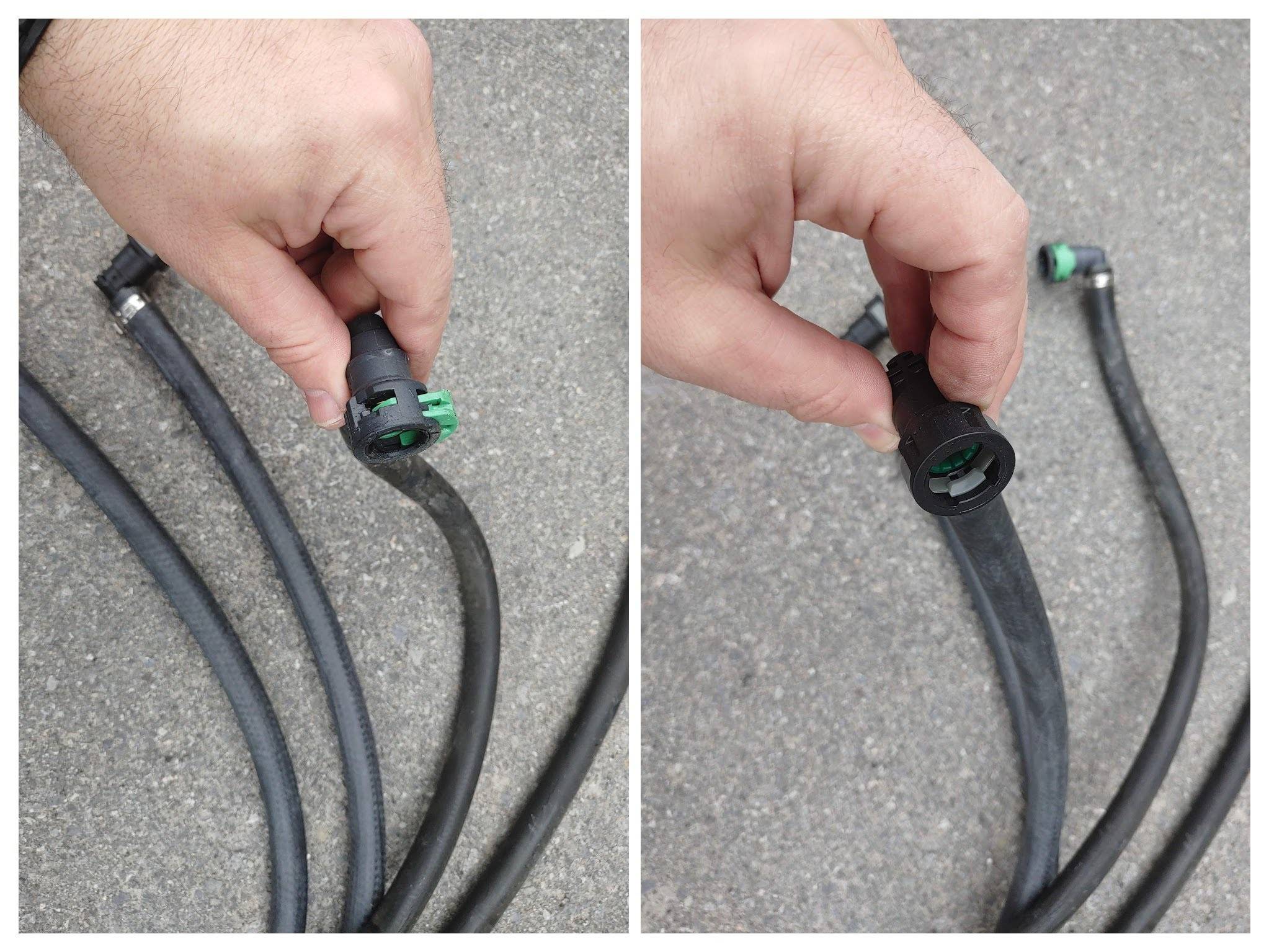

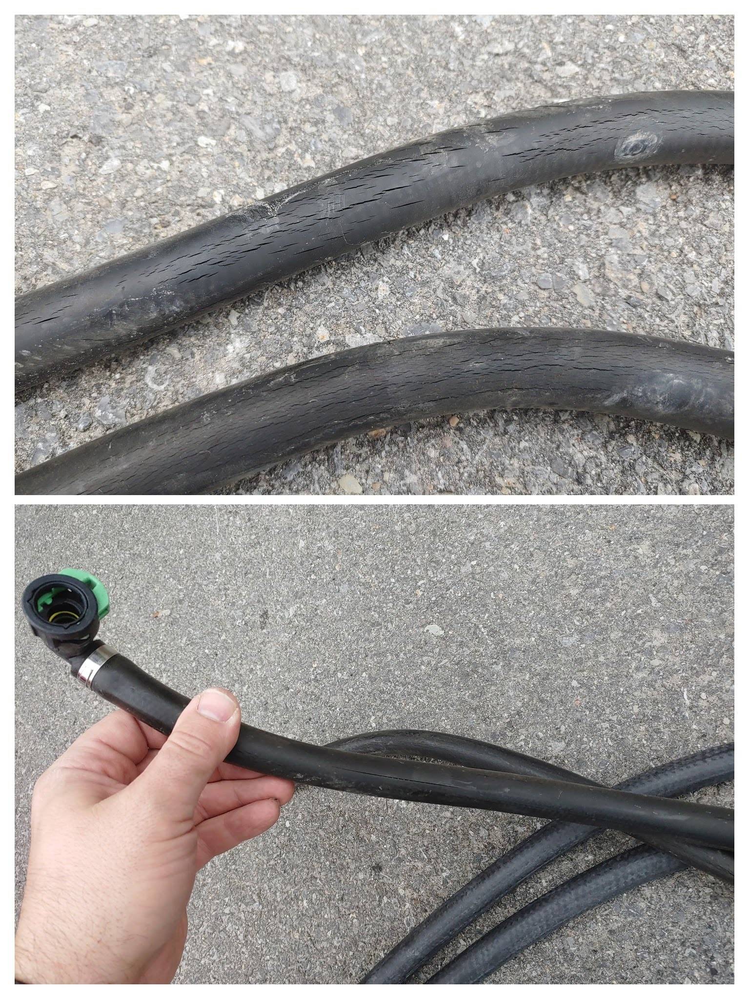

Been installed on my truck for a little less than 8 months. Didn't notice the fuel/oil smells until a month to month and a half in. I thought it was because I forgot to empty it once because it was quite full. Continued to smell the vapor, even though the can was not at all full. Took a look at the hoses in the wheel well and no leaks present, but I did notice these cracks on the hoses going to the barbs on the catch can. There's no leaks and they're dry, however what the other guy said about the smell permeating from the hoses does make sense. It looks like Mishimoto is using incorrectly rated hoses for this application.
I've sent them an email regarding this to see what they say. If this persists, I'm not sure what I'll do. Cutting off the hoses and replacing them with silicone or equivalent fuel/oil rated hose is one thing, but that doesn't bode well due to the kit hoses having OE-style quick connects.
I may be considering another manufacturer for a catch can kit for my truck.

  • Gas Smell around front quarter panel developed within a couple months
  • Discovered the hoses had developed cracks December 2021
  • Waited until February 2022 to submit for warranty hose replacement with Mishimoto

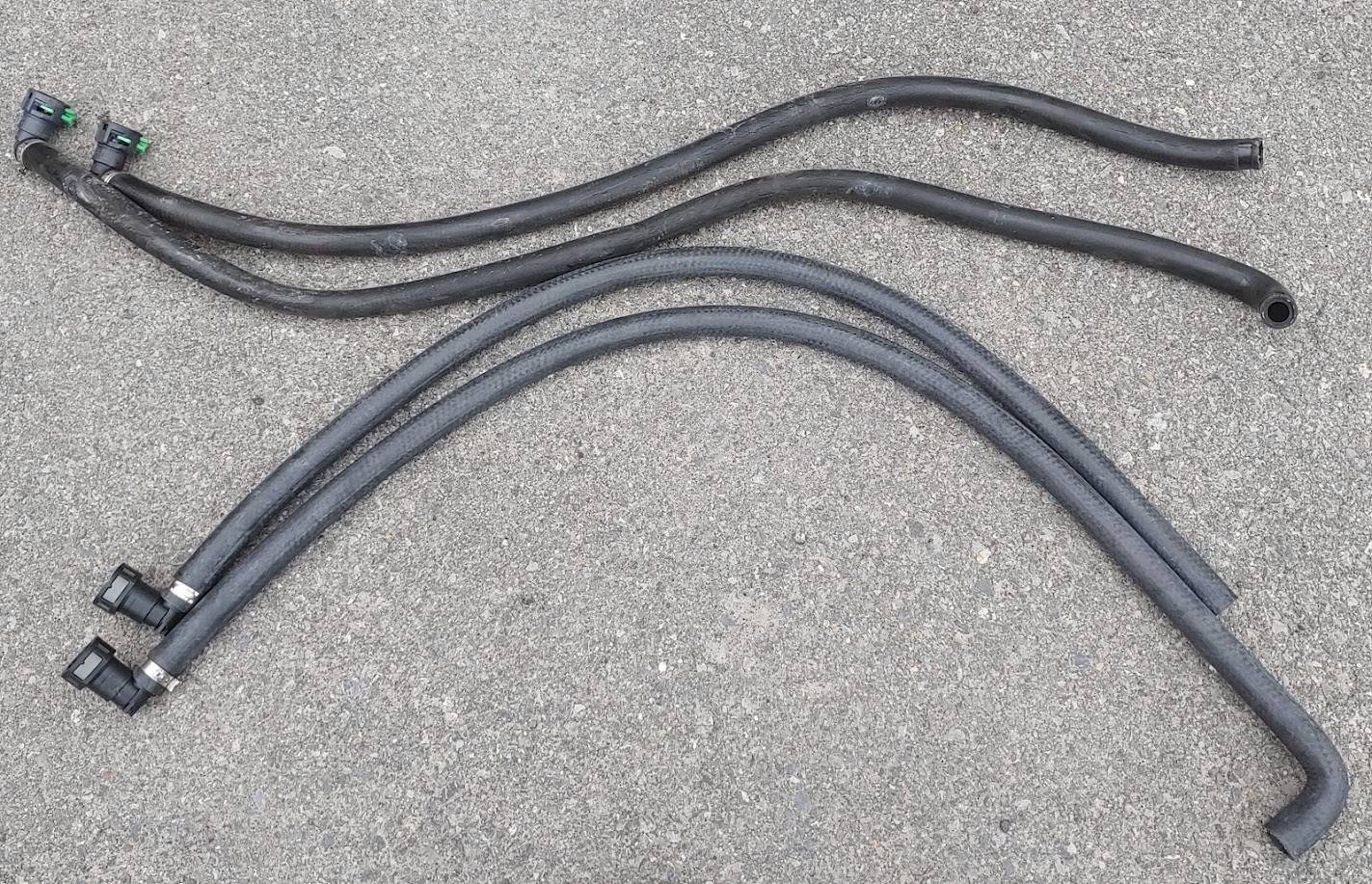

    • There was going to be costly replacement + UPS shipping to Canada but the Mishimoto reps found a way to mail the hose kit USPS at a more reasonable fee
  • Installed Yesterday April 2022 (So far so good?)
Photos: Old Cracked Hose (Green Fittings) vs New (Grey Fittings)
