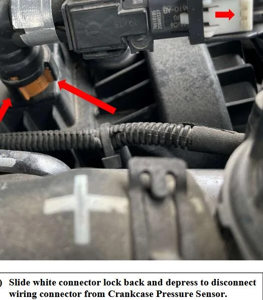

The instructions I downloaded show one connection.
Ok that’s the install for the Ford Performance setup. Once installed no wires have to be removed to drain it. On the 2019’s you have to transfer the sensor to the new tube. There are no wires for the intake side aftermarket setup.

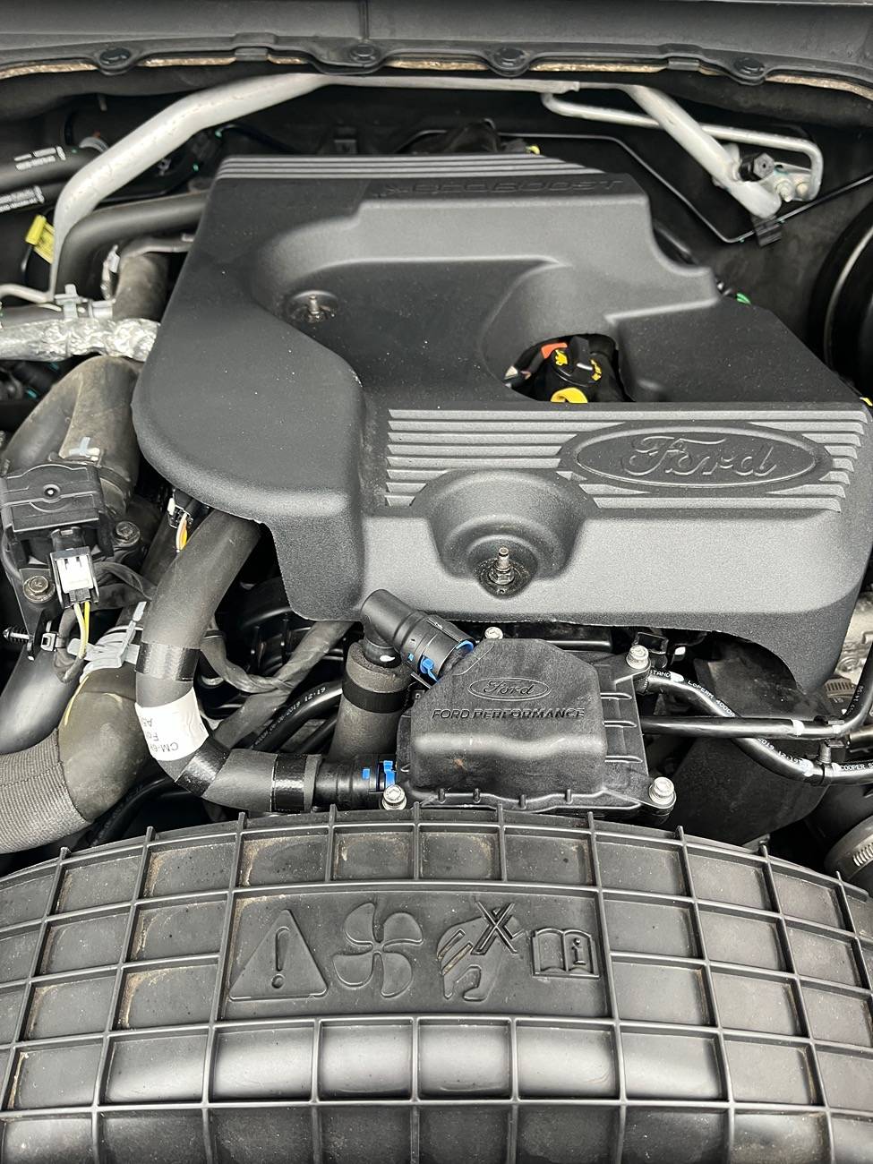

I have the ford performance one, seems to work, easy to clean, and it was free. Used points from my transmission replacement for it.

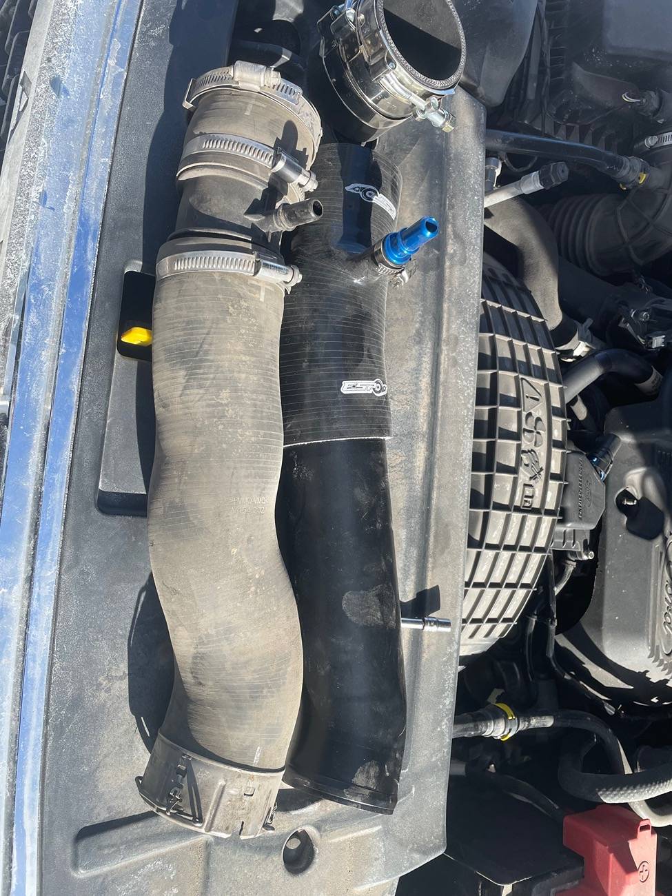

Look right behind the fan shroud you can see it. I took the picture for the cold side pipe comparison.

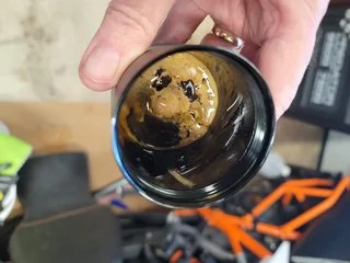

I got the Mishimoto, and the lower hose was truly a pain in the a$$ to install. It's a blind, 'by-feel' install. I check the can once a month, and so far there has been very little oil/condensate captured through last summer. This winter though, I was getting about ¼" of oil & water monthly making trips long enough to bring the engine up to temperature. These past few weeks I've been making a bunch of short trips, and I know the engine has not fully warmed-up by the time I get home. This week I opened the can and found it about half full. That's 2½ weeks worth:
I'm not looking forward to changing that bottom hose if/when the time comes, but I'm happy the can is reducing the oil/water vapor that gets back to the intake.
