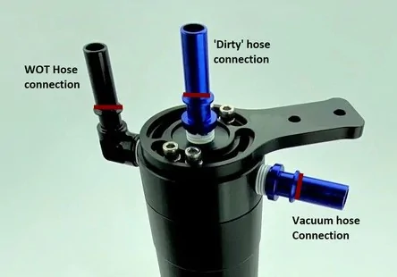

I am running the UPR dual vacuum source kit. It is very well engineered. The install instructions are rudimentary and could use work. They assume too much automotive knowledge from the customer. Mishimoto excels in this area. Their kit seems to have the same vapor problem problem and they use simple compression clamps on the can connections. This seems to rule out both loose connections and the air intake track vacuum source in the UPR kit as the issue.
I think the O rings helped. They do not act as seals directly, more like spacers to keep the seal in the quick release adapter up against the bottom of the rib on the outlet tube. The red lines shows where I added the O rings. There is no longer any play in my fittings.
I do not think that the vapors are coming from the air intake track via the secondary vacuum source as UPR suggested.
I have noticed that the odor grows stronger the longer the truck sits in the garage and it seems to becoming from the hose/can location near the battery.
I see no oil dampness anywhere indicating seepage or leaks. I have checked the hoses, all connections, and the catch can.
I am beginning to suspect that the hoses are permeable. Ford used a specific and unique hose for this connection. It seems to be soft metal based in nature. But I am now relegated to grasping at straws! If the problem is not the can, and not the connections, that leaves only the hoses.
