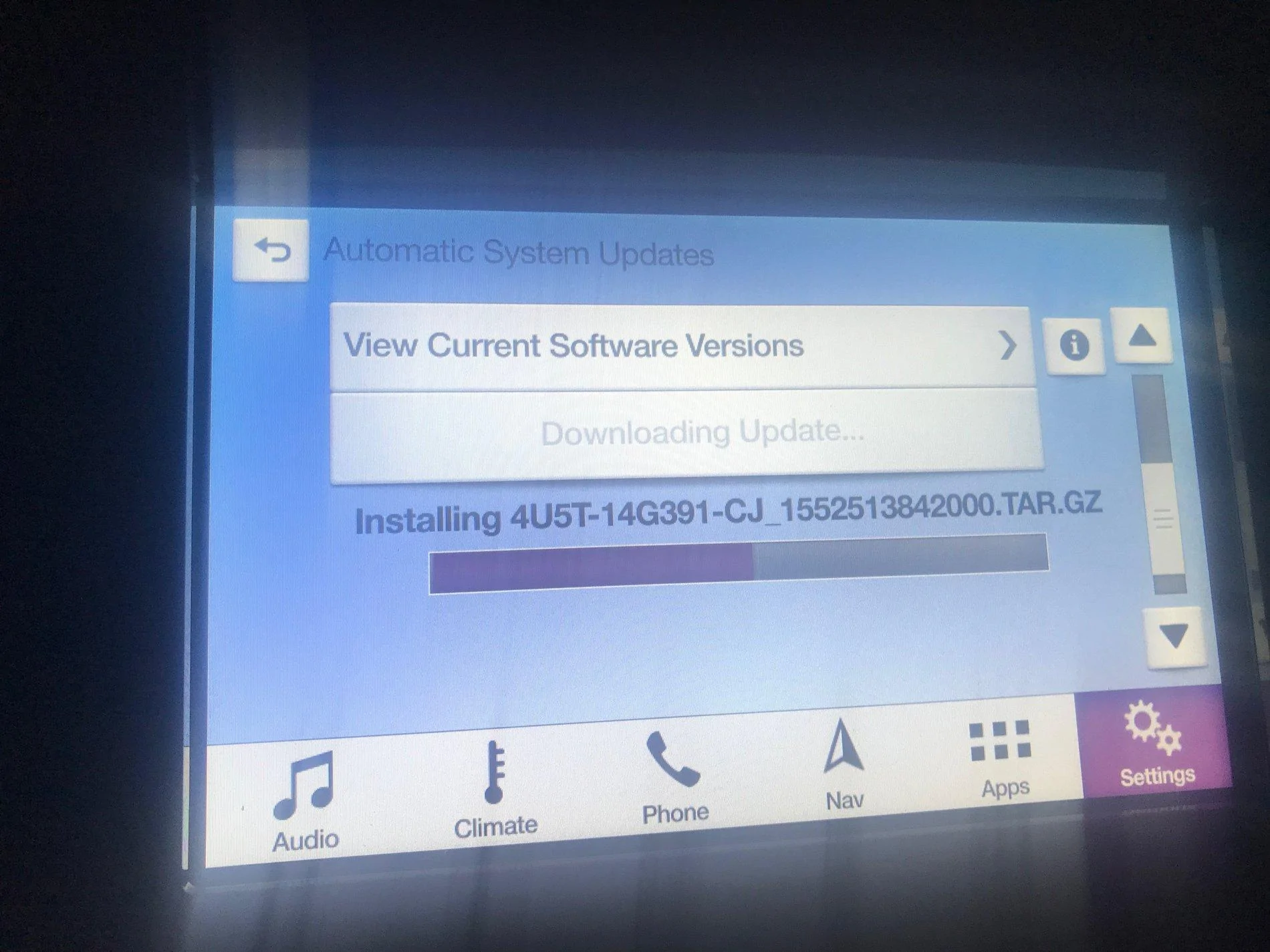

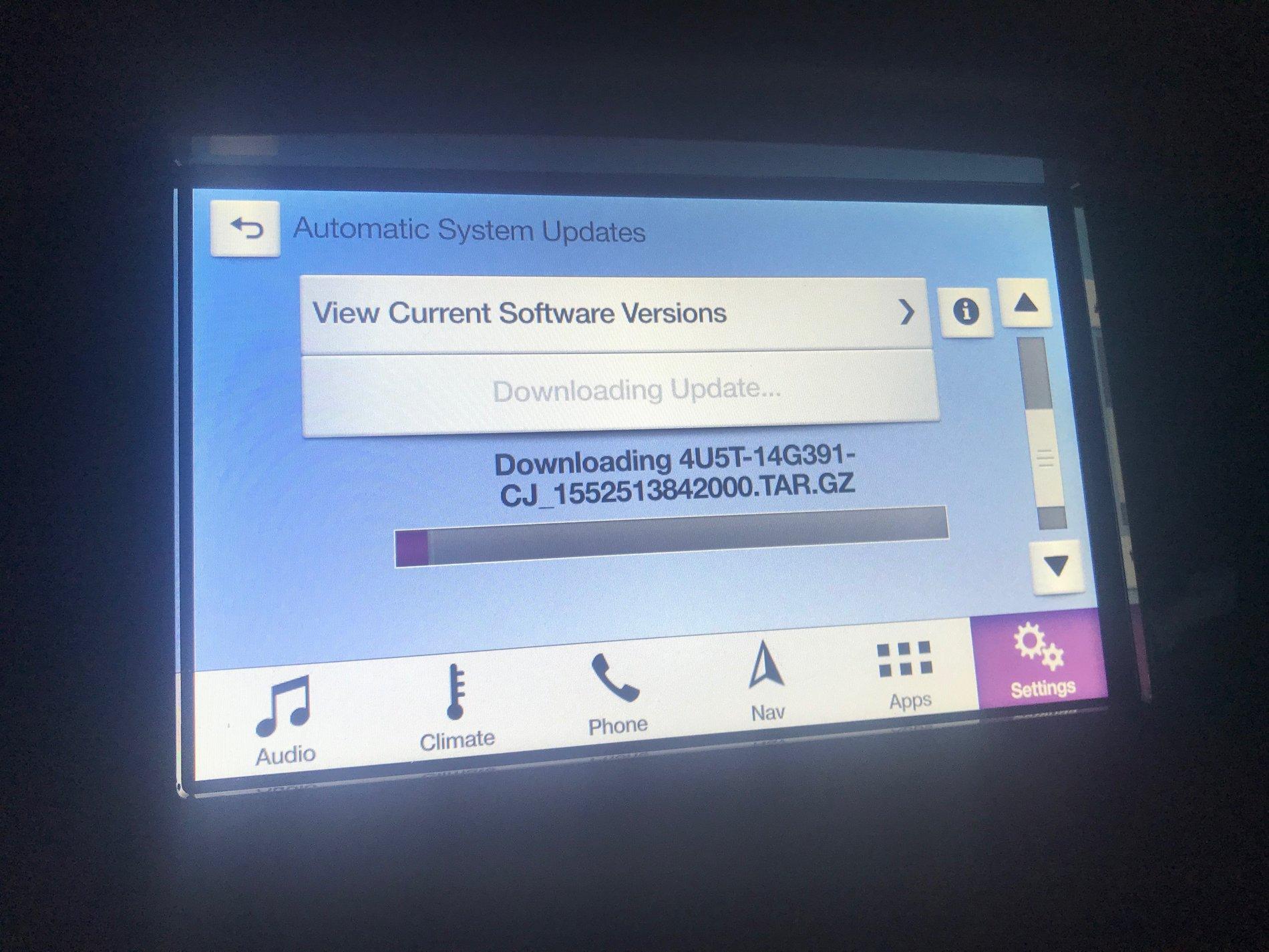

Ok, now to throw another wrench in the thread. I just tried to connect to my home WiFi and then Check Software Update and this is what came up.
4U5T-14G391-CJ Does anyone else see this update trying to come through? It downloaded and then started to install and then quit.
This update is 4U5T-14G381-AN so this must be a different one.

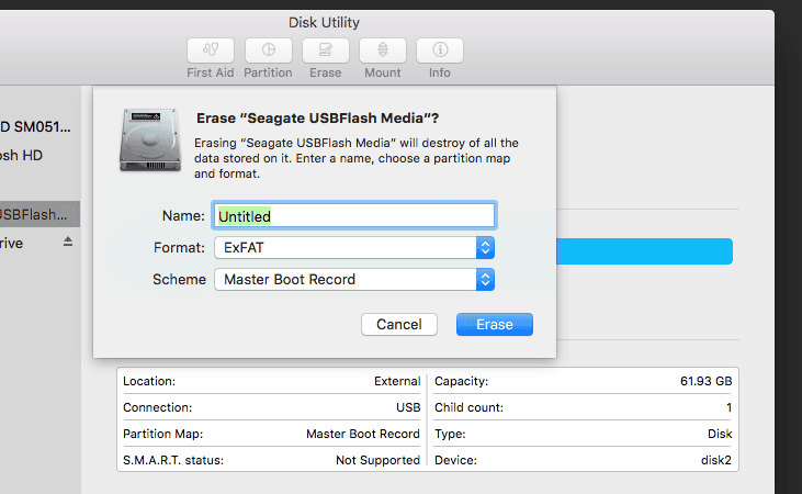

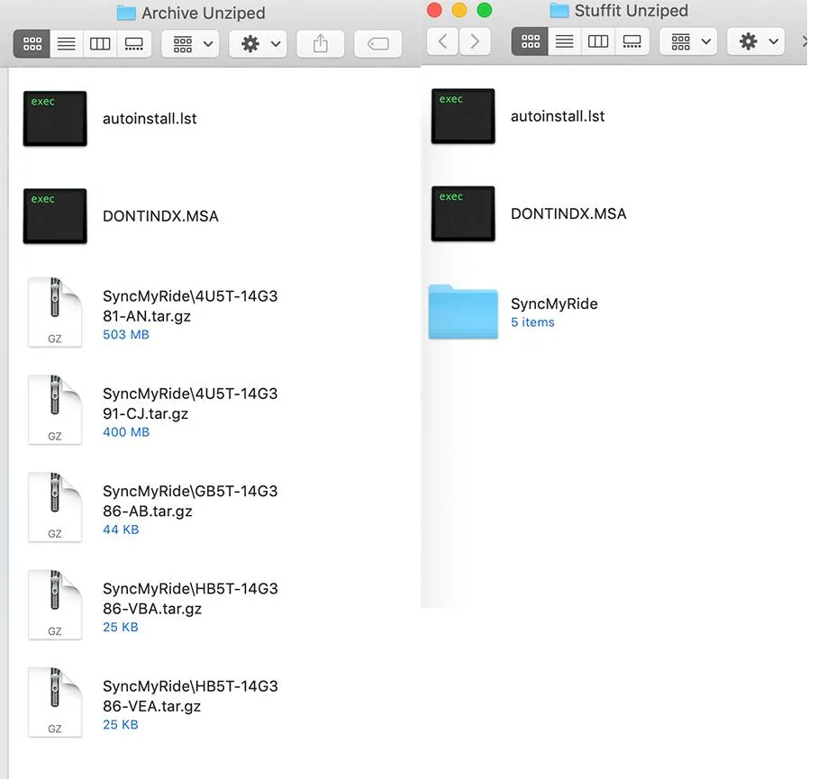

Mac Users: I had an issue with my first USB drive efforts. I used these settings to reformat my flash drive, and the system recognized and started installing right away.
Using Disk Utility:
"Erase" on top >> ExFat >> Master Boot record
New change I did is to use the recommended StuffIt Expander to unzip.
Not sure if one or both did the trick, but the install went well.
I was also able to upload the XML successfully. But I had to restart my web-browser and walk through the download process again (I didn't come back until a day later to upload the XML. Web session must've timed out).
Using Disk Utility:
Yep, as I suspected. It defaults on GUID not Master Boot Record.
Good info!
EDIT: I can confirm that Stuffit Expander is needed....the MacOS default Archive Utility treats things differently.

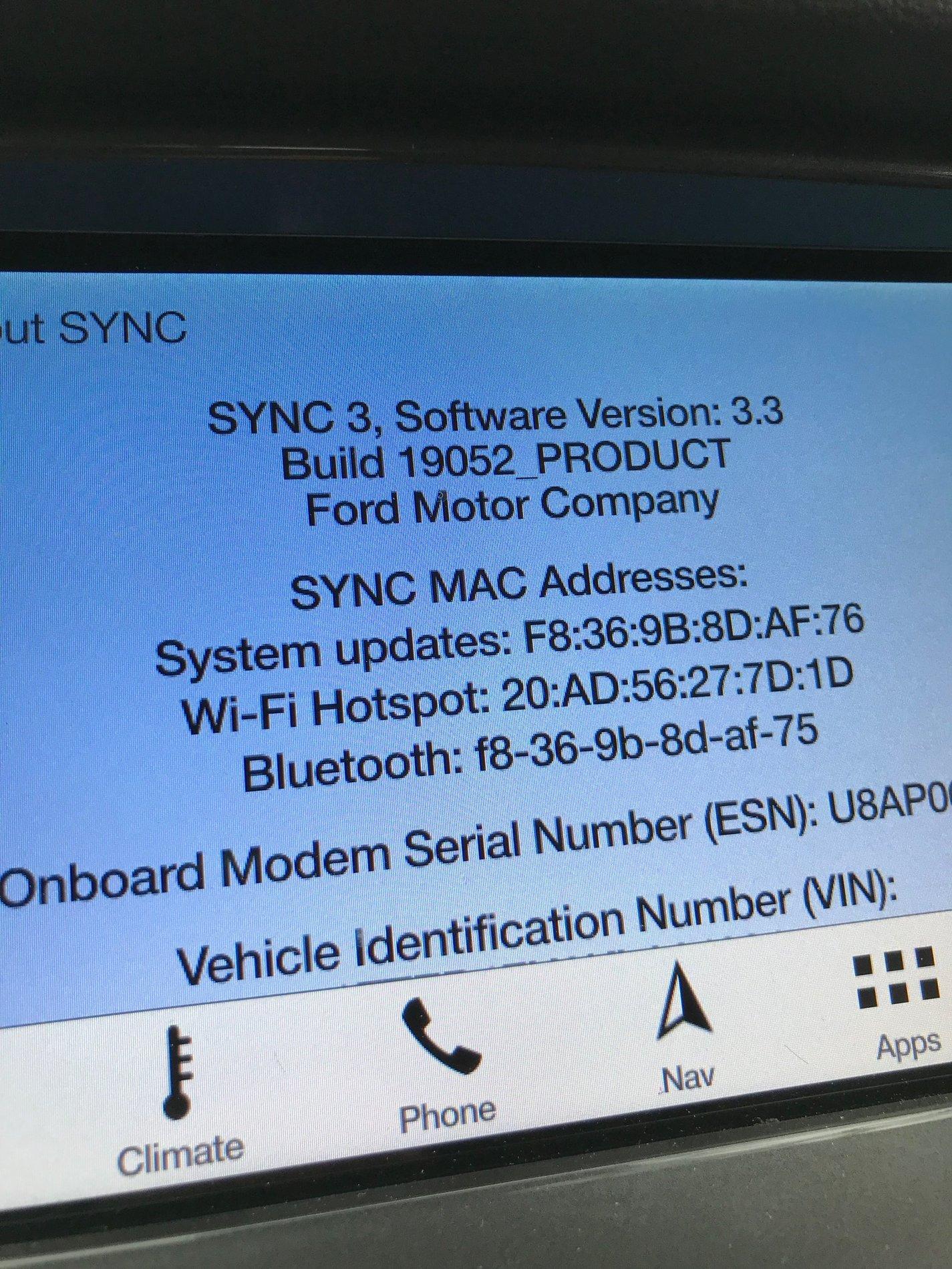

Thanks, I'm going to have to start keeping the old files I guess so I know what I did last. I have the same issue as Rangerdanger....it downloads to 14G381-AN file, which translates to build 19052 if memory serves.
