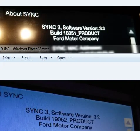

To piggy back on some of the comments about the Sync website, I have confirmed that I have installed 19052, but there's nothing I can do to get the Sync site to recognize this, and have tried to upload my succesful installation file numerous times. Arrrrrgh!
