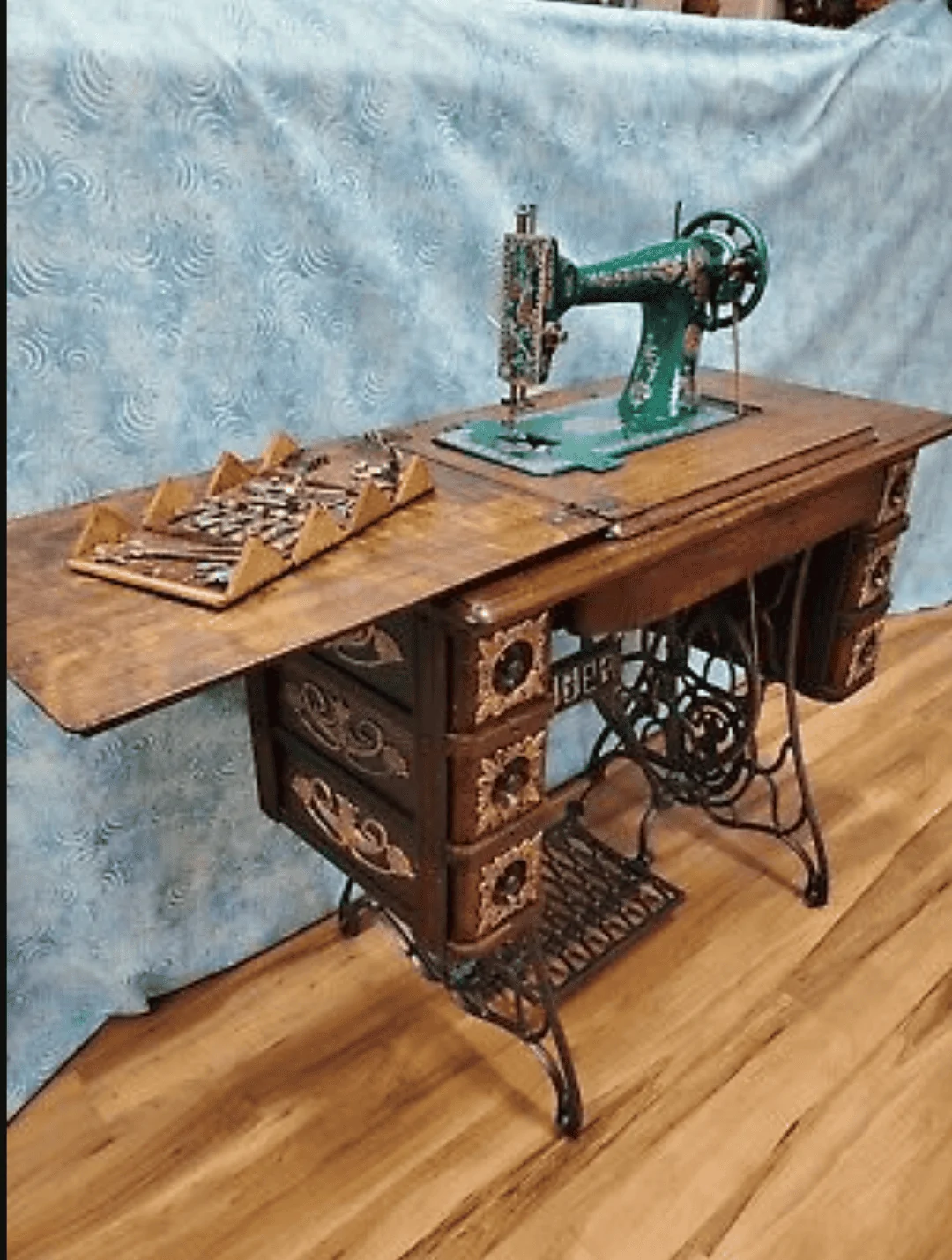

It's also the push for less cost and bigger profits. Profits are good, but so many companies nowadays don't do much more than someone watching over them requires.
Here's how they built something as simple as a sewing machine - all they had to do was build something that made a needle go up and down, but this is how they built things.
