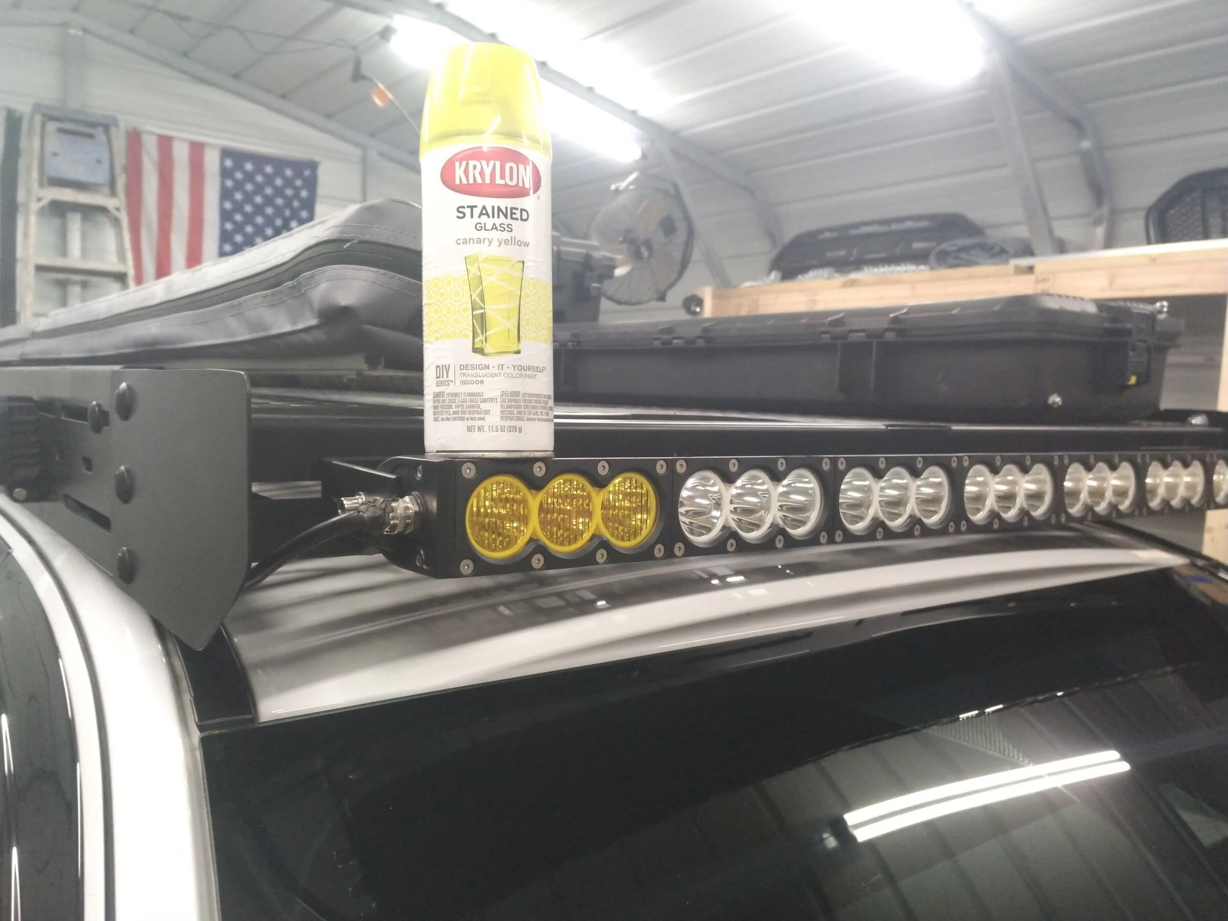

Page 22 of the FP Fox 2.0 install manual below shows fog light adjustment procedure.​
Also, Jack, @OFC Ranger has had good luck with this stuff.
Good thing with this glass paint is the more you layer it the more deeper it gets. Just top it off with a UV non-yellowing clearcoat.
If he wants yellow he can use this;

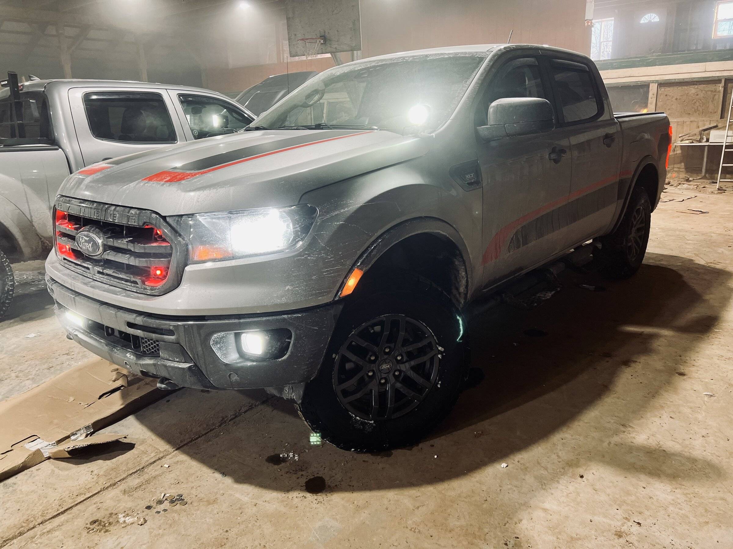

Finally got a chance to do them…fog lights really tested the patience ?. Here’s the results.
