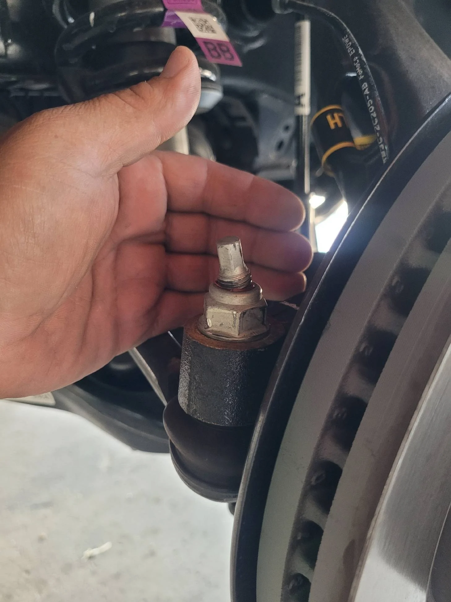

Ford dealership goes to install my leveling kit and send me this picture..
Anyone else experience anything like this?
Bought the truck 2 weeks ago today and the tech at the custom shop says he pulled off the tire to begin the work and notices this….
At LEAST he showed you! Sad to see something like this, but in mass manufacturing shit happens and workers just kinda look the other way! I worked 36 years in manufacturing sub components for aircraft and the Abrams Tank. Workers will try and pass of shit if no one is watching, happens all over, every company. Still sad to see it wasn't caught by Quality Control....

Interesting. Two notes, witness marks on nut indicate possible removal and reinstall prior to this. Second, I see what appears to be an impact mark on the small hex area above the threads which coincides with bend direction. Something had to impact that hard to bend that!
Agree! Something that short takes quite a bang to bend it.

If cross threaded, there would be lots of carnage on the exposed threads. They look clean. The plastic thread locking ring on the nut is only destroyed on the one area which supports bent after nut installation. Only thing I can think of in the absence of impact is the torquing device used to tighten that on the assembly line snagged it post torquing?
The person who did it could have cleaned it and hoped no one would see it! Have seen it happen in my line..

Did you have them correct it? I spoke with my salesman whom I’ve purchased 3 vehicles from and he said “well let us take care of it so we’re not facing any potential issues in the future”
Not yet at least. I live in the desert so it is less of a concern for me.

Tell the dealer you expect the ball joint on the tie rod to be replaced, or the tie rod to be replaced. It is not ok. The bolt end of the ball is weakened and could break, the tie rod could then separate from the wheel. Possible steering disaster waiting to happen.
I believe I was told that the tie rod end was going to be replaced
