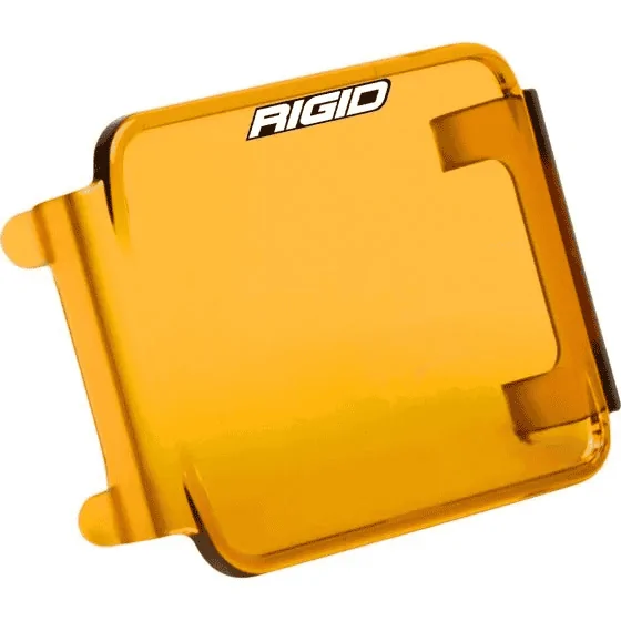

Lariat tremor with led fogs. Was wondering if there was maybe like a lens cap that could be fabricated and jammed in front of it? But that might lead to water build up...

i think it said rigid fogs?
Rigid Ind. makes snap on covers that are yellow / amber. they work well. actually better than the rigid amber lights. i bought a set tried them and returned them. i am happy with the covers.

That cover is almost exactly what I was thinking of! When it's not freezing out I'll go take a look and see if I think it will fit.

if you have the rigid d series pods, sold with the ford perf. upgrades then it should be a direct fit. just be sure to get the correct cover for the series of lights you have.

Tried the tint truck with spray on, no go. Going to likely have to go cover. Not 100 percent sure if I can change the bulb. Might have to look into that this weekend or over the holiday. I think part of the issue is that they are facing into no man's land. Will try and adjust them while checking for bulb replacement opportunities
