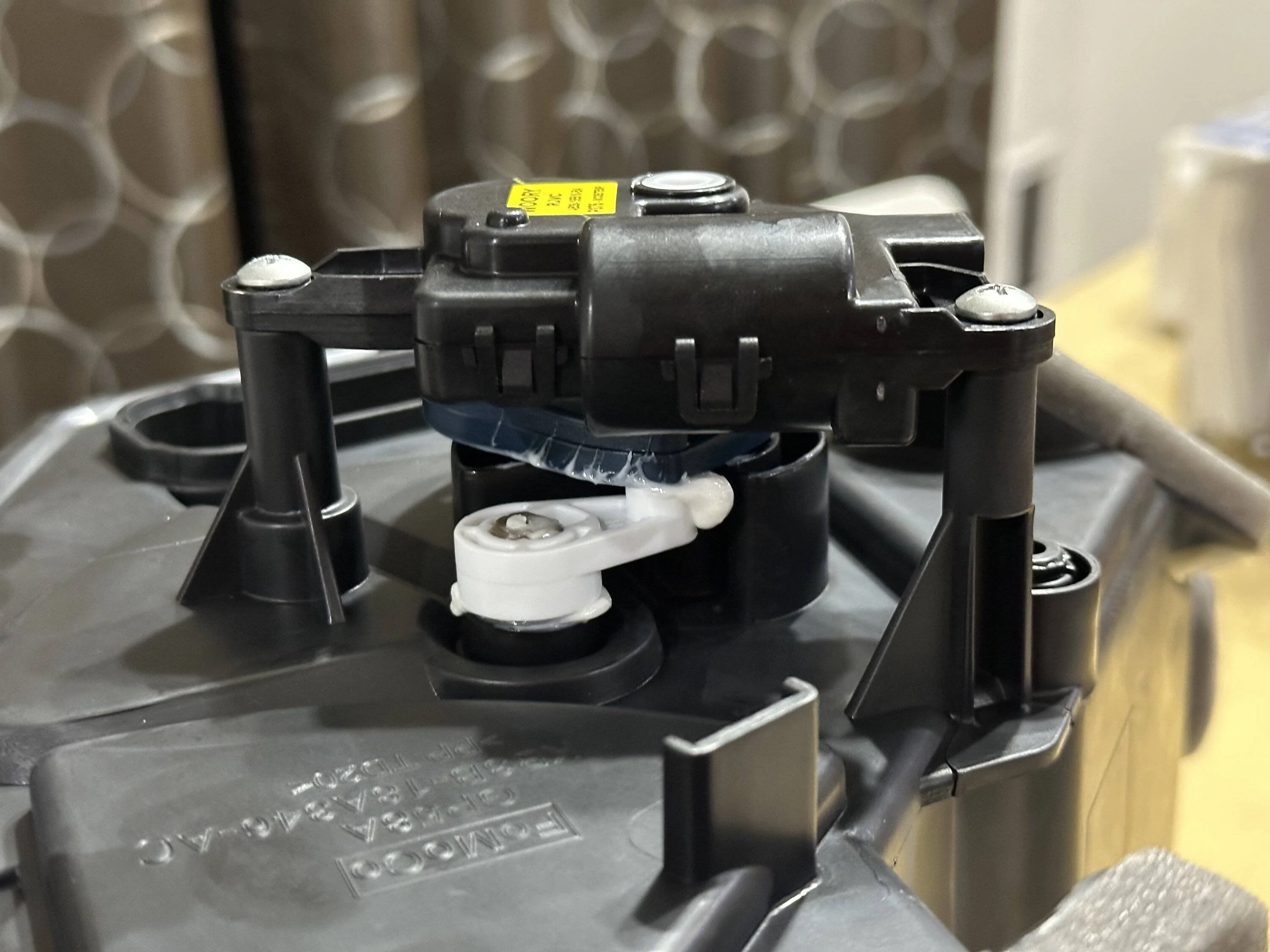

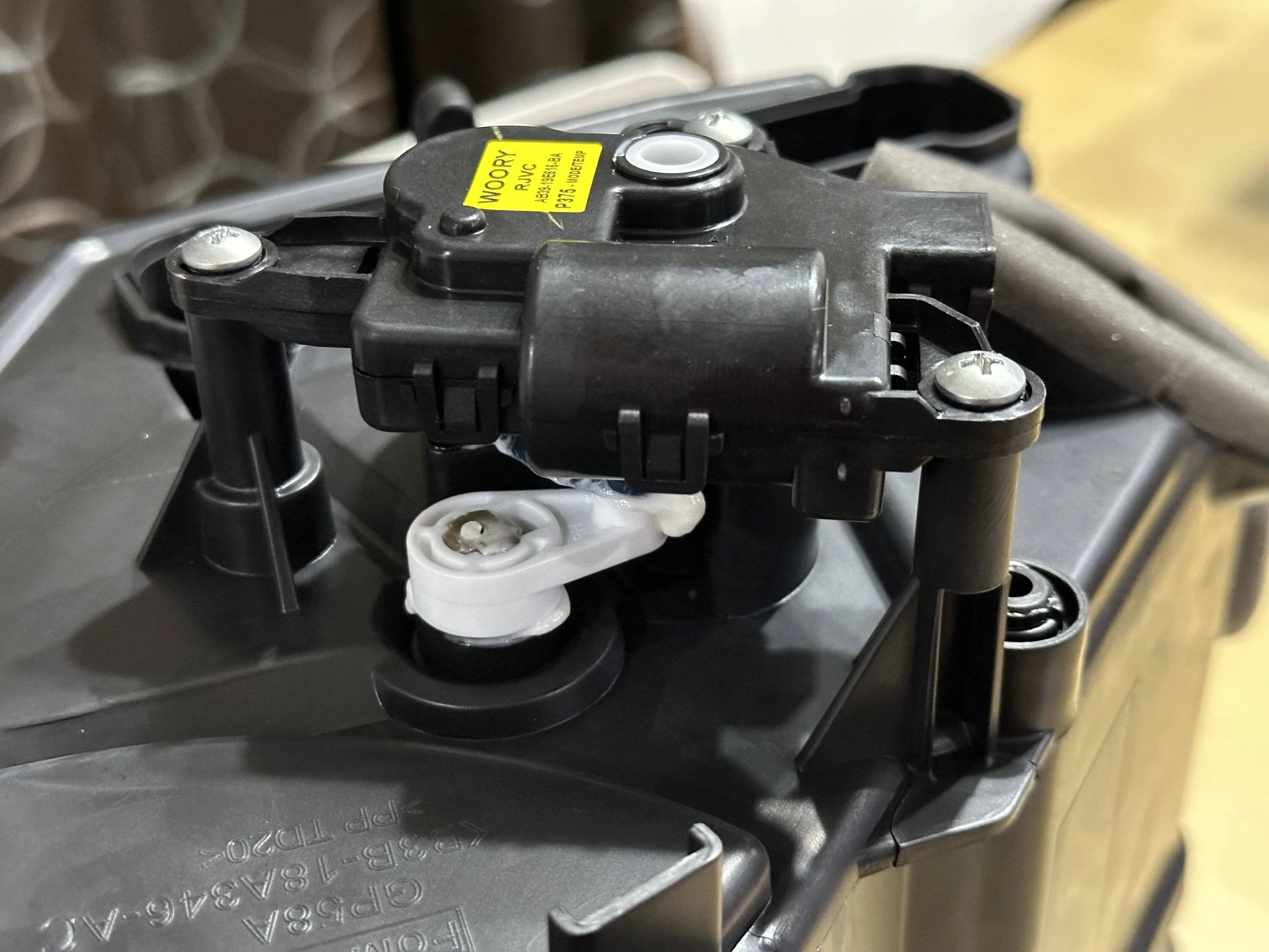

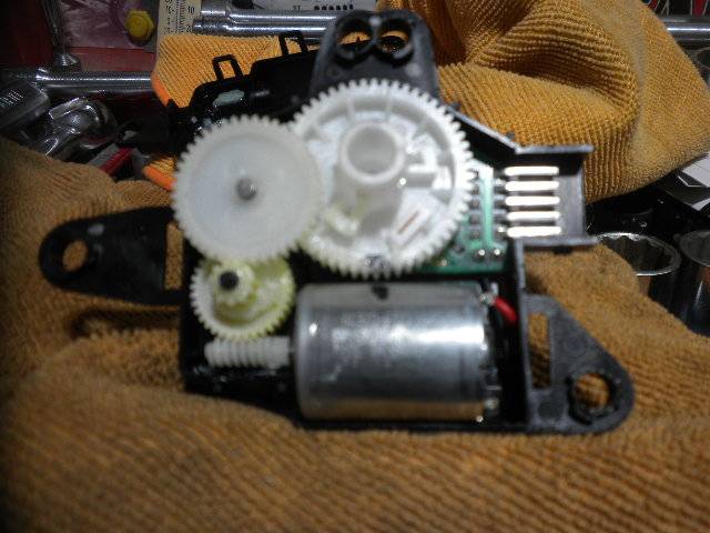

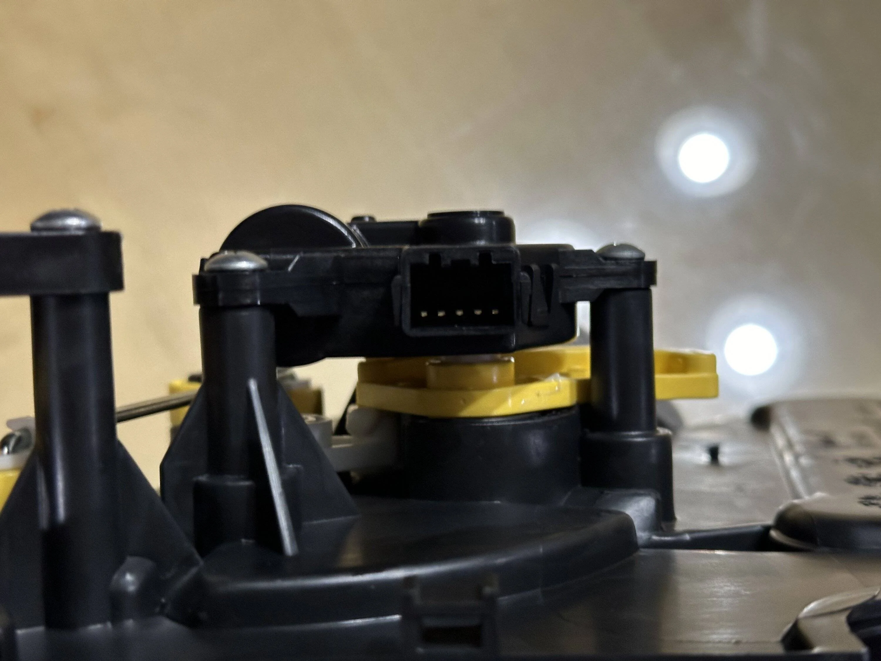

Airline Tech photo of scaring from pin. All gears seem to be good.

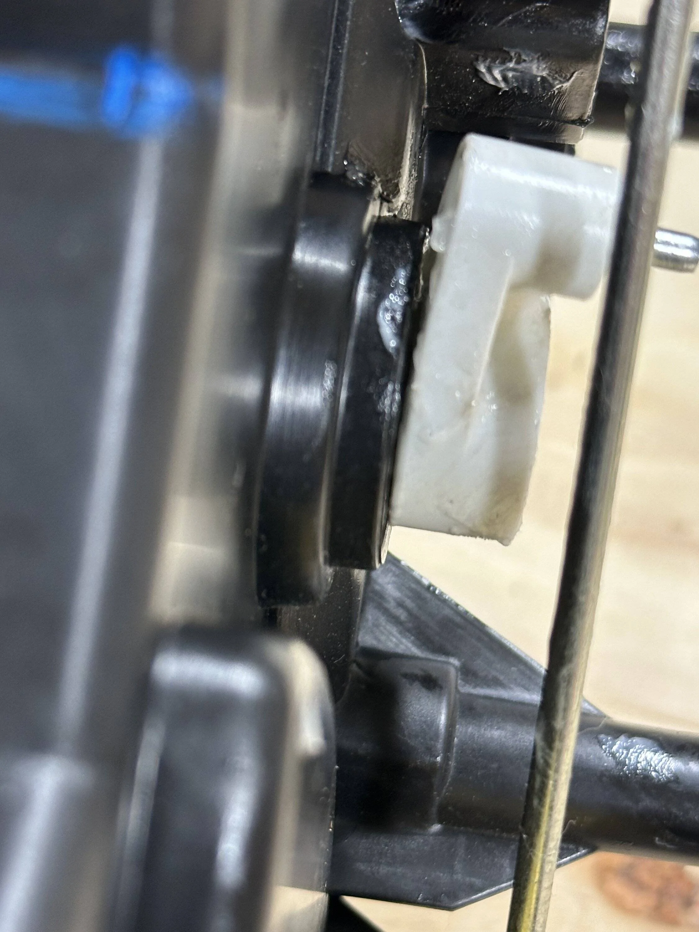

Took some pictures of my defective box and the drivers side pin seems tilted. Almost like the rod was too short and caused the center of the pin to be pulled in towards the box. Doesn’t look fixable without replacement. Every time I tried reseating the actuator it never felt flush and would always jump off the pin
Looks like the door was binding internally and the actuator was trying to push past the bind, and it bent the lever, now the pin will not ride in the guide correctly and pops out.
I’ll double check but it doesn’t feel bound up. I’ll remove the other actuators and compare

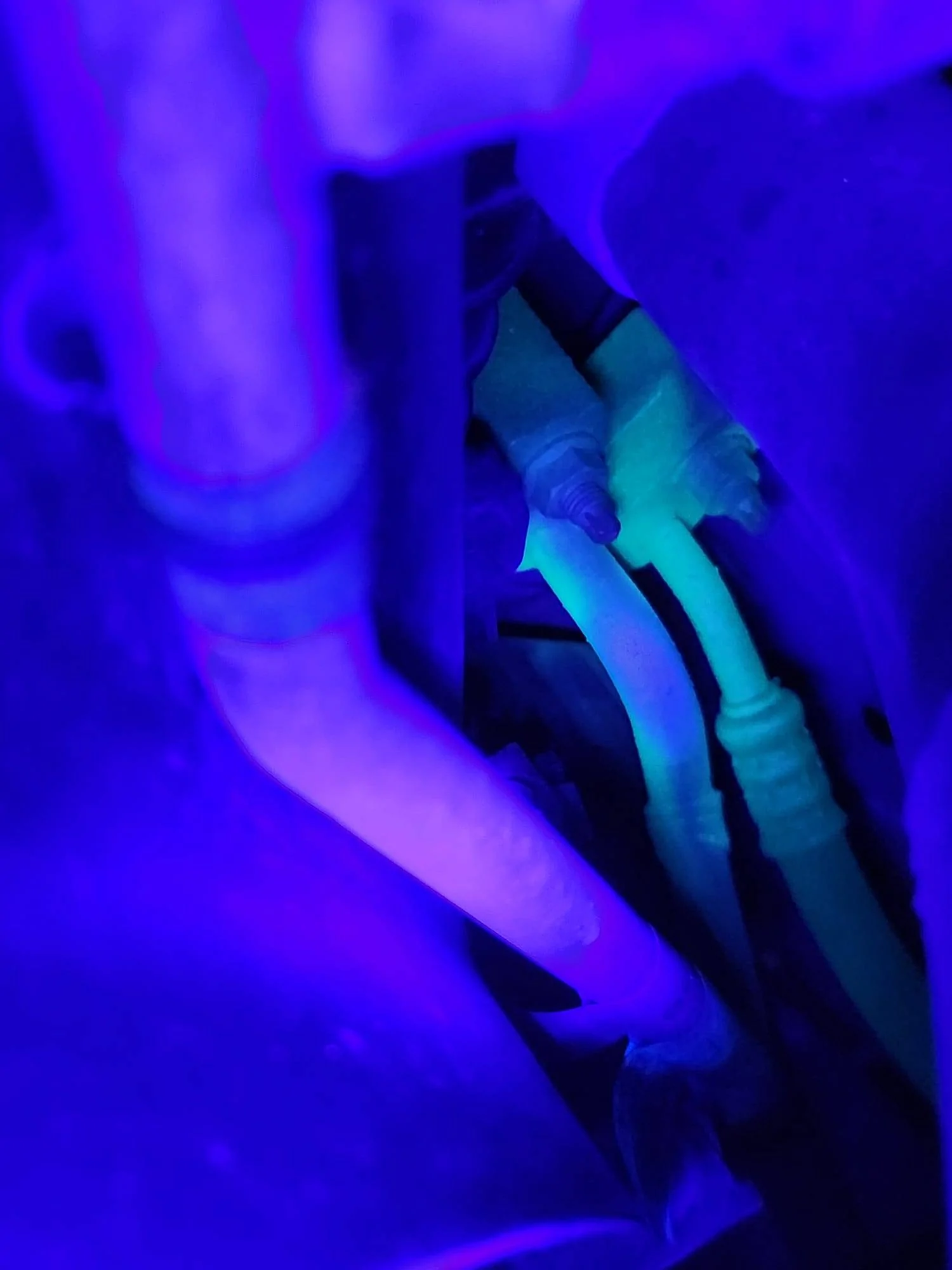

Here's what i found on my 2020 today:
Blend doors are working correctly, for now.
Topped off refrigerant with R1234yf. Low side pressure was at 12psi, brought it up to ~35psi @ 25C ambient.
AC blew cold right away. Found a significant leak with UV light at the condenser to compressor hose fittings.
Factory refrigerant has dye in it.
Or it could be actuator feedback, internally got lost and continued to try to drive the door and bent the lever.
Basically, we know that this is an issue, but we have not found specifics on the cause.
I agree that the lever appears bent, and it’s the cause of it coming off of the bell crank.
It just needs to be investigated as to what caused the lever to bend in the first place.
As it sits at room temperature, you are only missing (2) factors and that is 190 degrees of heat on those doors.
Heat Expands.
And power for the actuator:
Missing the actuator drive, at some point in time did it not stop electrically and continued to try to force the door to close / open.
And bend the lever in the process.
I am curious if you pulled it apart would it show evidence internally like the lever does.

Didn’t pull it apart yet but the drivers side is a lot harder to turn. Tried to upload a video comparison but the file’s too big. Guess I wasted my time taking videos

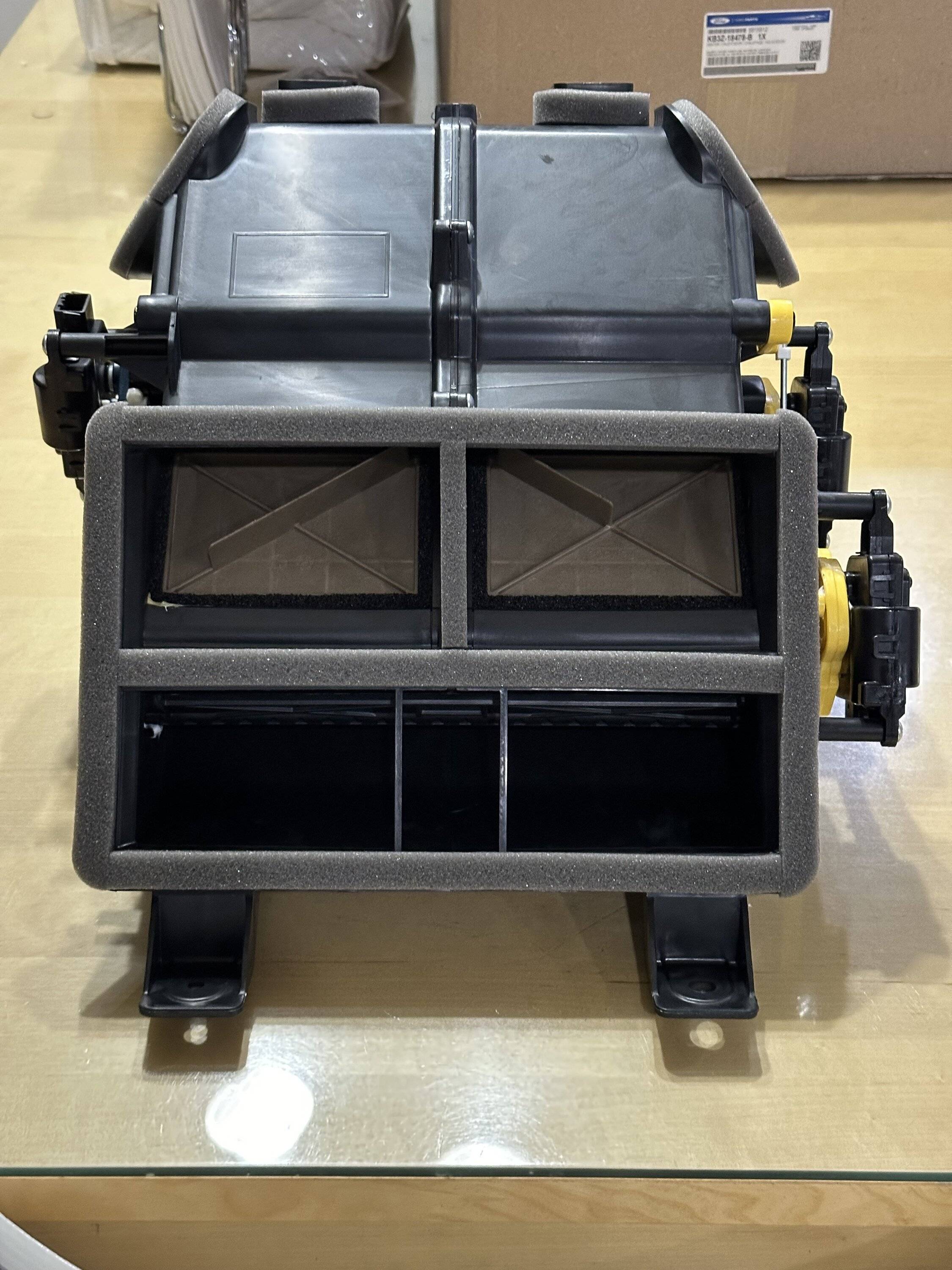

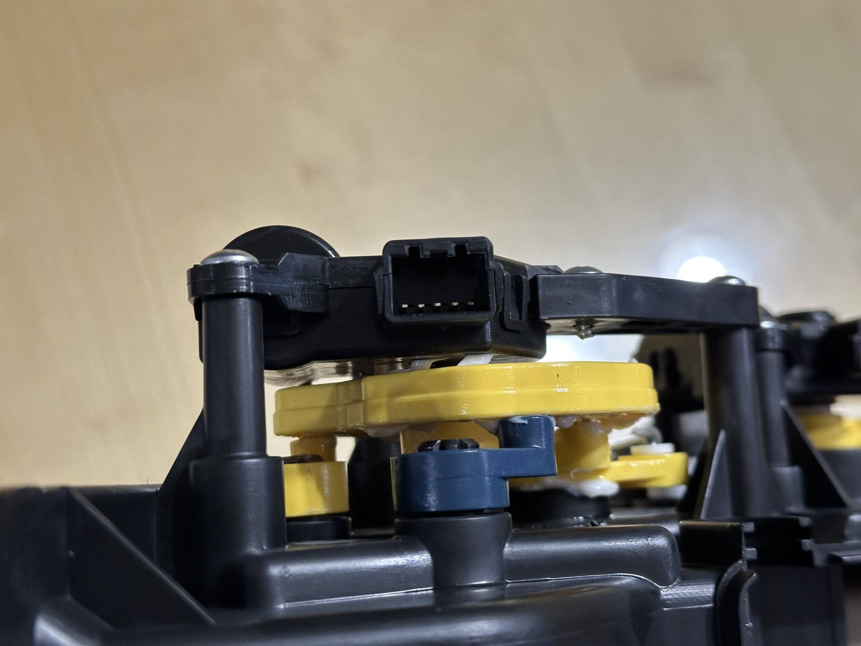

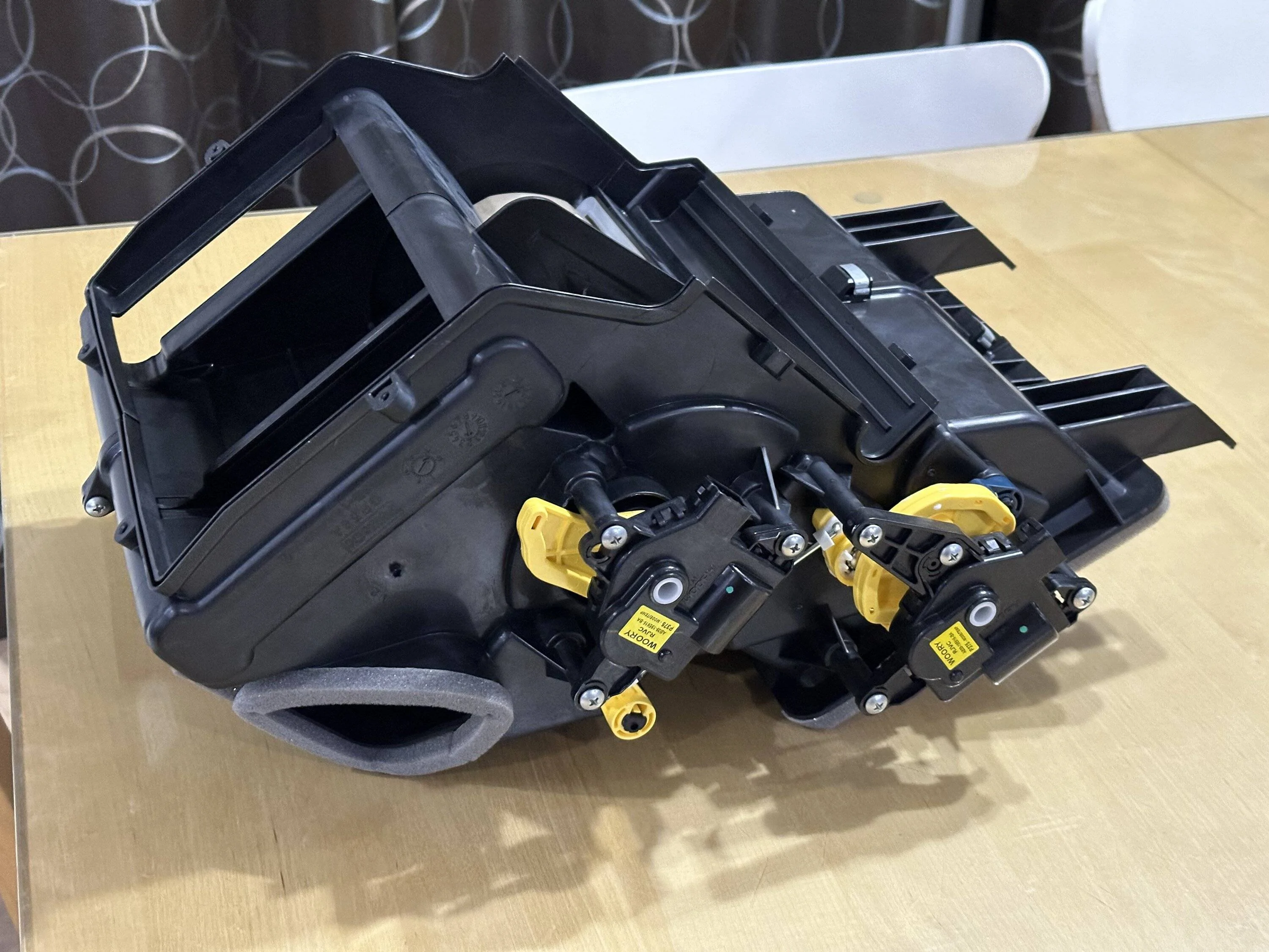

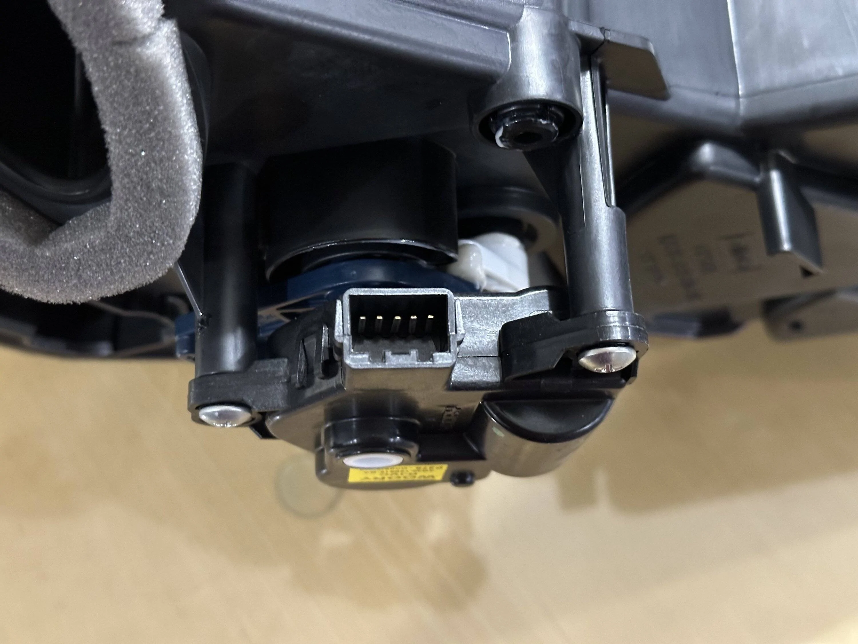

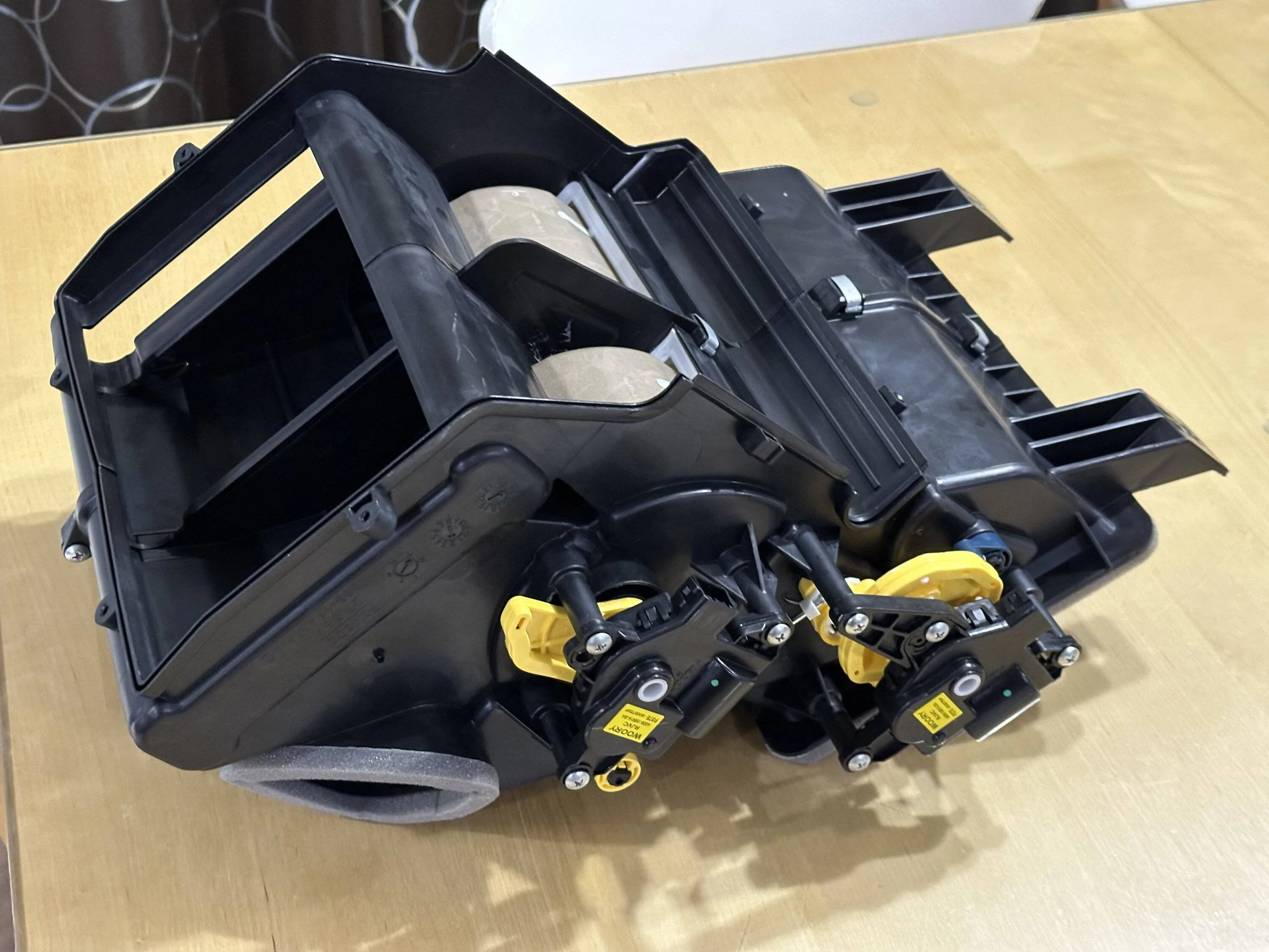

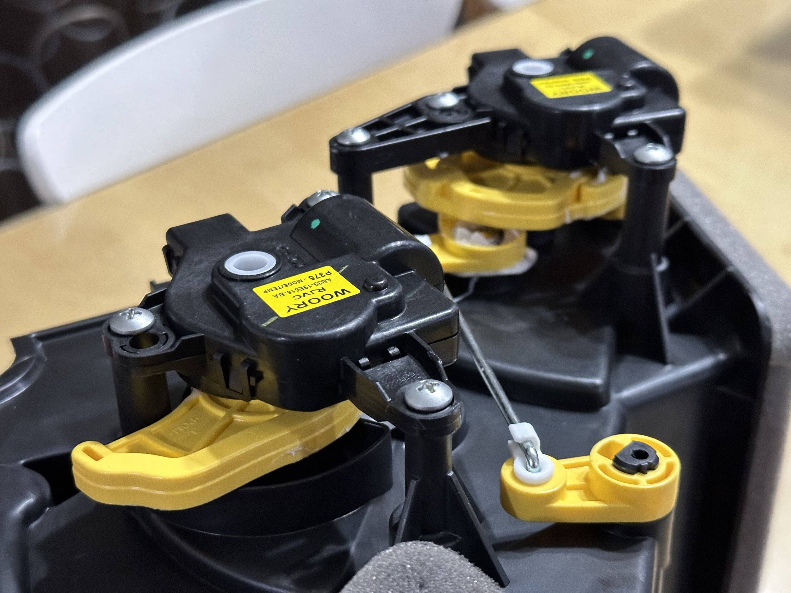

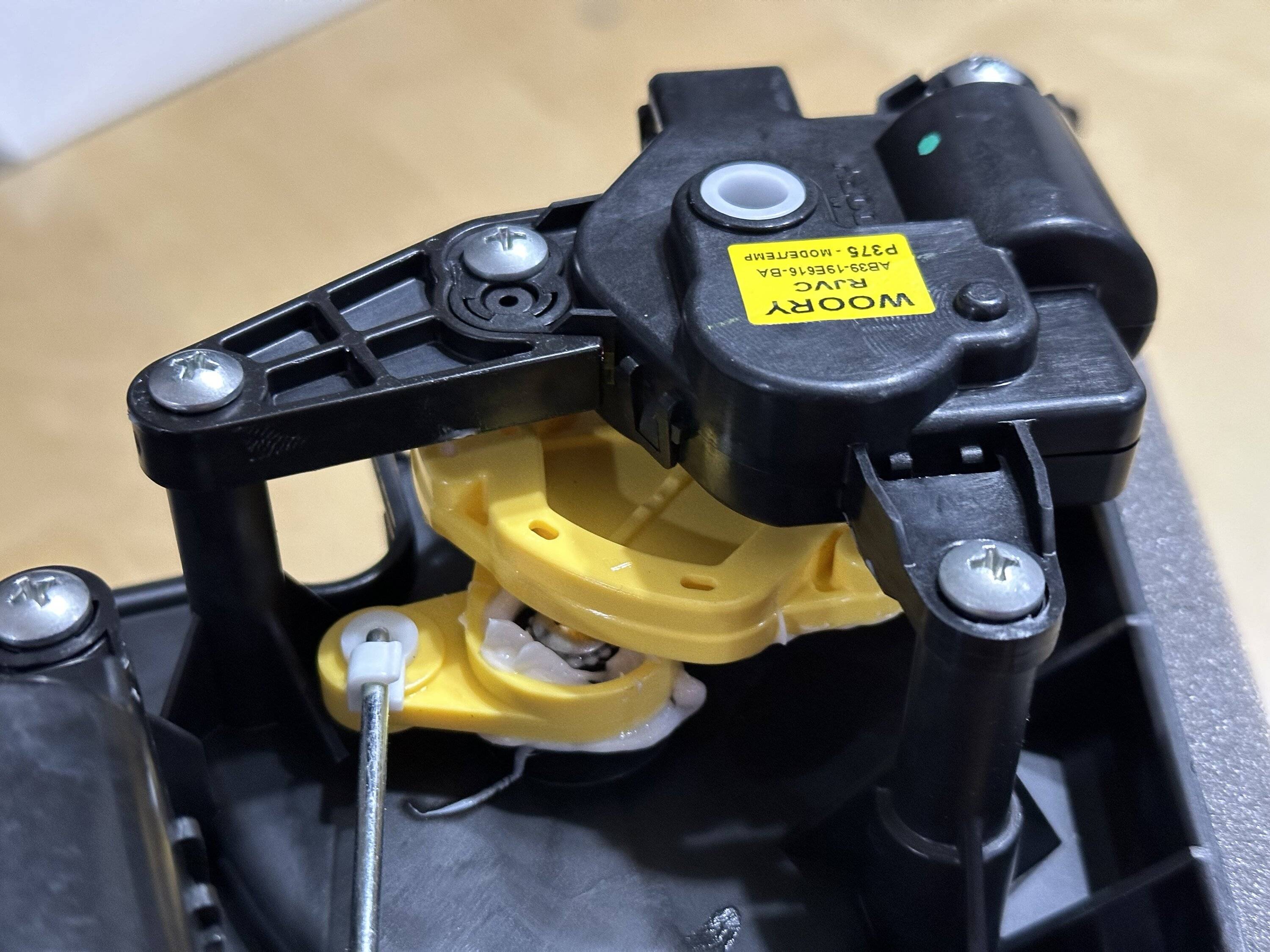

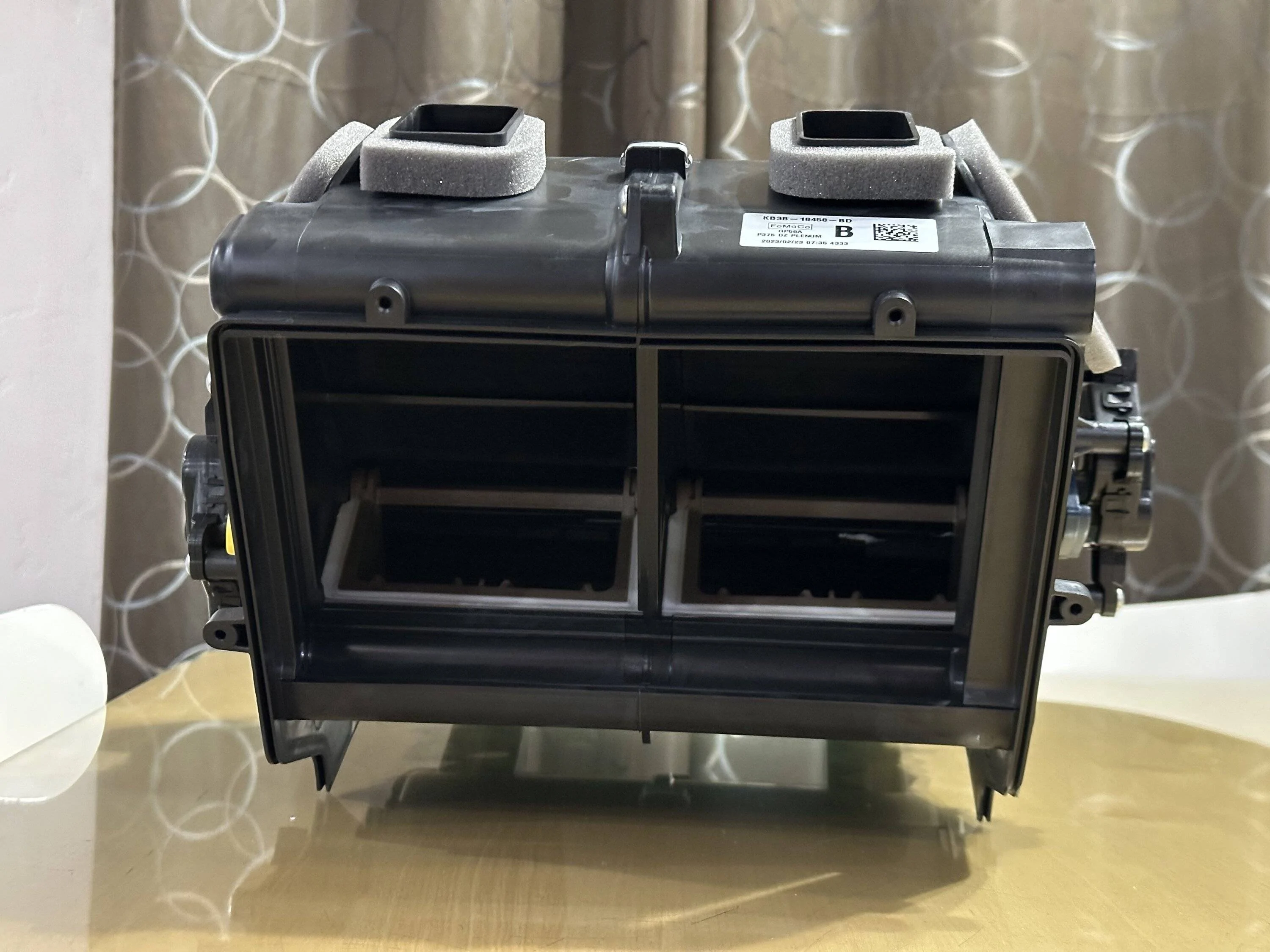

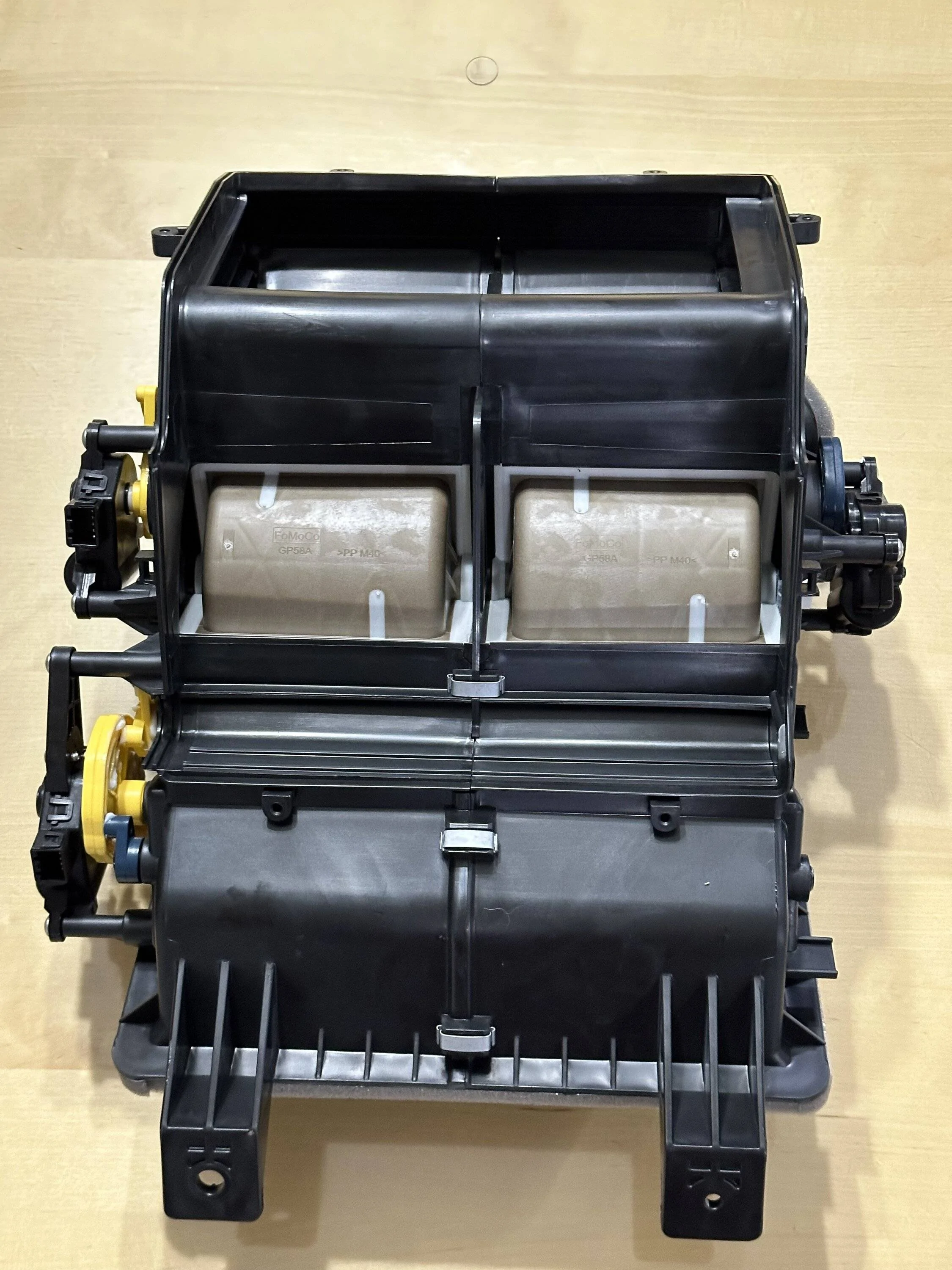

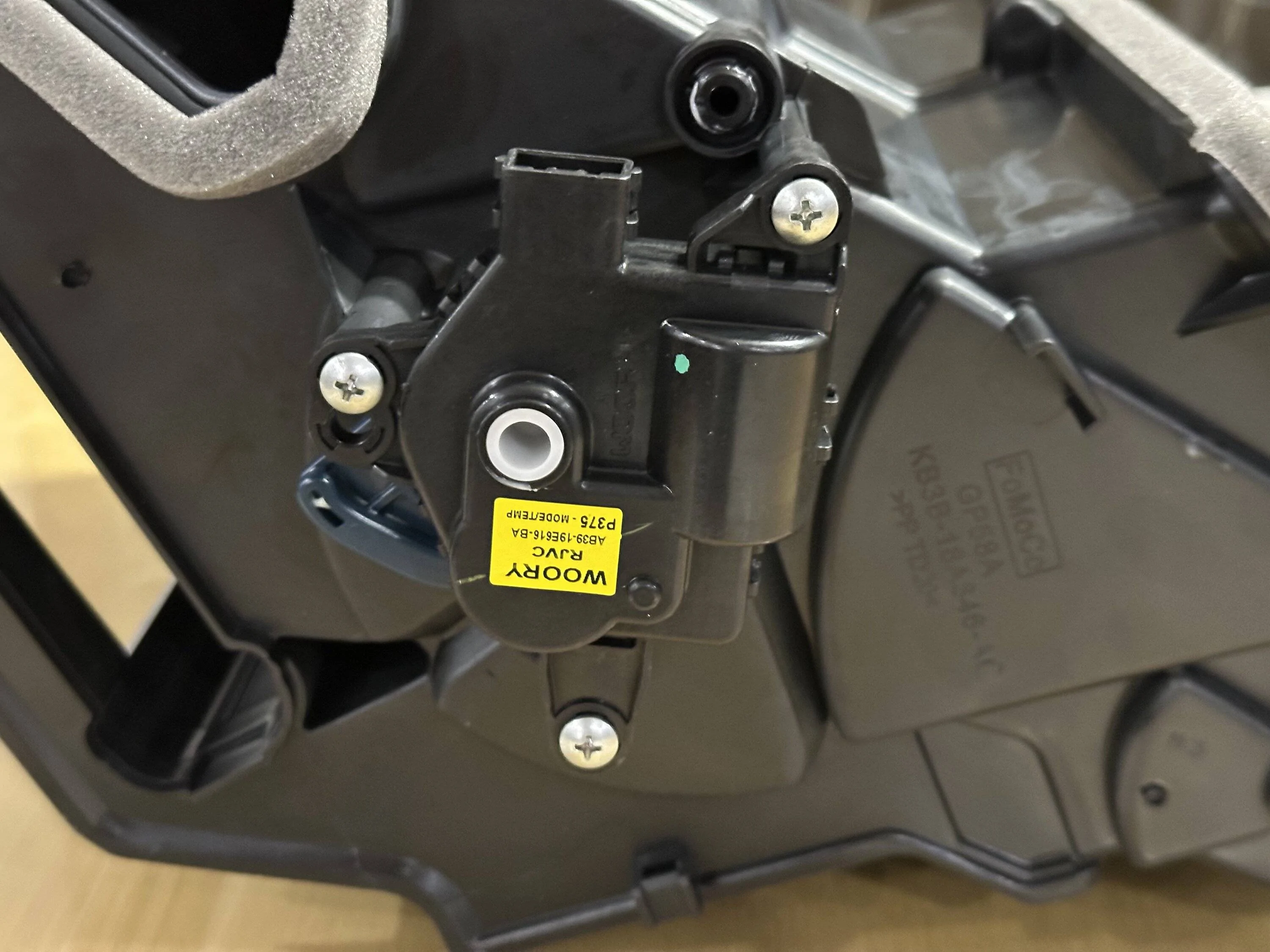

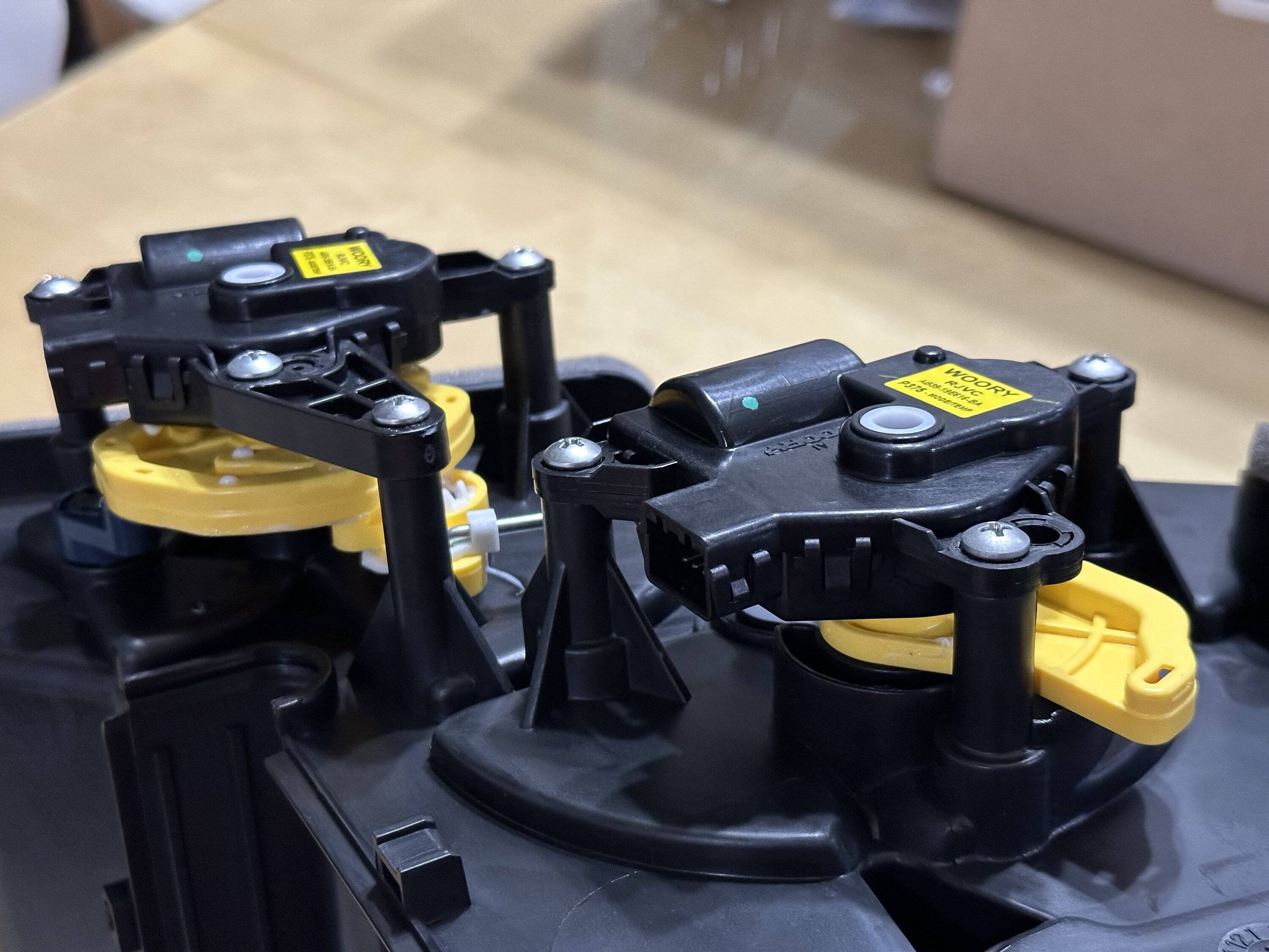

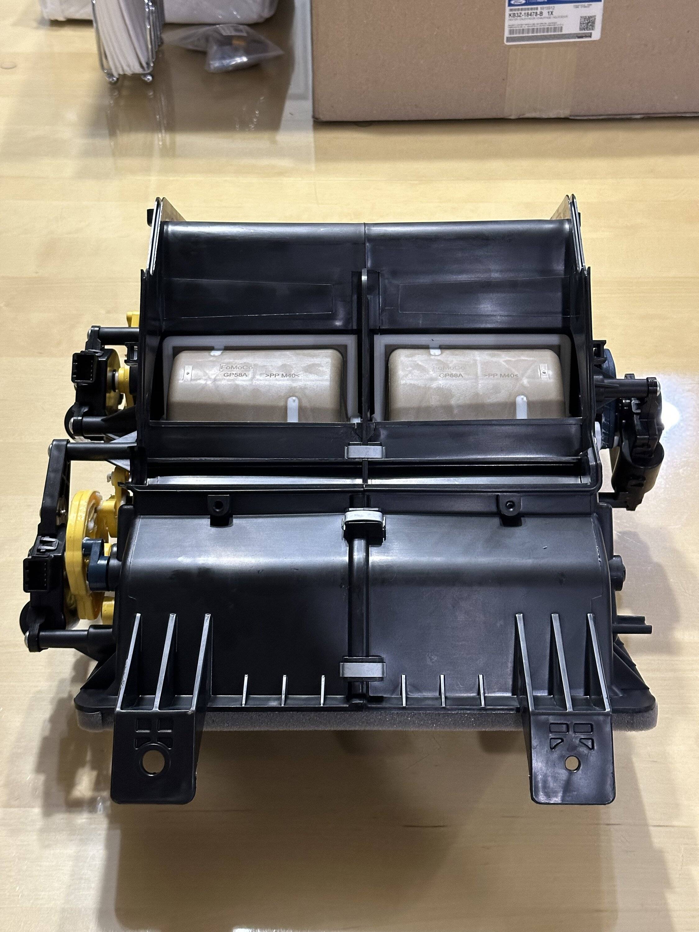

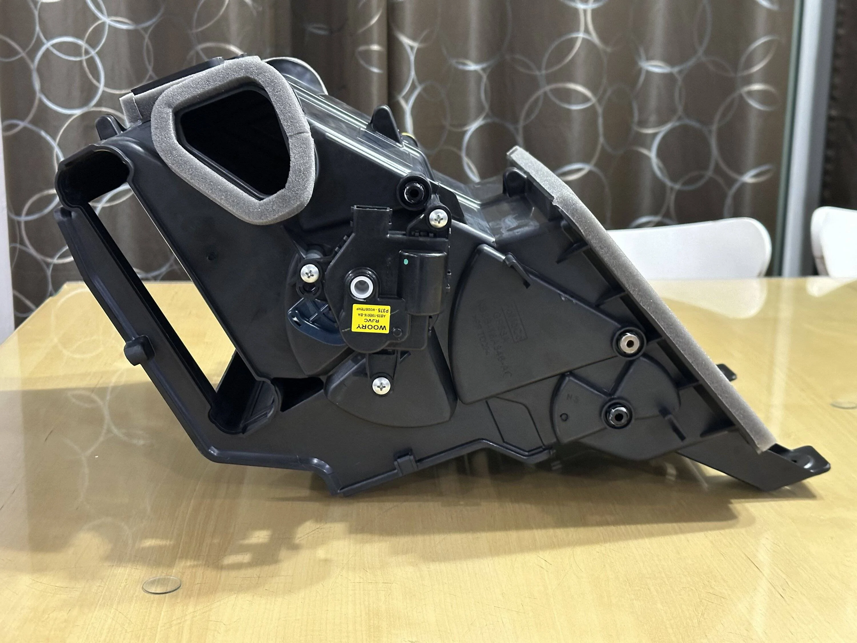

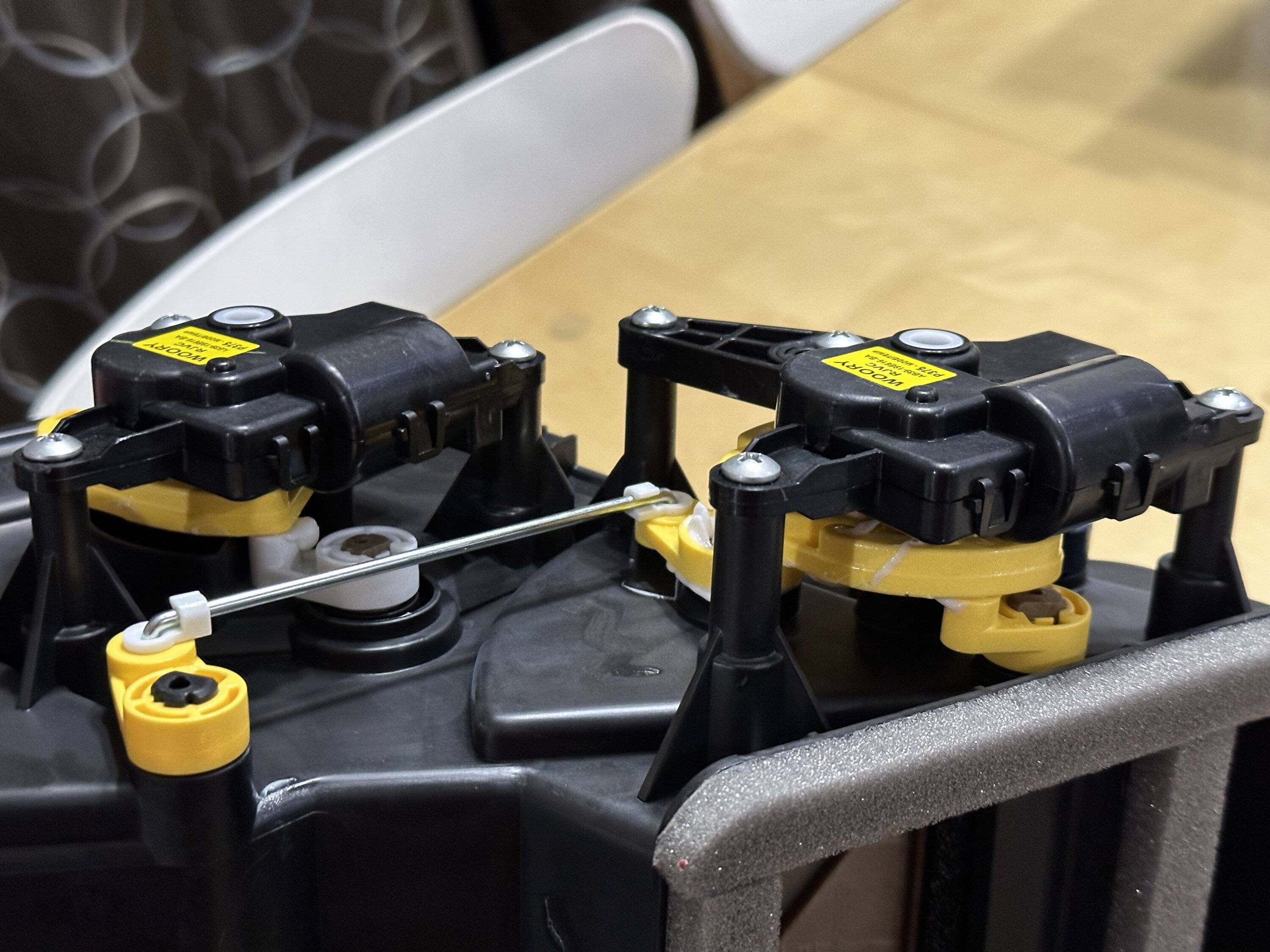

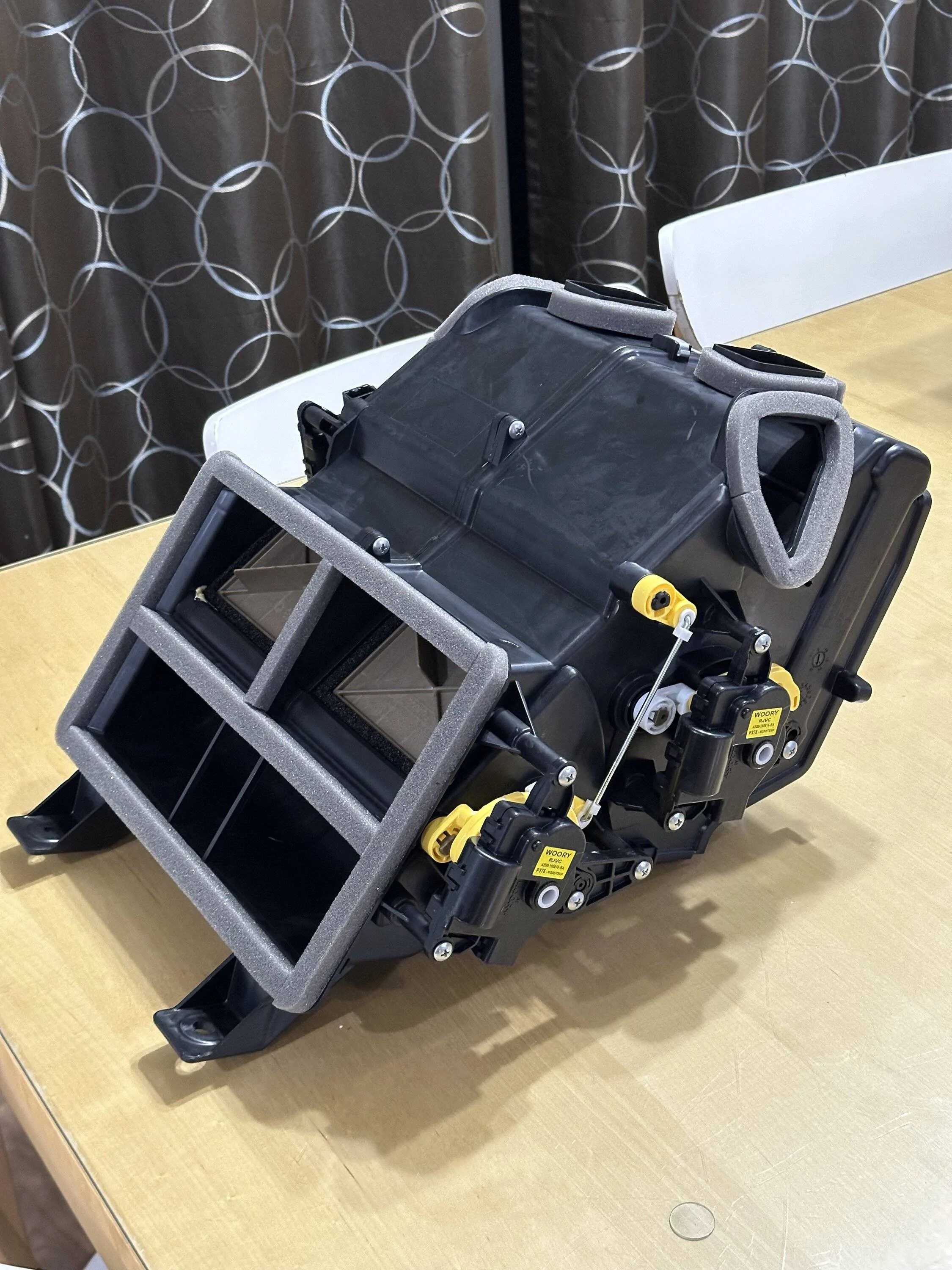

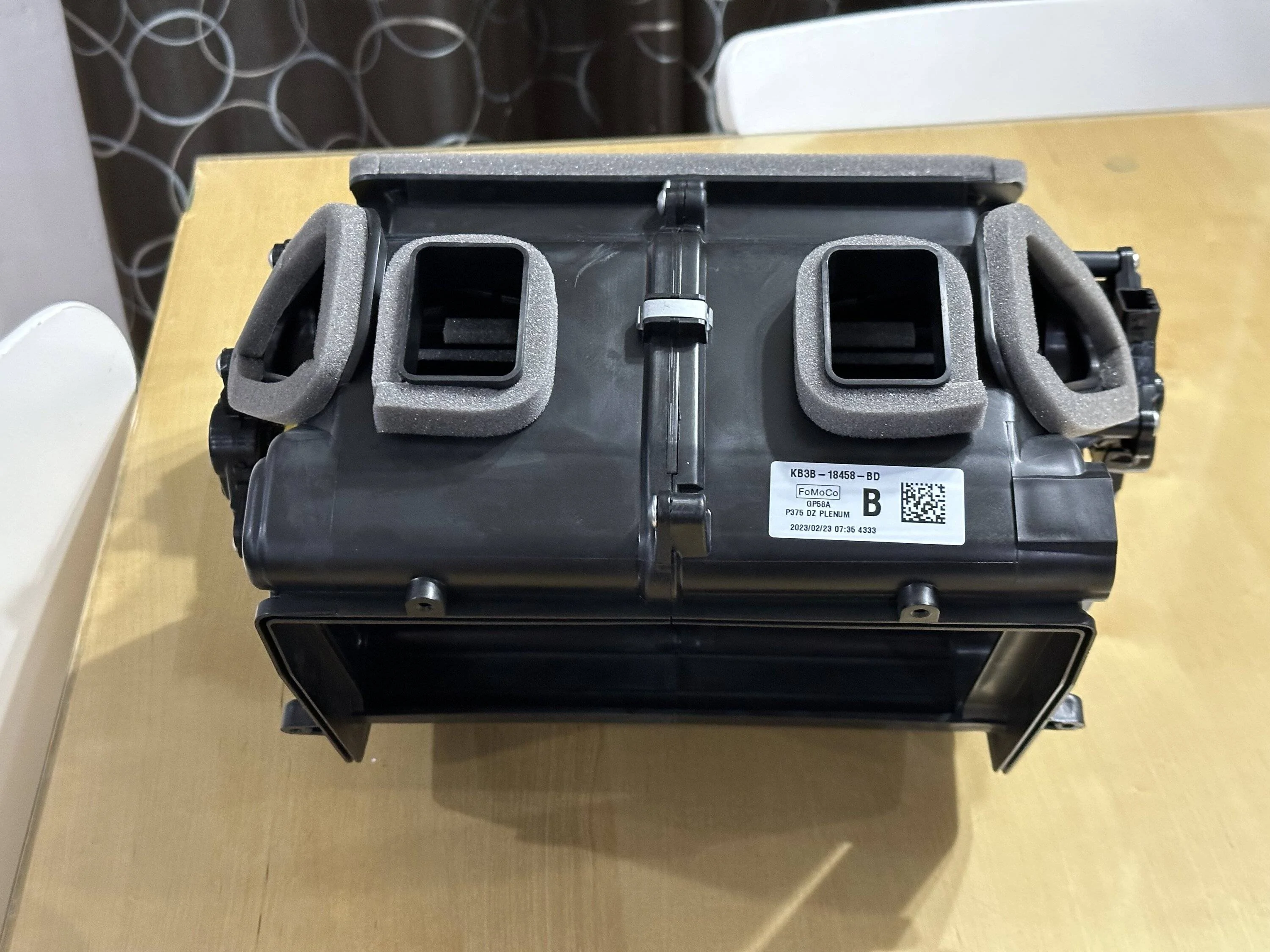

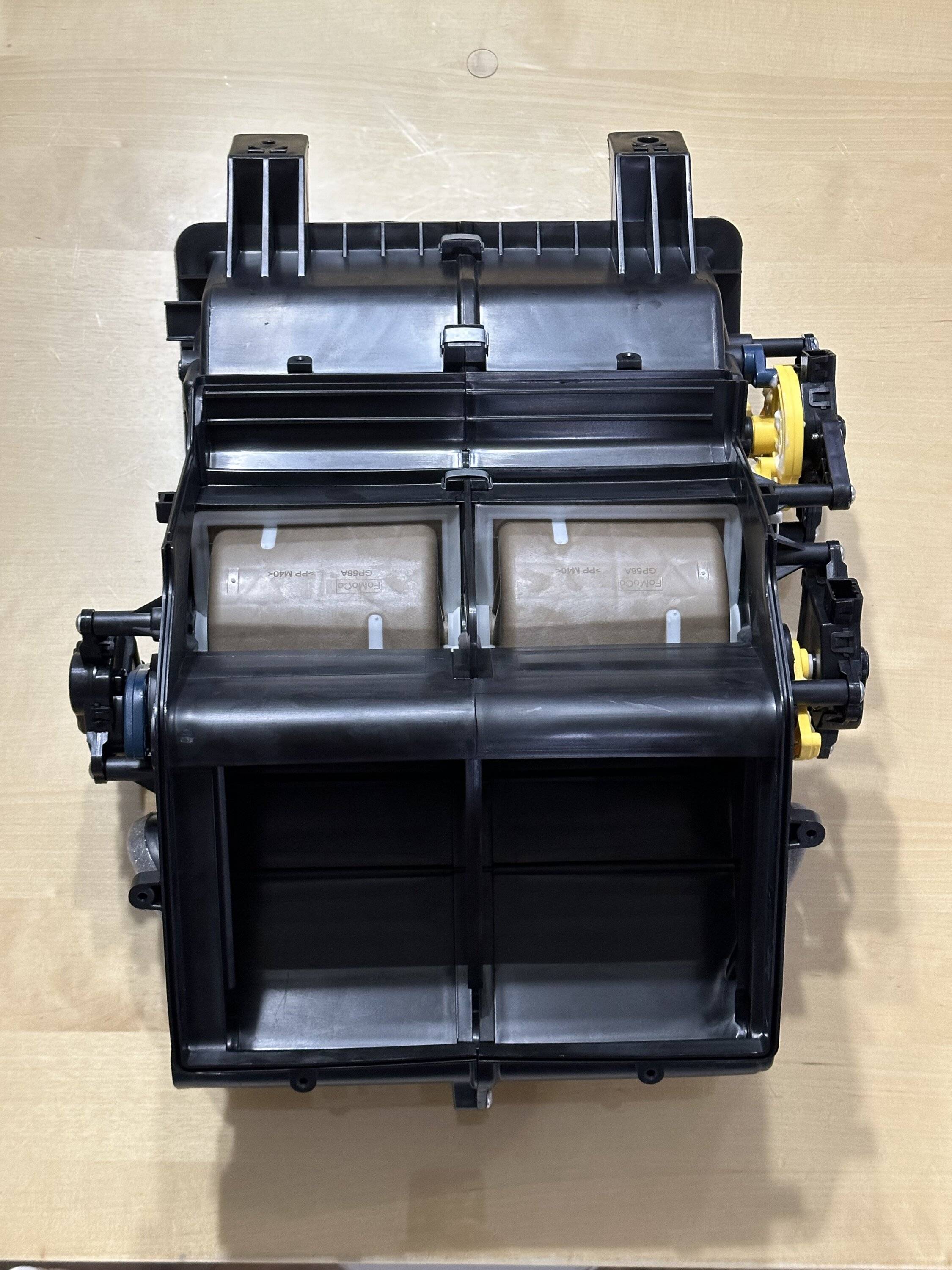

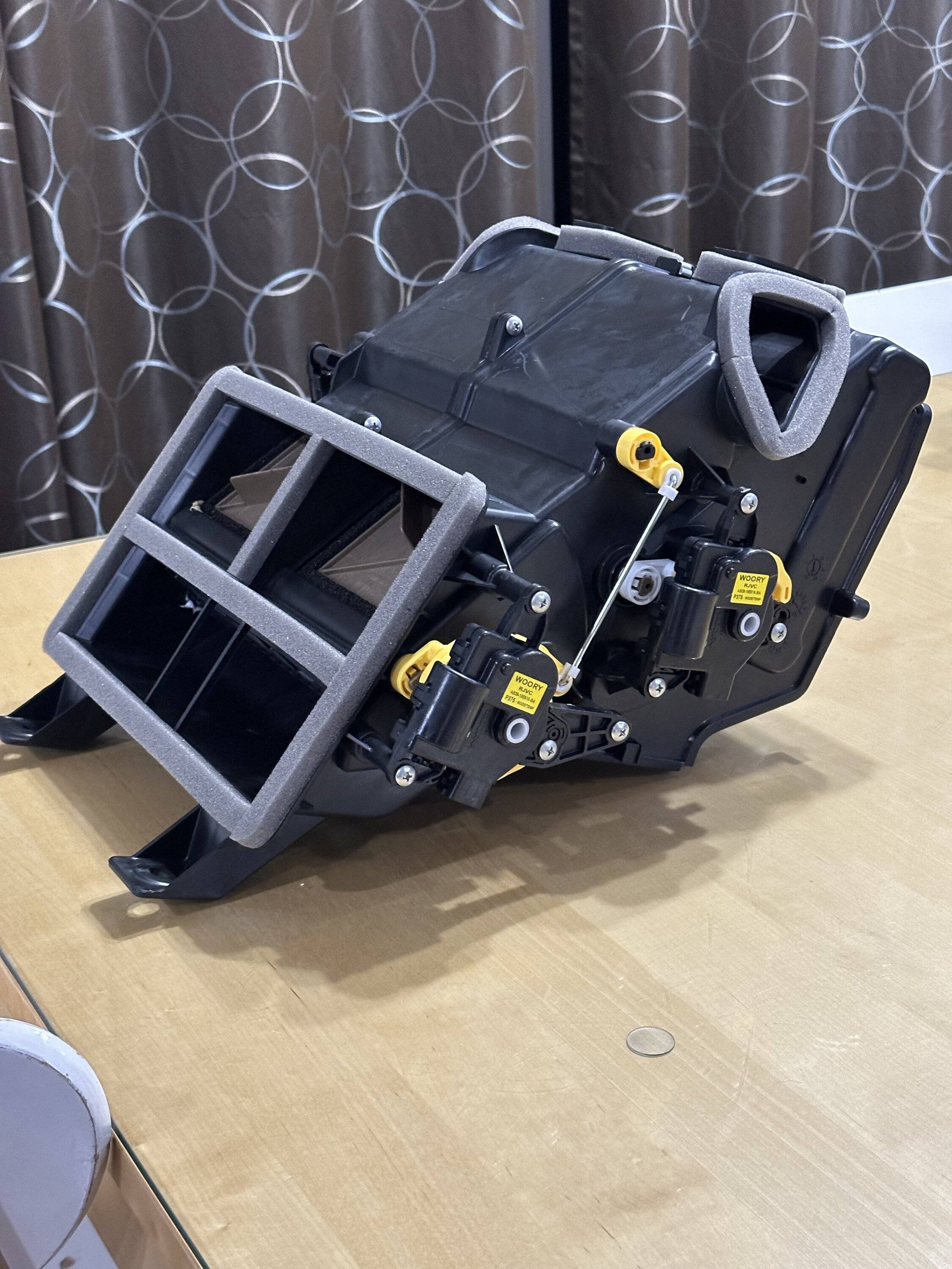

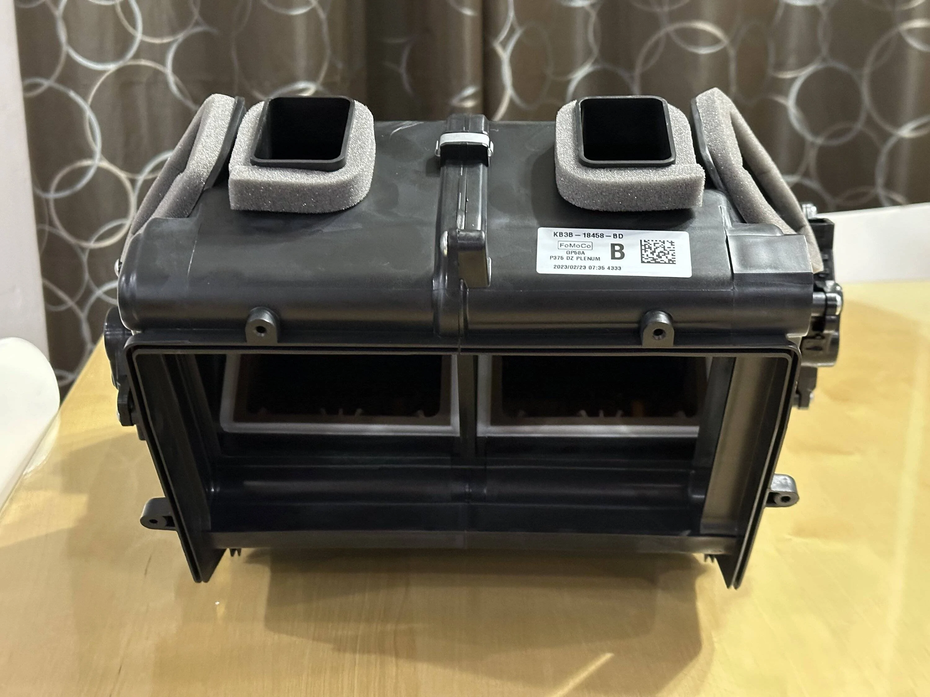

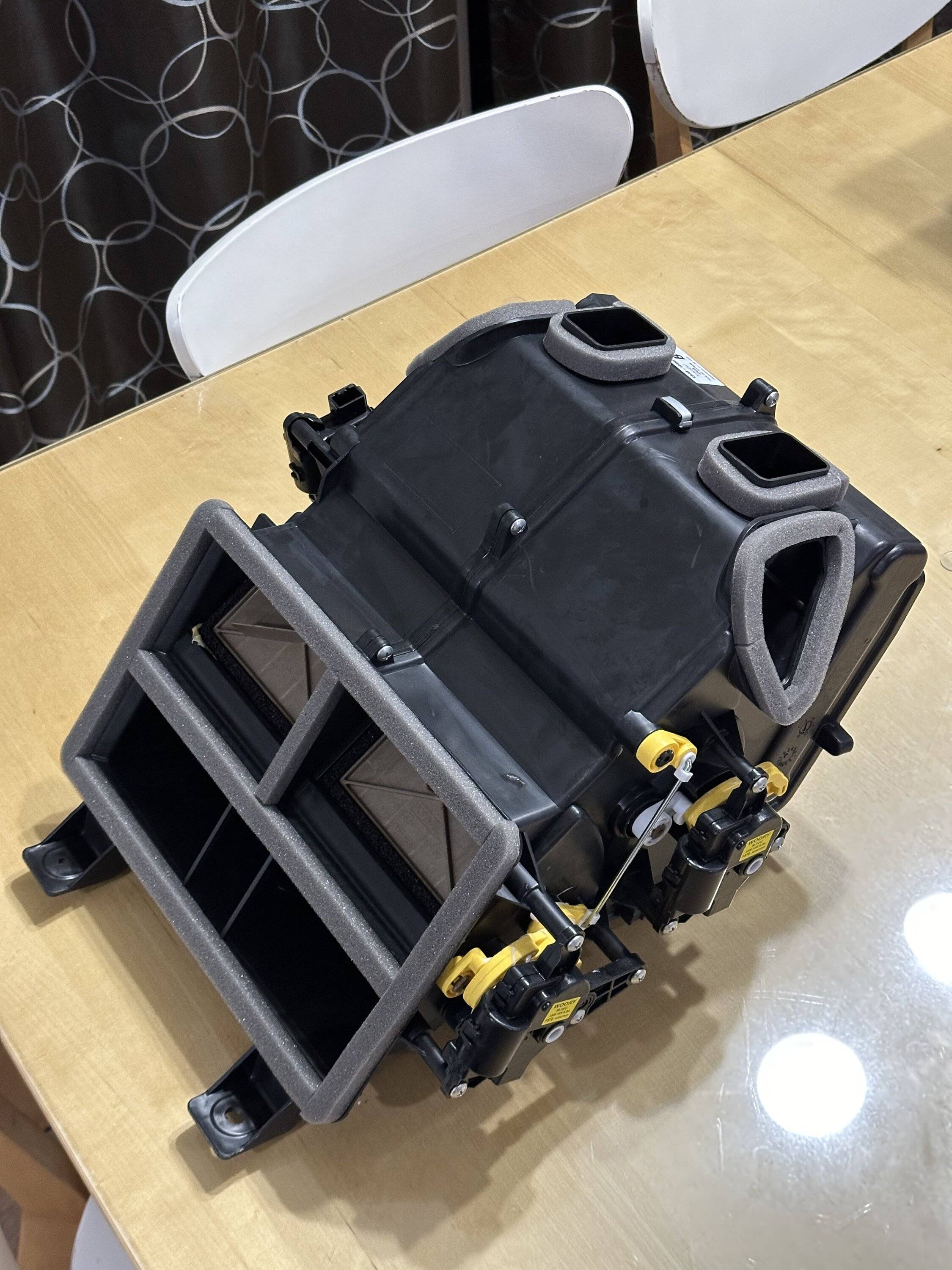

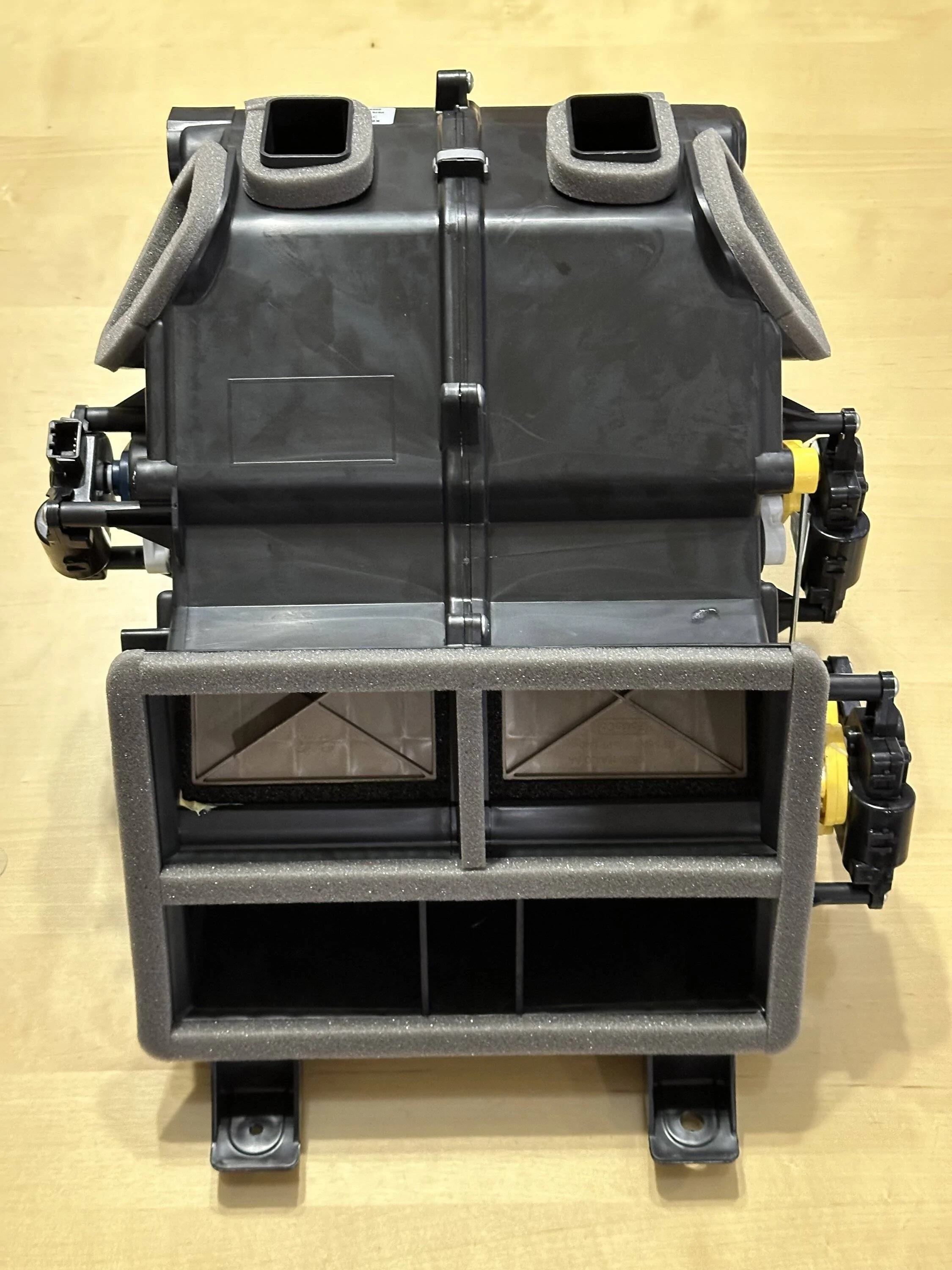

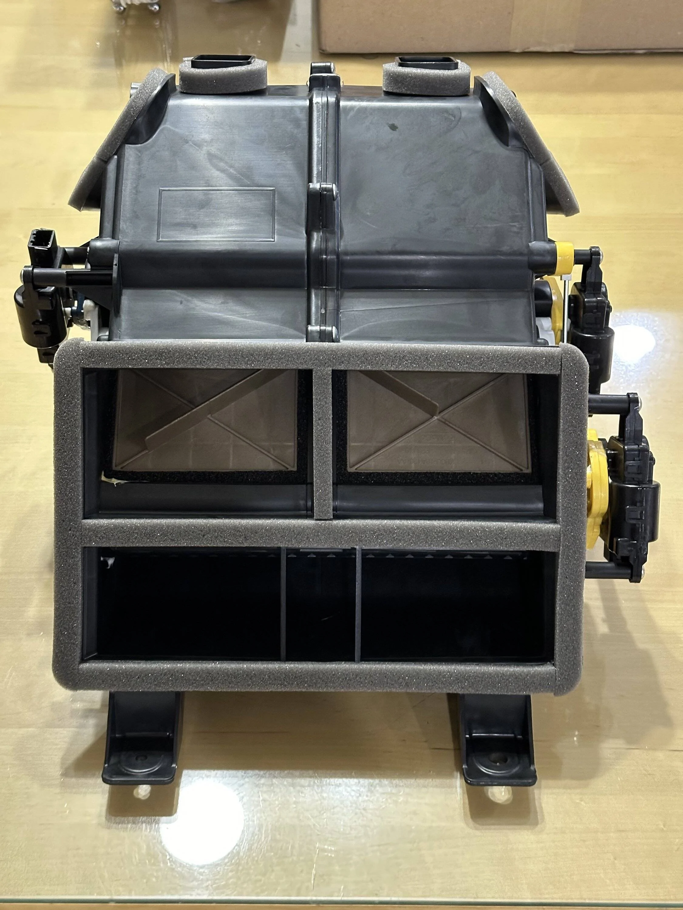

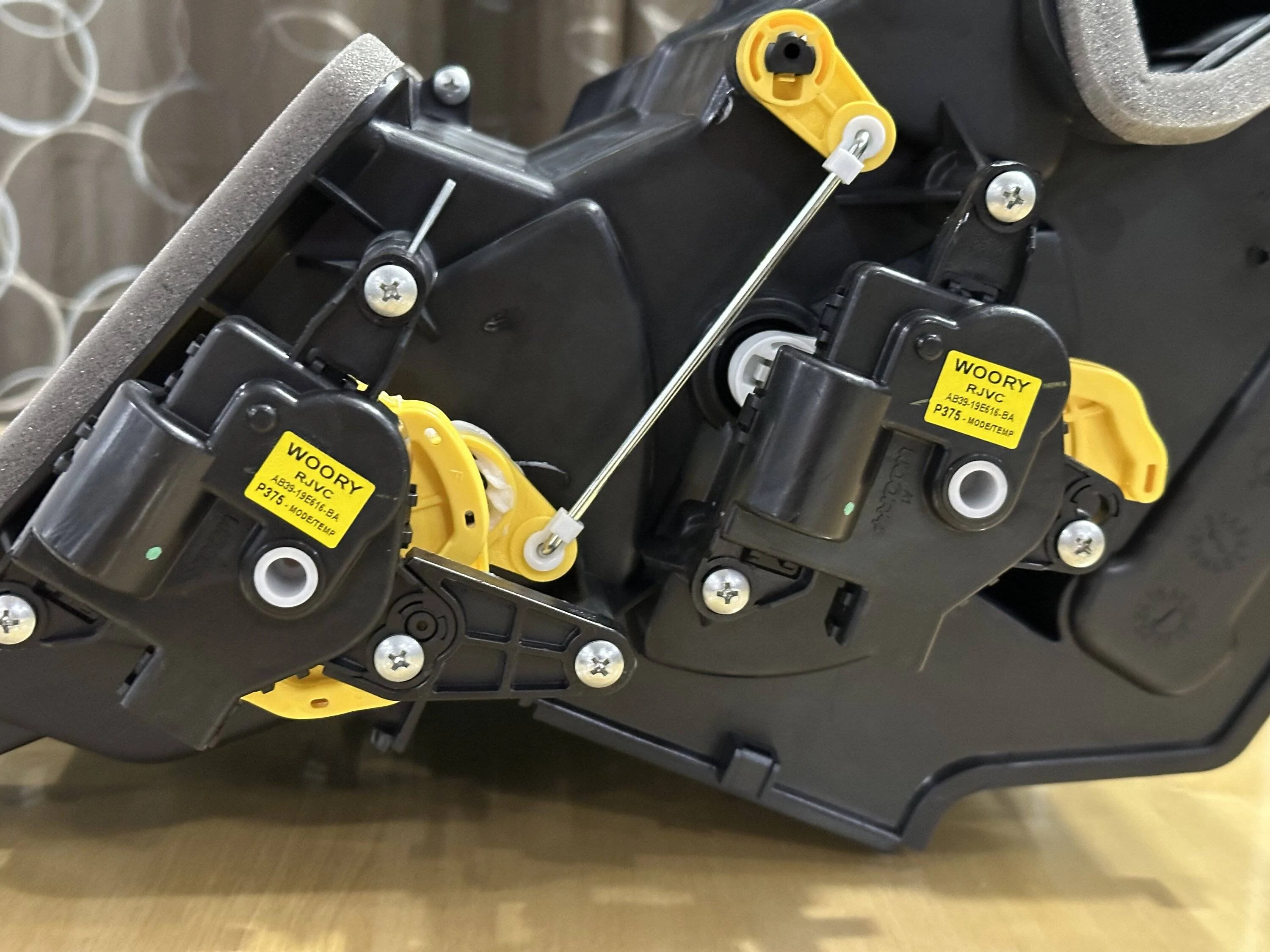

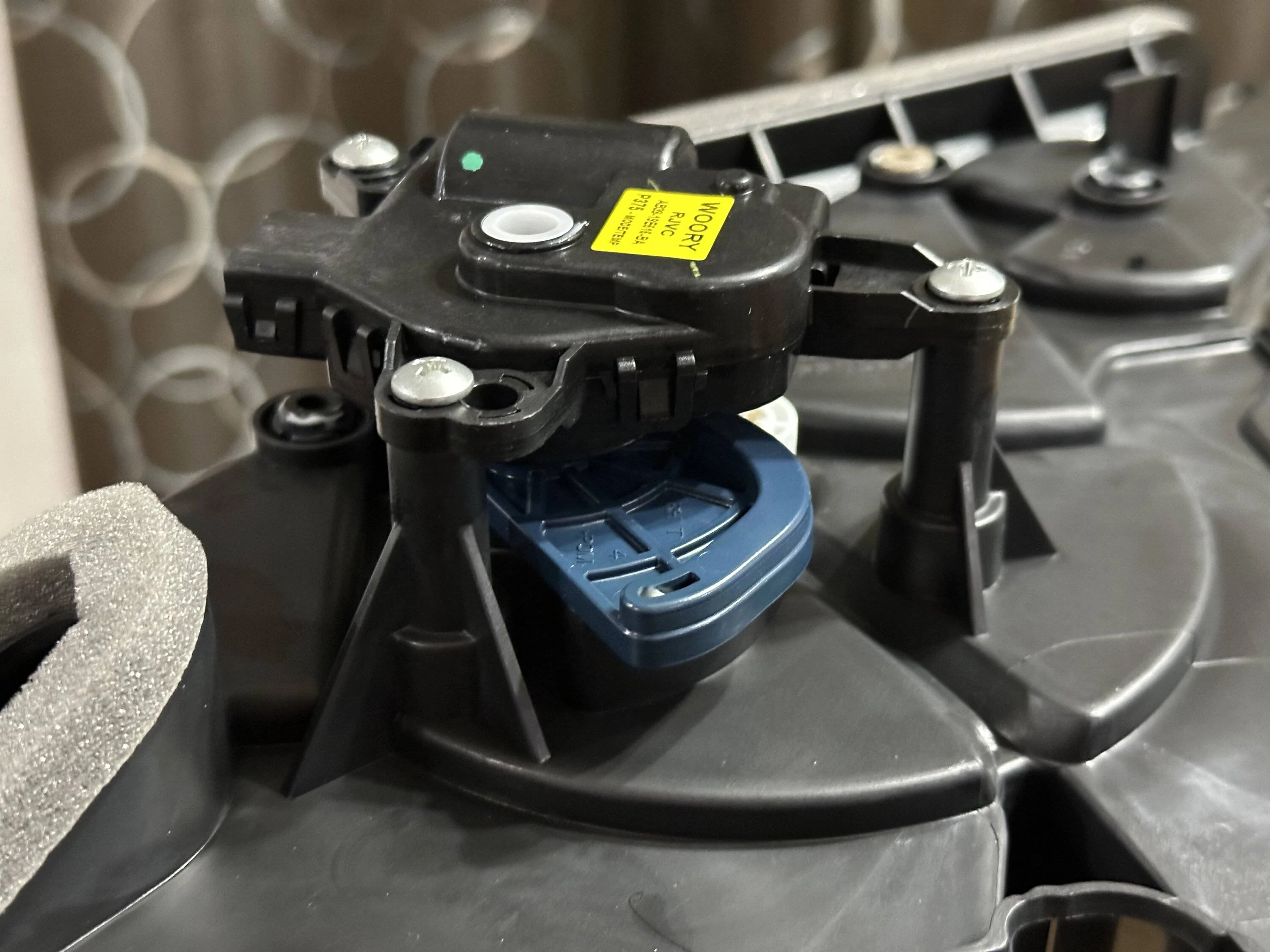

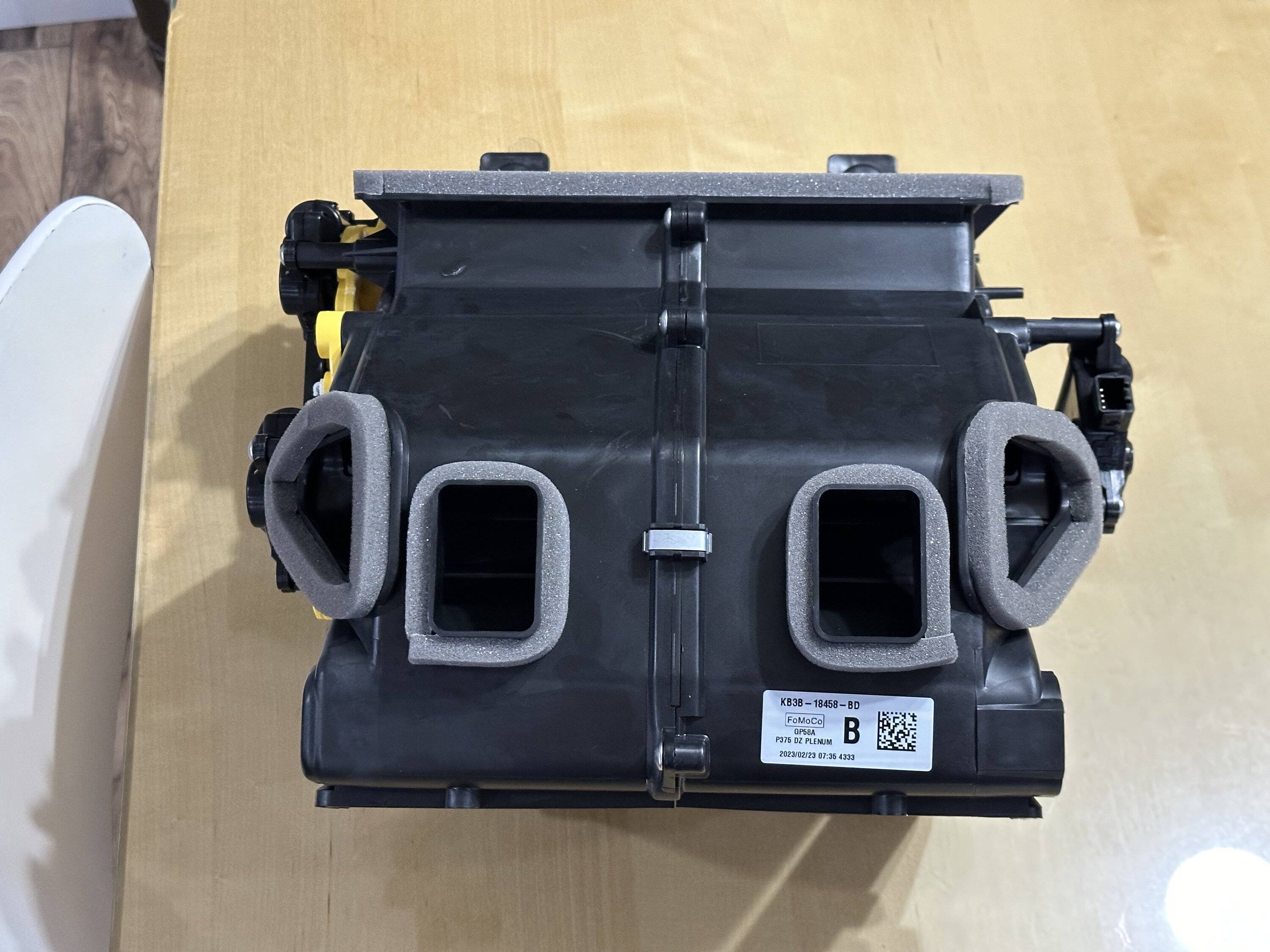

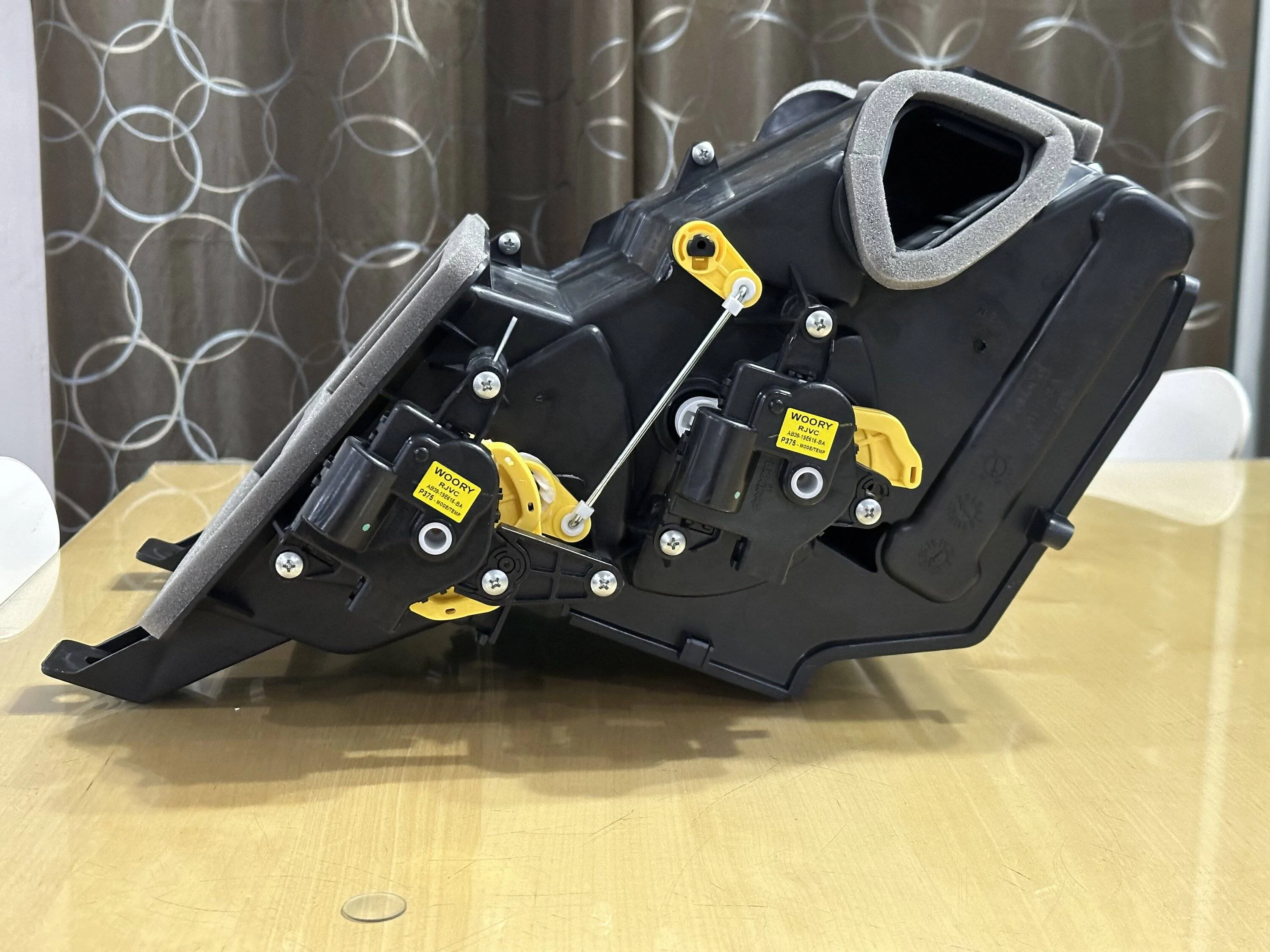

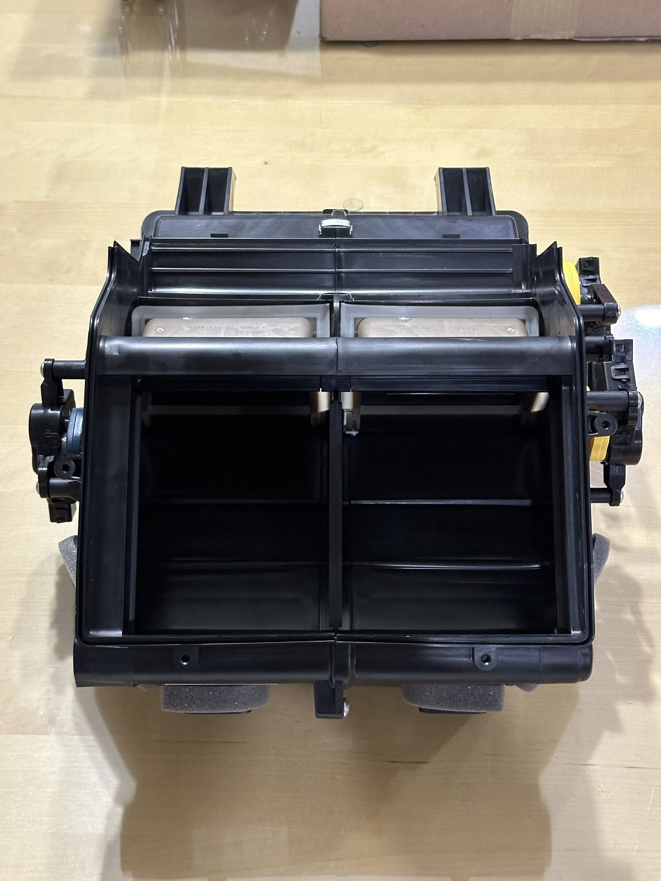

My new heater box arrived yesterday. I'm tied up this weekend with other projects, but am planning to do this replacement next weekend. I took a bunch of photos of the new box last night. It arrived with actuators installed, and all the doors at pre-set positions. I cannot manually change the position of any of the doors without removing actuators, and I'd prefer not to do that on the new one.
Once I have my old one out, I'll be glad to disassemble it however much is needed to get whatever photo and video reference that would still be helpful.
Here are a bunch of detailed photos of the new one:

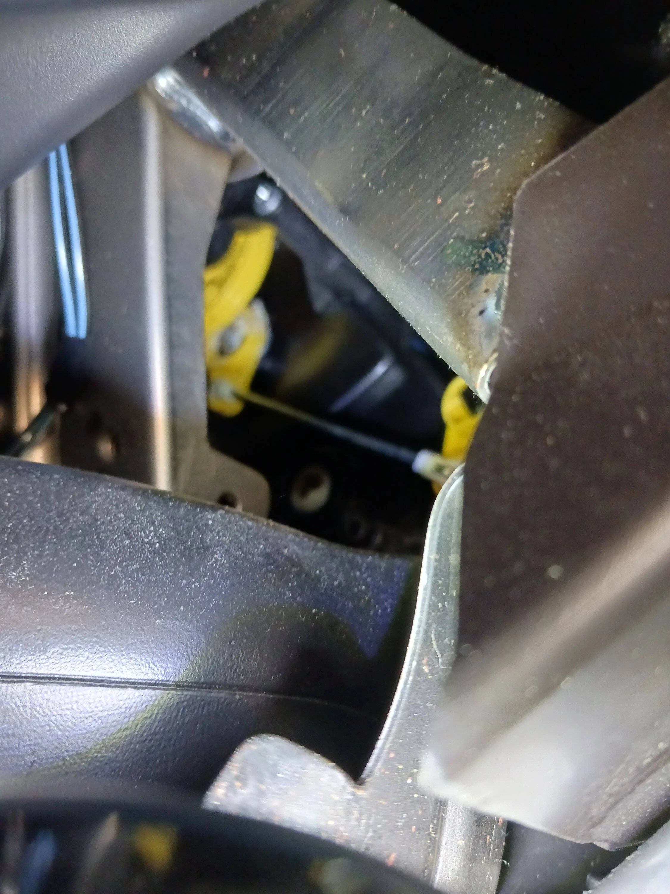

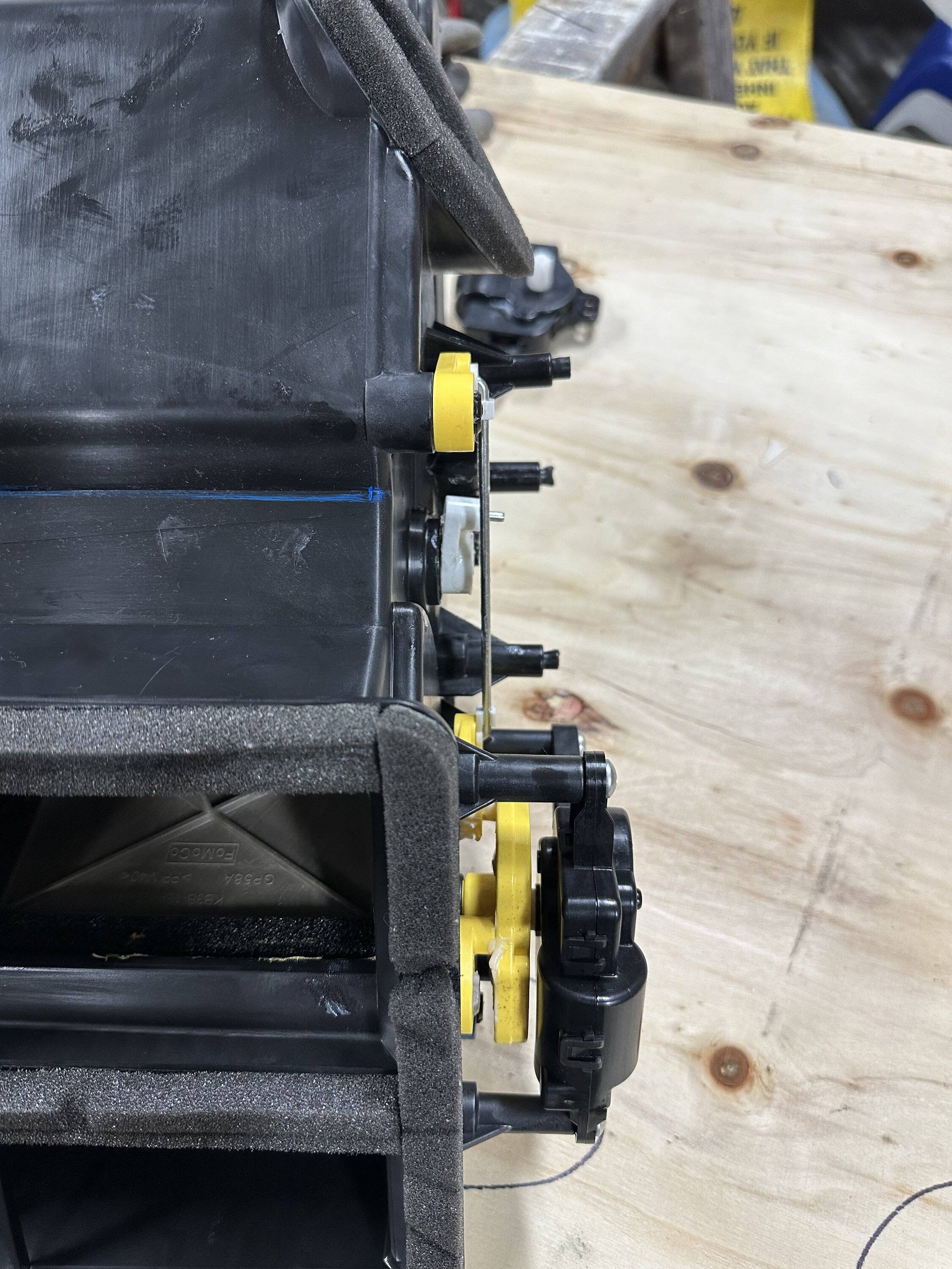

Airline Tech & all others interested. I had to use my truck today to pickup some supplies. I can confirm by make shift cable is functional as I was able to adjust the temp. I took a picture of the drivers side best I could & it appears there is no actuator on the drivers side with manual a/c.
Yep you’re good to go. Be nice if you could find the two screws that face the firewall and exchange them for screws that take a Phillips or socket. Those two were a pain. A lot of hand cramping and cussing. A ratchet would’ve be really nice.
What type of head do those have?
