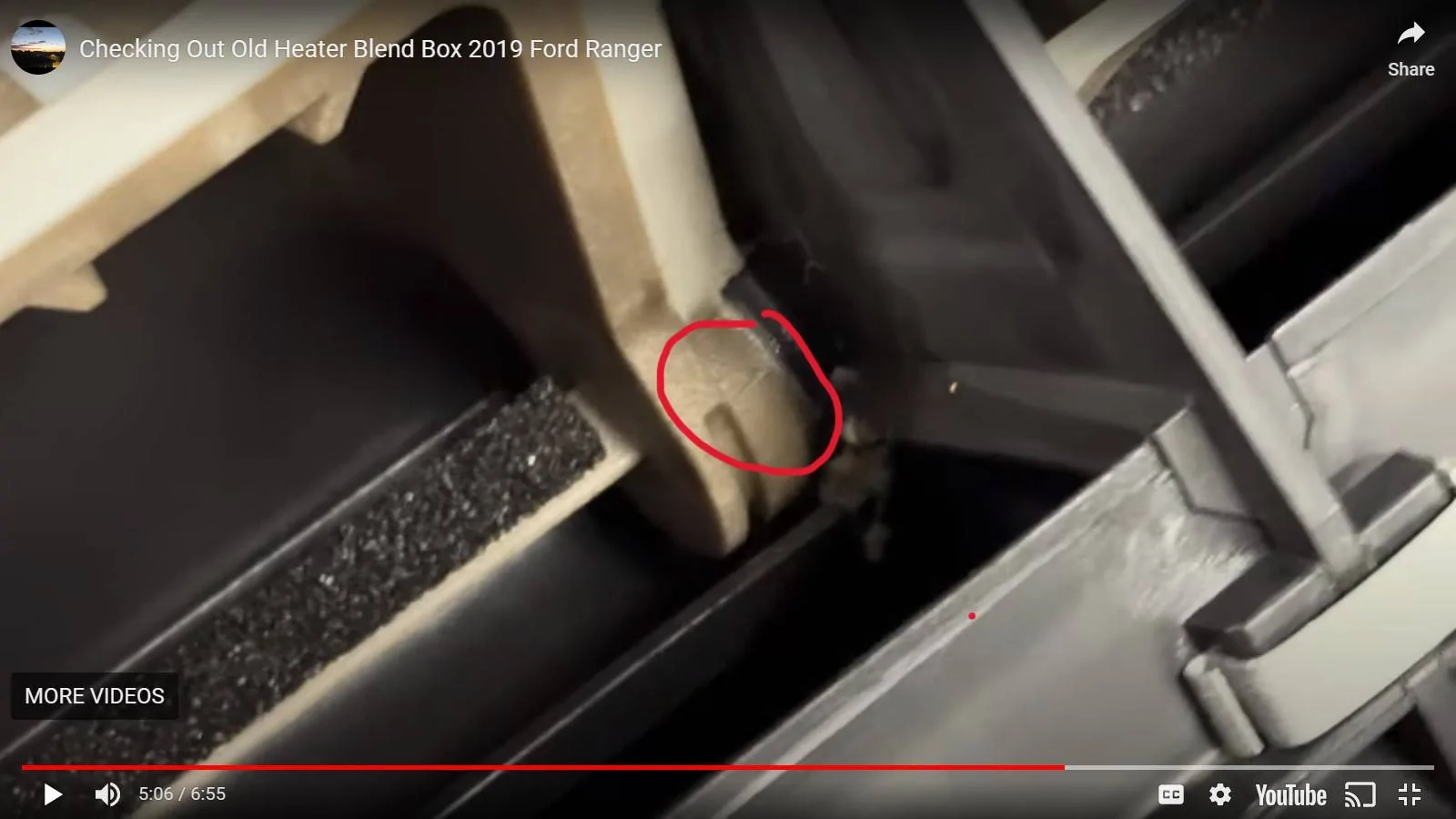

I think this hinge point is worn, it appears to have signs of the hinge hitting the case, when it is rotated to the stop. I would check for any play on that hinge, and this would explain why the passenger door wants to move with the driver's door as its binding and grabbing the shaft.

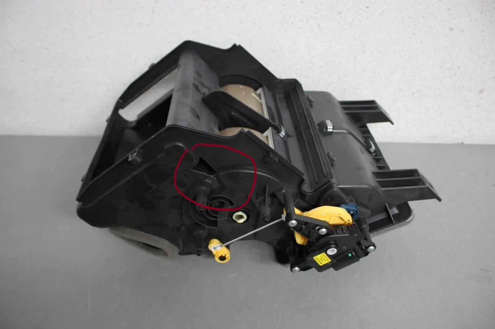

I am thinking that when airflow distribution is - (Not Equal) the airflow is being expelled here.
(Circled)
If in the same scenario as above, Drivers Air - Flowing and Passenger Air - Nothing.
If you dial up the blower motor speed, you can hear the air in the ductwork but no flow.
I would have to check if it is being expelled here when it is in that scenario.
It is something simple in the control of airflow that we are not seeing, and it may be a pressure thing (unequal pressure) in the box that will allow the floor doors (?) to rotate separately. blocking off airflow from traveling up to the top of the box (panel vents)
The unequal pressure is generated by the Temp Doors Positions.
Just Guessing here, to give you a possible idea to look at when moving the doors. ?‍♂
Note:
It is not a failure; I feel it is designed that way for better temperature control, but if a temperature door actuator is failing, this split airflow control may not be work correctly as a result.

That’s not an actual hole. It’s just a cavity. No air can pass. That would be a horrible design that would still allow air to flow and probably make a lot of noise. The actual problem is the driver side blend door not working. A new blend box is required
airline tech
Aug 24, 2022
4,652
8,913
Midwest - KS
Aircraft Tech
Ok , so that’s just a cavity.
The system can provide separate temp outputs , that can easily be seen and understood on how it operates.
But,
It also can provide by design separate airflow outputs, the question is how with only (1) mode door actuator moving the doors for air distribution.
Others have had this issue, no floor on drivers side but floor on the passenger side, or any other mismatch of airflow.
such as panel on drivers side and floor on passenger side.
It ties into the temperature doors and their position. I plan on hooking up my scanner to see door positions by providing a split temperature selection and getting it to split airflow distribution as I think the default 25% increments between mode positions is changing to something mid range of those.

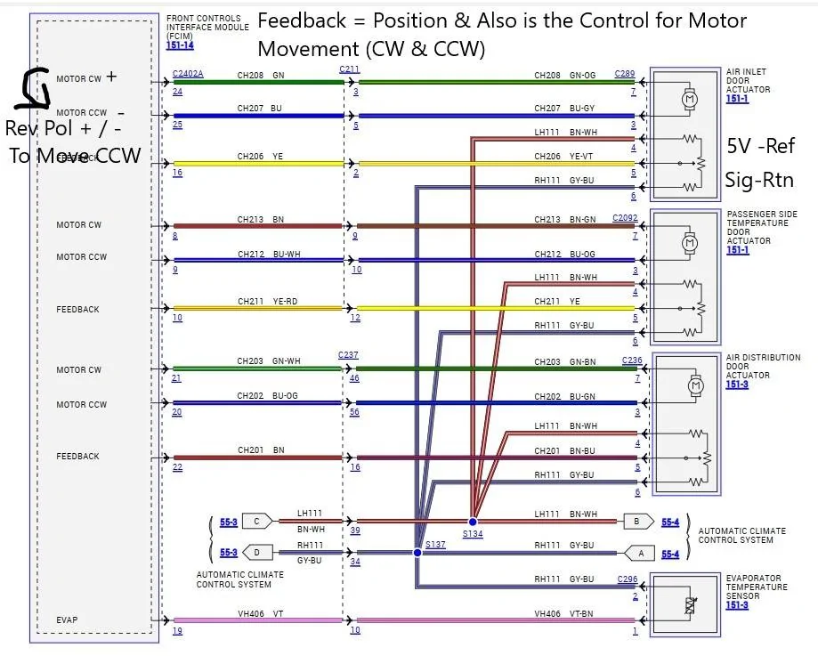

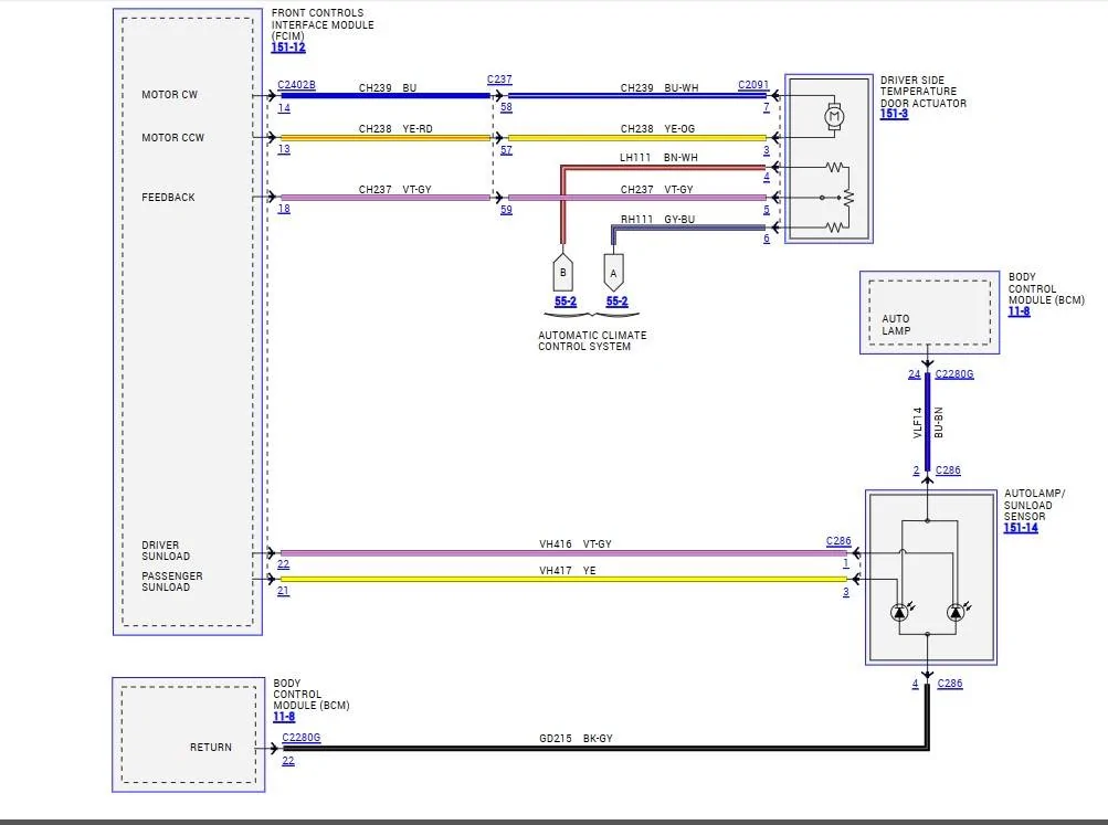

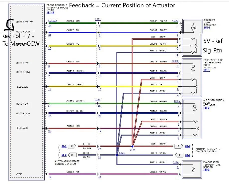

Ok, broke out the Autel and played today
Confirmed Mode Door (airflow position) is only in 25% increments.
In Auto-Mode: (HEAT) as example, since this gets the most complaints.
Temperature Door Positions can alter that airflow when in a split (Dual Climate) Setting
More noted with a Low Blower Motor (Fan Speed), as the air delivery is going to travel the path of least resistance.
In heat mode you are getting the temp doors to open up the Heater Core, if one of the 2 doors is open farther than the other, the side that is opened the most will get the strongest airflow.
If on a (Low) blower motor speed, this will be perceived a (No Airflow)
In Auto Mode:
Mode Position of Airflow is dependent upon selected temp and outside ambient temp, the selected temp is a direct control of the Temp Door Actuator and if the FCIM cannot see that the Temp Door is in Heat then I am thinking that the Mode door also gets lost on where to direct the airflow. (stuck in between a 25% increment)
The Mode Door Actuator, itself has not failed, it just lost valid feedback communication on the 5-Volt reference circuit of the Temp Door Actuator Position (which is the selected temp)

To test my theory on failure mode operation, I used the wiring diagram and a self-induced failure to simulate a Driver's Temp Actuator that has lost its feedback position.
Granted it is not an exact scenario but gave me an indication on how the system would react by disconnecting the Passenger Side Temp Actuator and operating the system.
All of the actuators in the system operate the same.
5-Volt Ref - Feeding the Actuators
5-Volt Ref (Signal Return)
Feedback - Feedback is the internal wiper in the actuators for actual door position.
The FCIM will apply Power on either side of the motor to move it,
It will reverse polarity to move in the CCW direction.
In my self-induced failure mode, I was able to get the Mode Door to occasionally get lost as to where is was to produce the airflow.
I was able to make it get stuck in the 44-49% range, so in between the blend panel / floor & floor mode. (Ref: The normal operation door positions - below)
Again, this is not an exact scenario of a Temp Door position failure, but at least tells me that the temp doors do cause a chain reaction to the Mode Door (Airflow) position. and confirms that any anomaly in that 5-Volt Ref circuit can alter the whole system operation.
