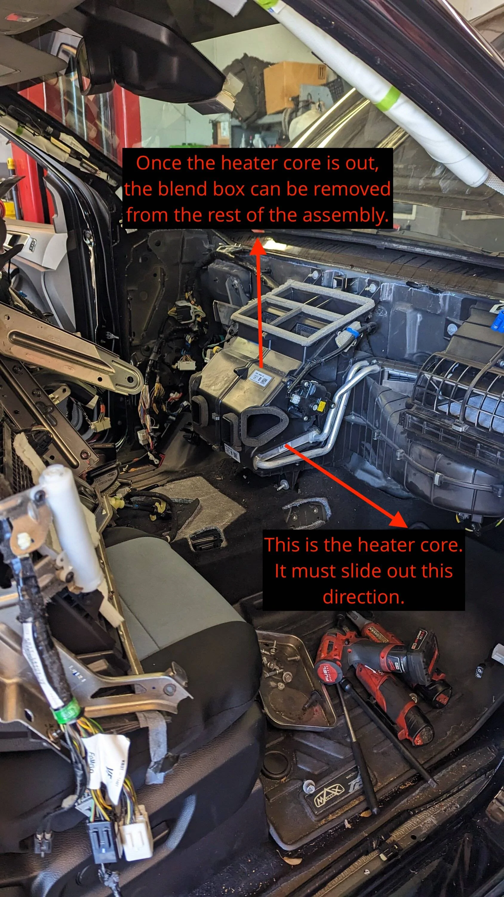

While it is possible to do this without removing the whole assembly, you may have to disconnect the whole assembly to get access to the rear attaching screws (Limited Access)
To allow the assembly to move back far enough off of the firewall to get your hands / tool in that tight area.
It appears you can possibly clear the EVAP Core without disrupting the lines but the Heater Core mounts in the space at the bottom of this part of the assembly, I think this is going to be a road block for a short cut.
It appears the Heater Core will have to slide out of the assembly and out of the way to allow this to raise up and out as it is encased.
Thanks - I just found your **EXCELLENT** write up with all the theory of operation and explanation of all the airflow paths... and I gotta say you are a goldmine of info.
I'm totally comfortable with draining the coolant (probably time for it anyway) to remove the heater core. I'd prefer not to have to also evac the refrigerant, simply because of the cost of recharging the system... but if it must be evac'd to get access to the fasteners, so be it.
Based on your description though, it sounds like the AC evaporator likely can stay in place, but the heater core will need to come out, which would be just fine with me.
(This is how I understand things will be - please correct me if I'm wrong).

Yes that appears to be correct, it looks like fairly easy screw access except for the 2 screws in the back
The 2 side tabs appear to be spring clips that hold the mount points together

Just did the replacement of the blend box. Didn’t touch the heater core or anything else, only the blend box. You can pull the blend box toward the drivers side and it will come out. The two screws facing the fire wall did take some time but they’re reachable with a stubby screwdriver.
I bought the blend box online for $230 shipped.
couple of tips. Move seats back before unhooking battery. Move shifter to neutral so the trim piece will come off. The single bolt on the dash by the window doesn’t need to come all the way out.
there’s a YouTube video of a guy doing this job that really helped. Just ignore the ac and heater core part.

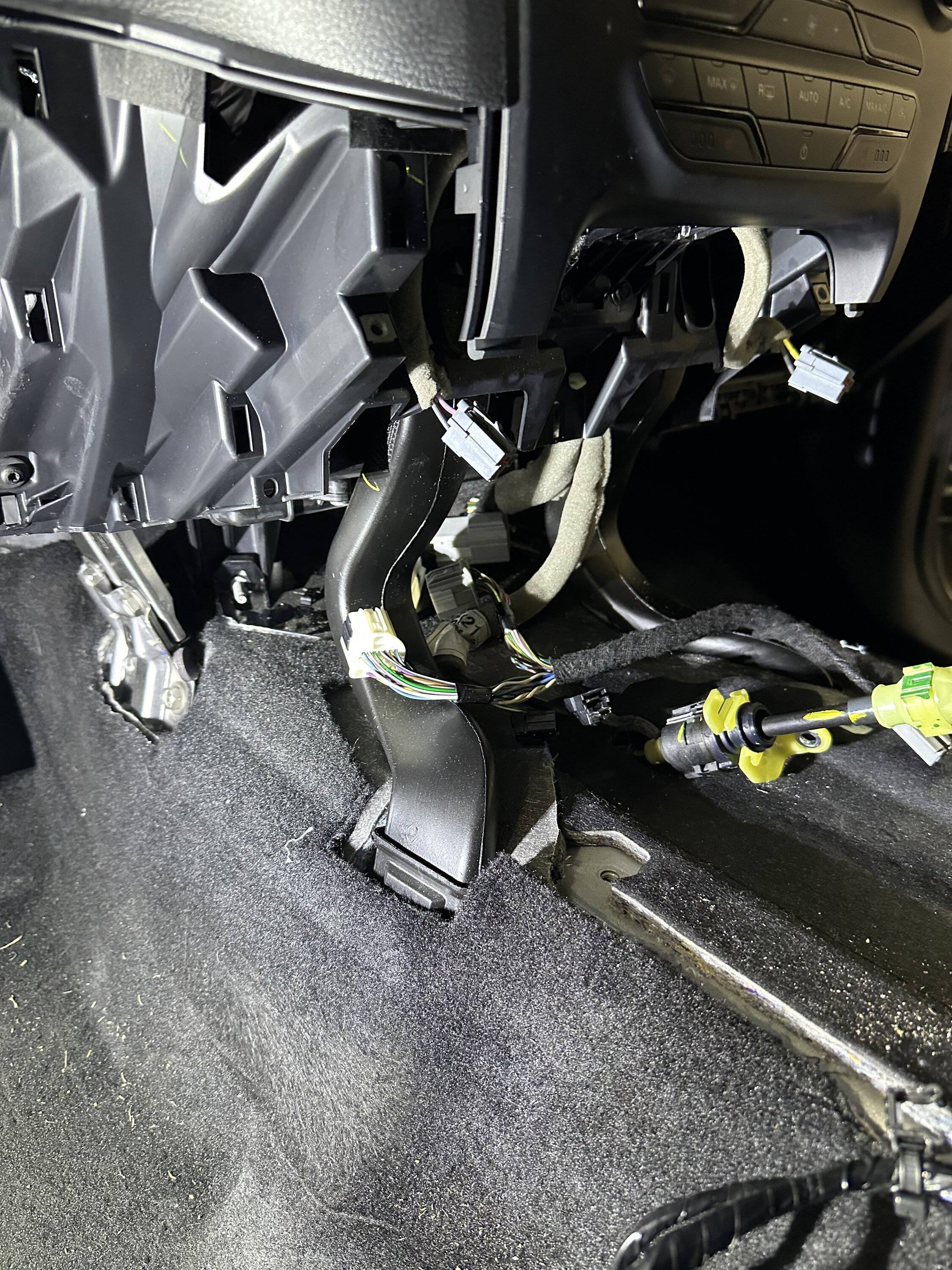

When putting the dash back you’ll see two tabs on the brackets on the transmission tunnel. The brackets have 4 screws, just remove the top two. When you put those tabs in the holes the dash will swing up towards the fire wall. Goes right in.
sorry about the picture. It’s the silver bracket to the left
