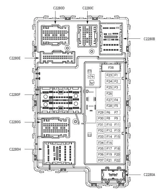

BCM Connectors related to the PATs antennas to pick up that the FOB is in the Truck
C2280E
C2280G
Disconnect and Reconnect these, to ensure properly latched.
C2280E
C2280G

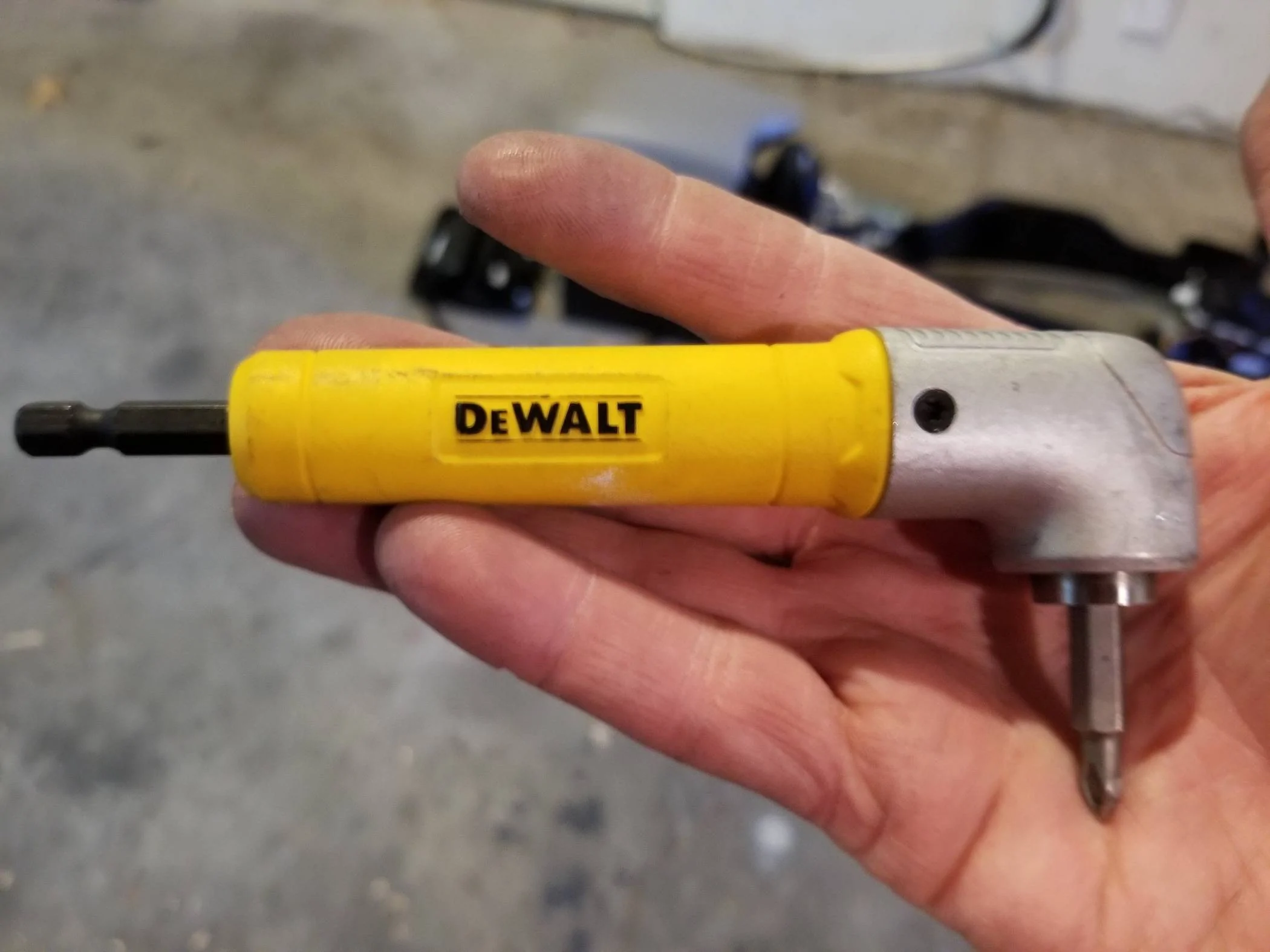

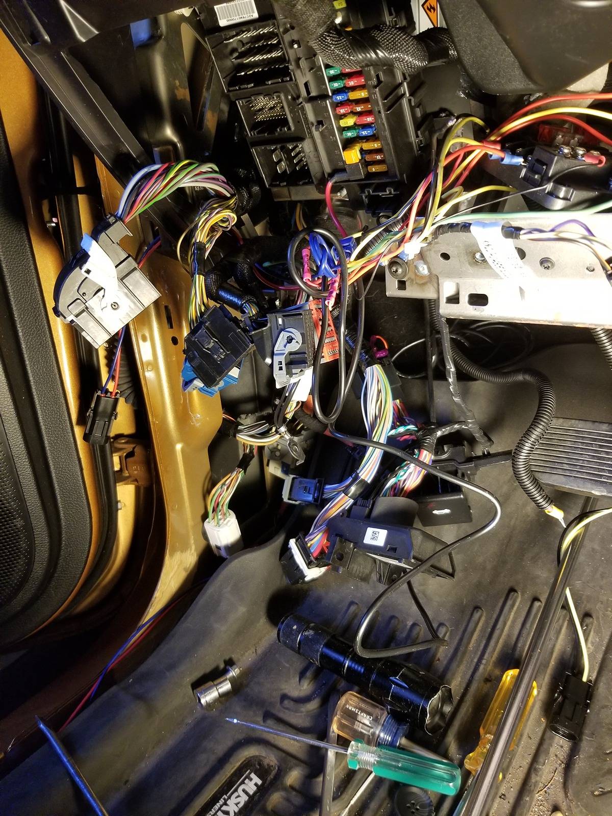

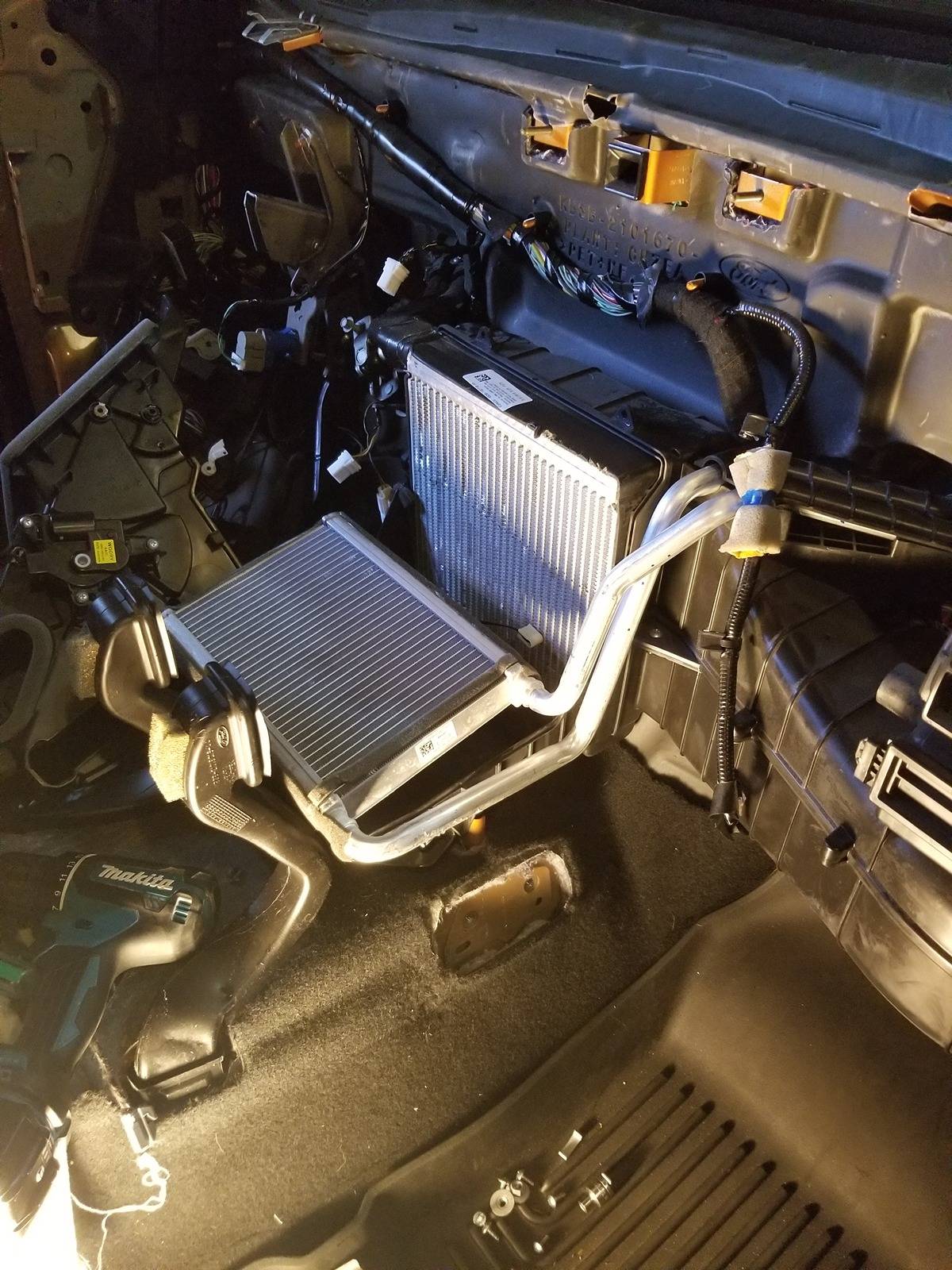

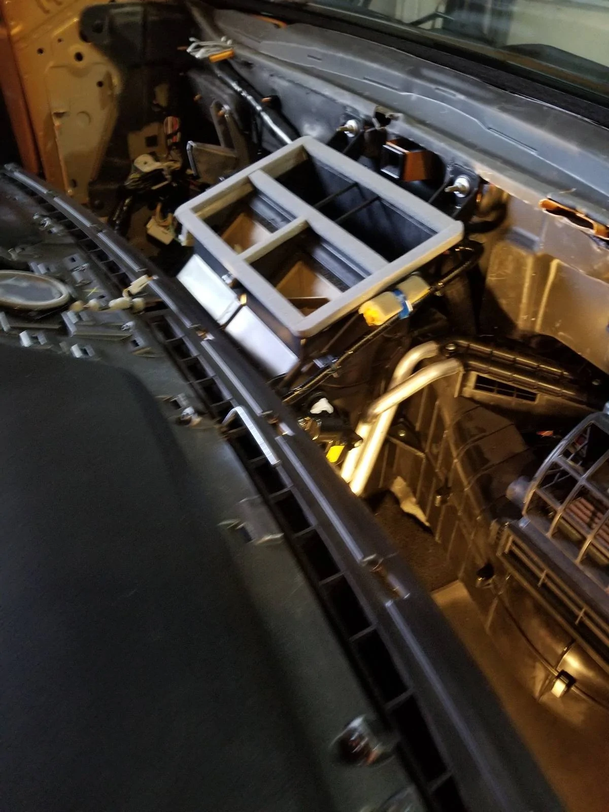

Pics from the project:
Box replaced, ready to replace dash
This is a lifesaver for removing/replacing the back screws
All of the looms from the fuse box removed
Box removed exposing heater core
I removed the front seats which makes it much easier to move the dash around since I was by myself.

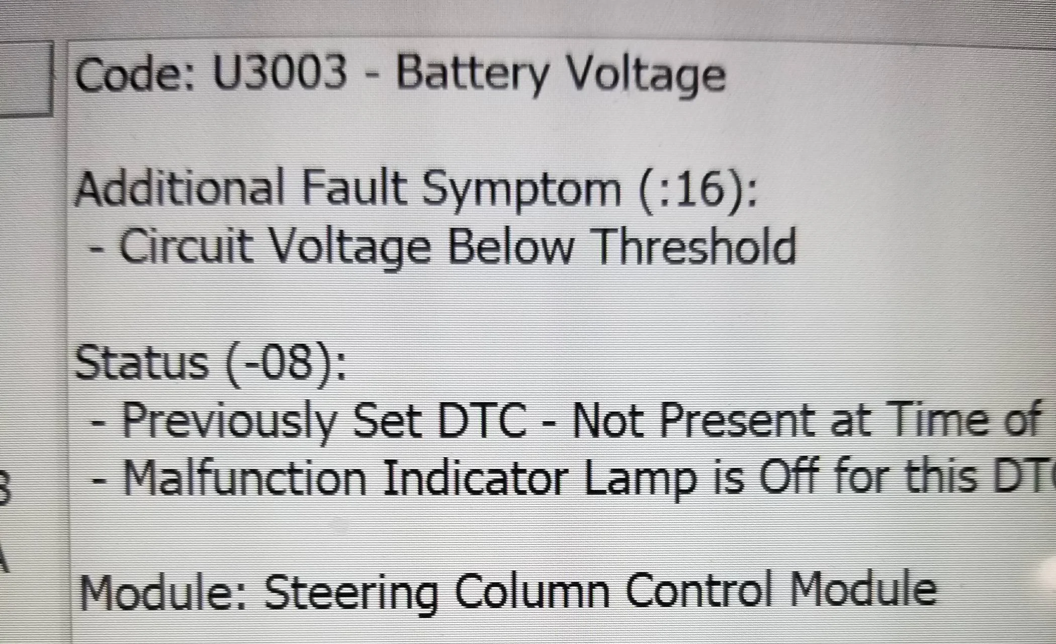

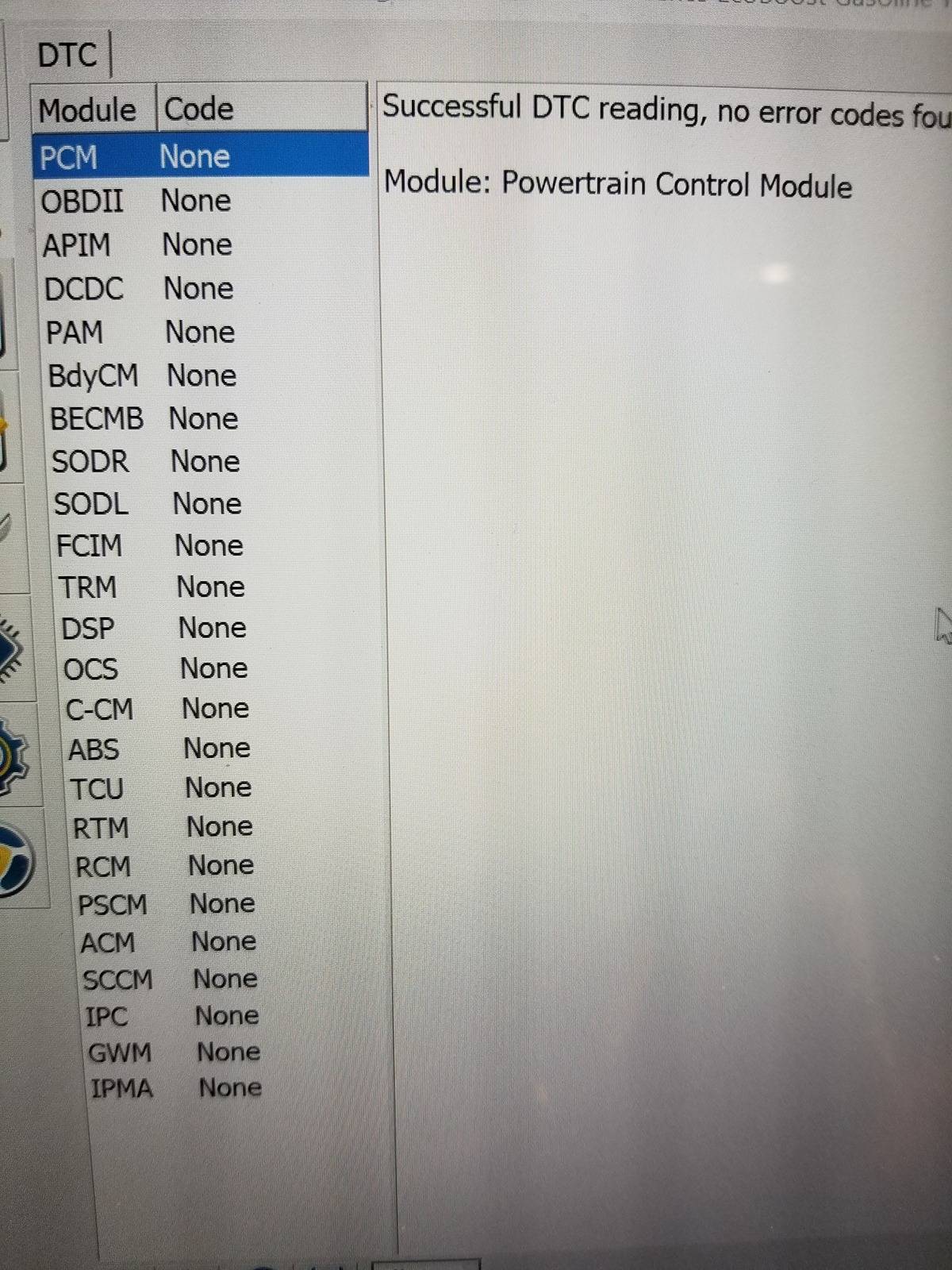

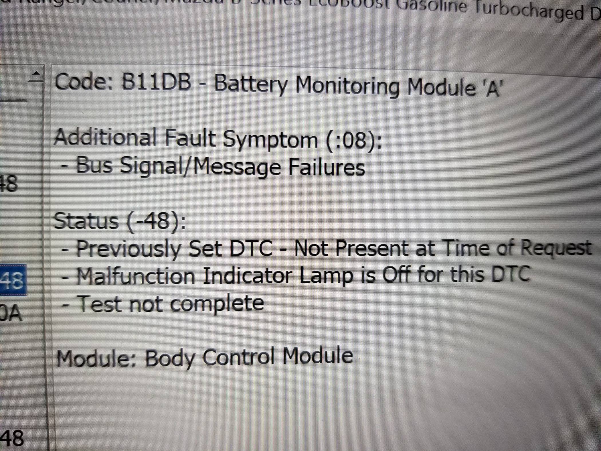

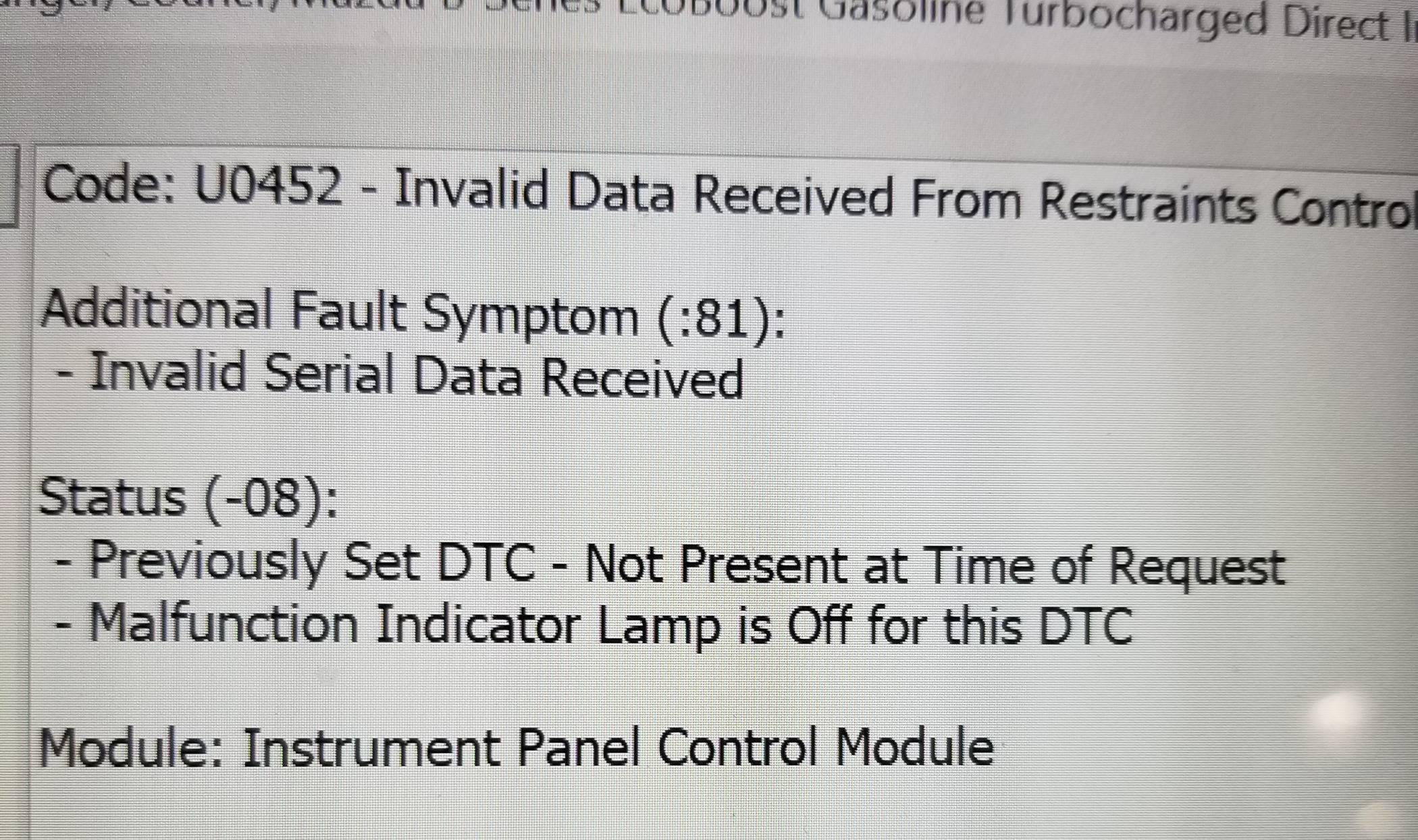

Thanks, I did find a connector unhooked that went to the driver foor and now the touch lock works on that side. Reseated all plugs at the fusebox. Still getting no key so tried reset with Forscan. Below are the errors aftet reset.

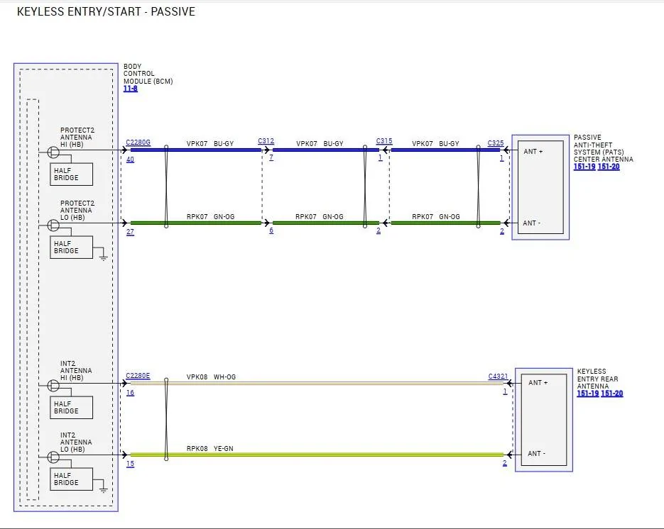

The bottom one (Interior Center Ant) is an ACTIVE fault, this is the issue.
There are 4ea total connectors between the BCM and the Antenna
You still have a connector unplugged, in the wiring under the center console.
C2280G = BCM Connector
The 3 remaining C312 / C315 / C325 are suspect as being disconnected.
and all are located beginning at the dash to console junction and then runs back under the console.
So, you need to doublecheck all the connectors you disconnected when you pulled the center console and associated panels for access.
C312 is a (21 Pin- In-Line Connector), it ties in other systems on that connector, which ties into all of the faults showing plus various systems such as the door speakers.
So, this one is HIGHY Suspect
C315 - Is a 2-wire (in-Line) connector, only feeds the Center Antenna
C325 - Is a 4-Wire (Connector) with only 2 wires, this connects to the Center Antenna.
I cannot find a clear diagram as to exactly where the antenna is actually mounted, but it is under the center console and it appears to be mounted on the console itself, just aft of the cupholders.
