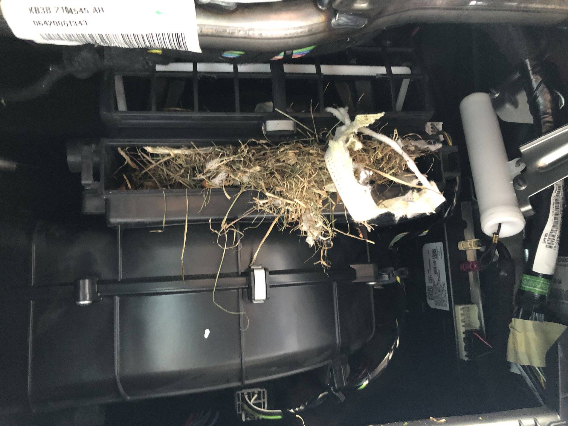

Searched but didn’t see this as a previously posted thread, so....
My fan/blower vibrates at high settings and decreases with lower settings. High speed is enough to make vehicles in the rear view mirror look fuzzy.
Yes, I’m taking it to the dealer, but just curious as to whether this is a known issue.
Thanx in advance for any and all input.

HI Thom,
Open the glove box door and drop it down to access the cabin filter. Remove the filter and using a mirror, see if the fan has debris causing the imbalance....

Hi Thom,
I recall another forum member that found acorns in the fan...how the heck they get there is a mystery to me, but I guess there is a way through the cowl...
Let us know if you found something.
Good luck!

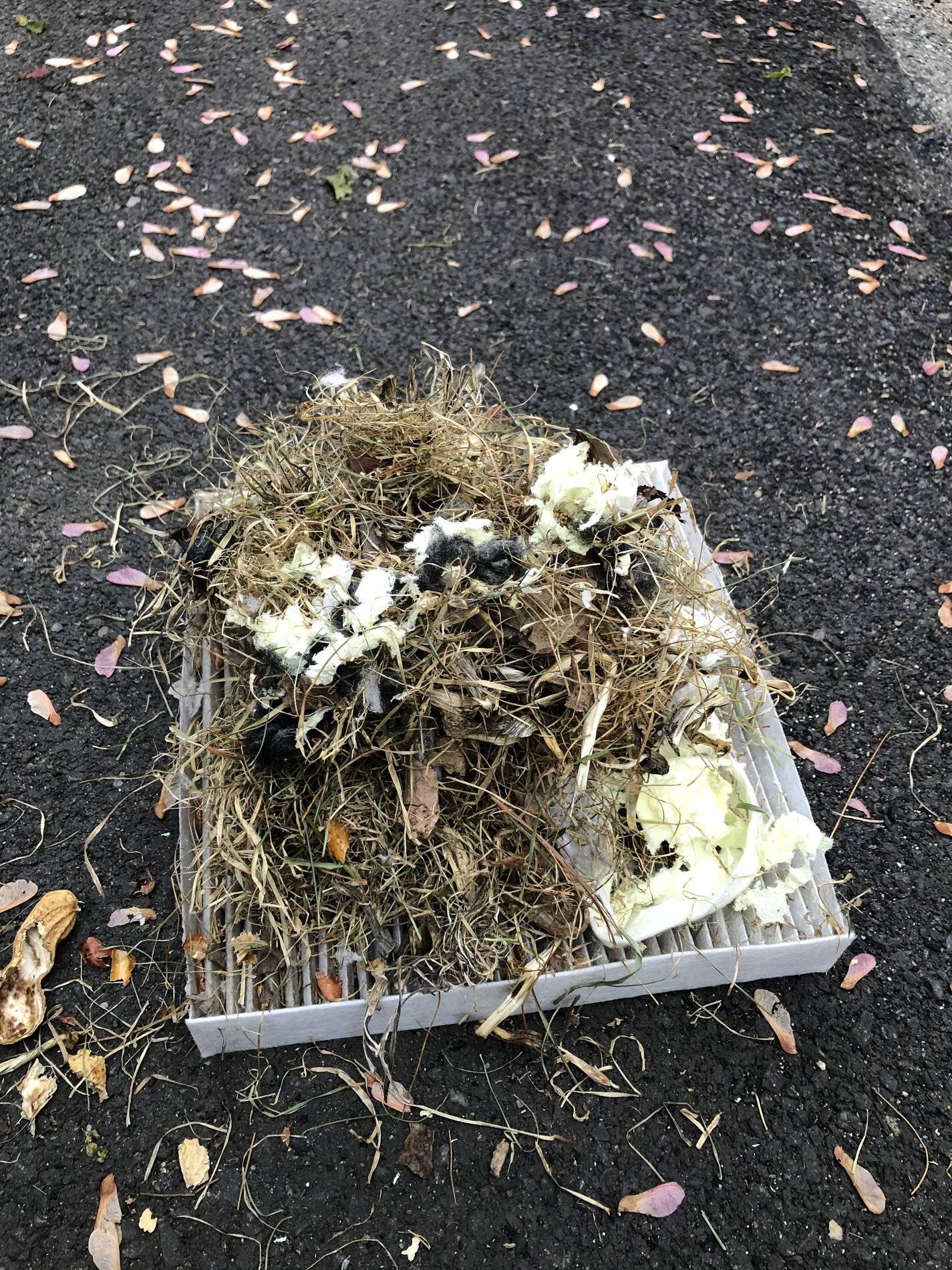

You mean like this? :p
(Thanx Phil. All is good now.)

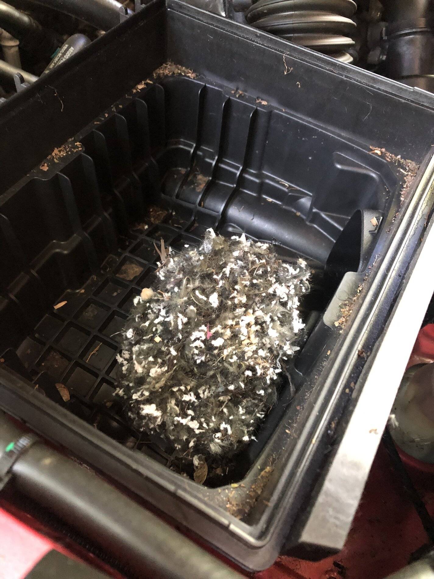

Just a follow up.
If the little buggers got into the ventilation (chewed through the recirc. grill and into the glove box to grab a mask), where else might they be?
How about the engine air intake?

too bad you never found a hole in the intake filter and one of those little shits got sucked in.....be one hell of a ride for the little POS
Mommy, why does the exhaust smell like BBQ?
