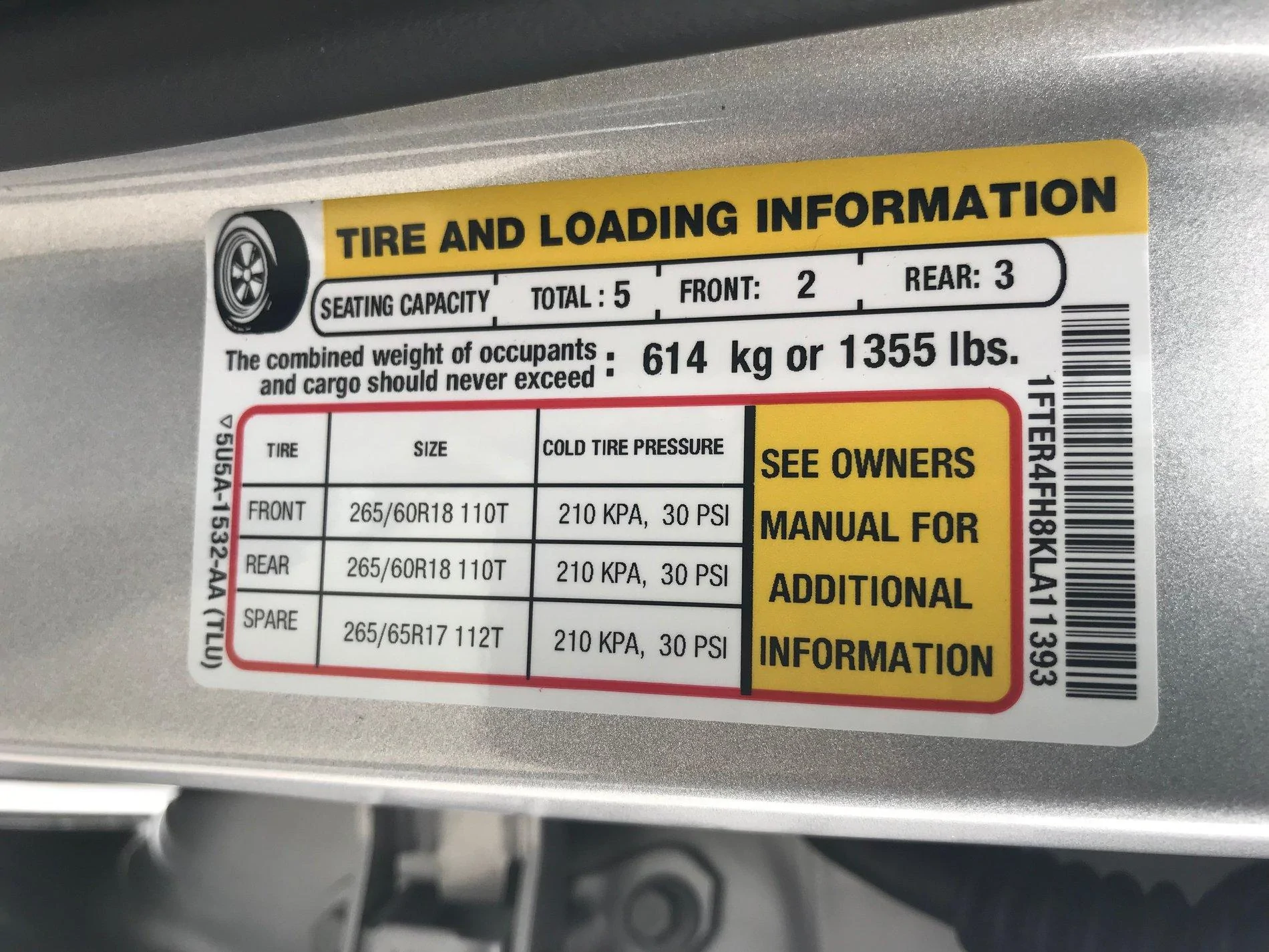

Check the door tag (all cars have them on the driver’s side) for the specific PSI for your truck.

I picked up my Lariat a week ago and the tires were way over inflated, 45/46 on all 4 tires. Not sure why the dealership isn't checking for this before the deliver to the customer. I lowered mine back to 30 per the manual.

The Driver Door Tag shows all 4 tires should be at 35. Factor sets a 45/46 as a default.
Mine states 30 PSI and that's what the dealer had them set at during their PDI.
