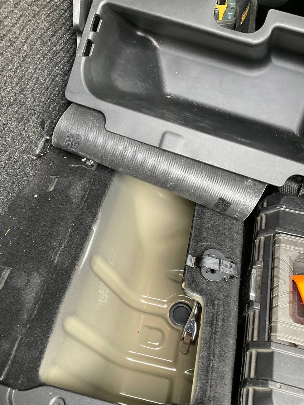

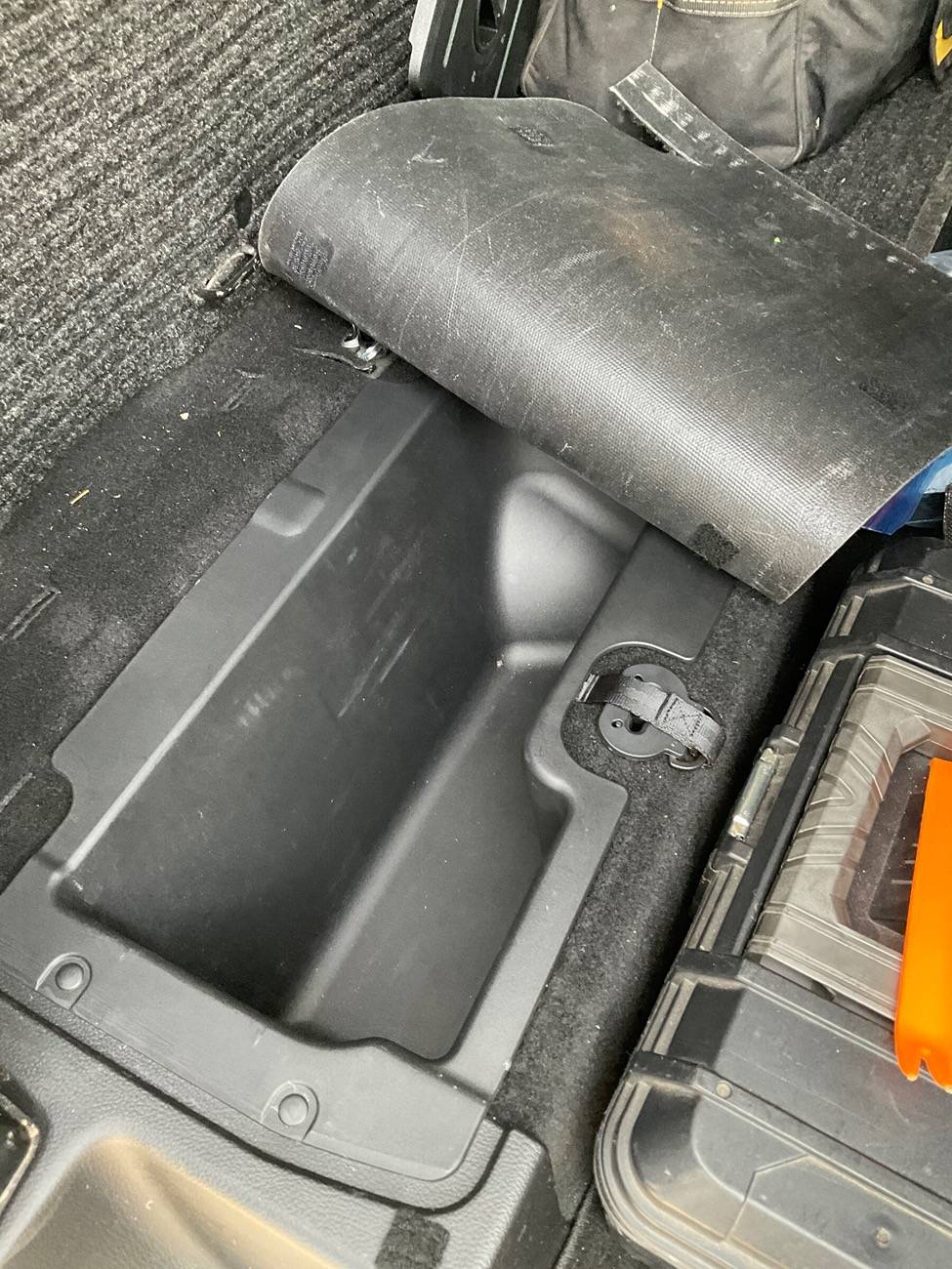

I had something very similar happen a while back - I had a clunk I couldn’t locate and it drove me batty trying to pinpoint it. I completely emptied the truck - my rear seat delete area was full of tool cases and tool bags. Emptied the console, rear seat storage bins, removed the jack and tools, emptied the glove box, sunglasses holder. EVERYTHING! Still no luck. Eventually, I gave up looking. ?‍♂
One day, I was looking for my 1/2” short breaker bar and remembered I had put it in the storage bin that holds the jack. It wasn’t there and while I was checking in that area, I noticed that storage area on my SuperCab had a large opening in the divider between the two rear storage areas. On a hunch, I opened the passenger side storage hatch, popped the push pins holding the plastic storage tub in place, and there it was, under the storage area; bouncing around and rocking back and forth with every turn and bump. It probably slid through the hole when I made a sharp left while hooning in city traffic one day - okay, every day. ?
Mystery solved and ever since, it’s been as quiet as the day I brought it home. ?
