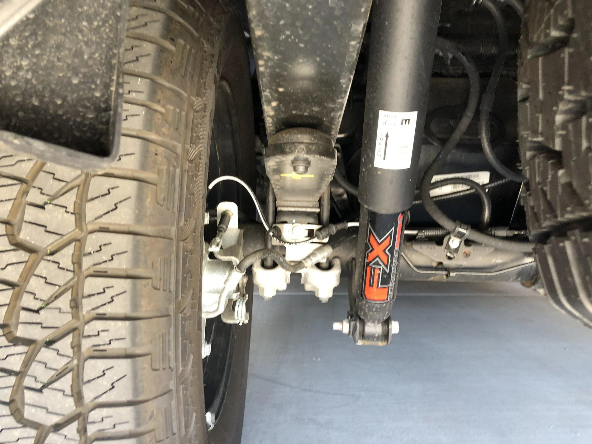

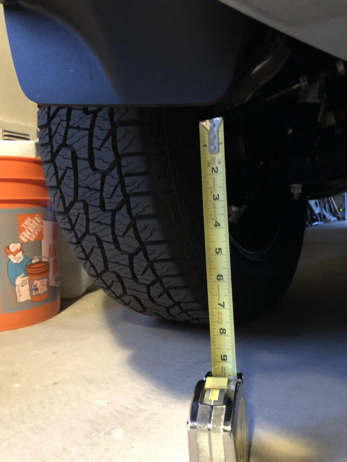

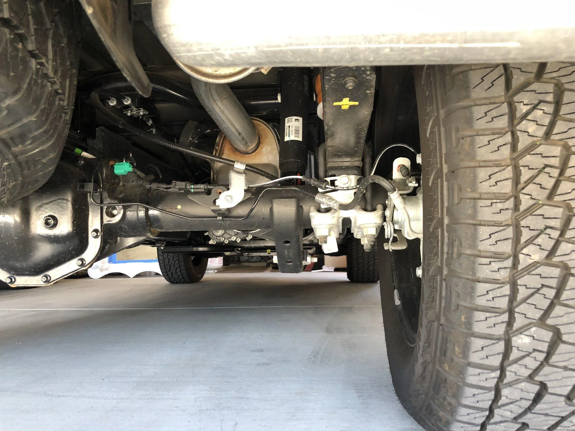

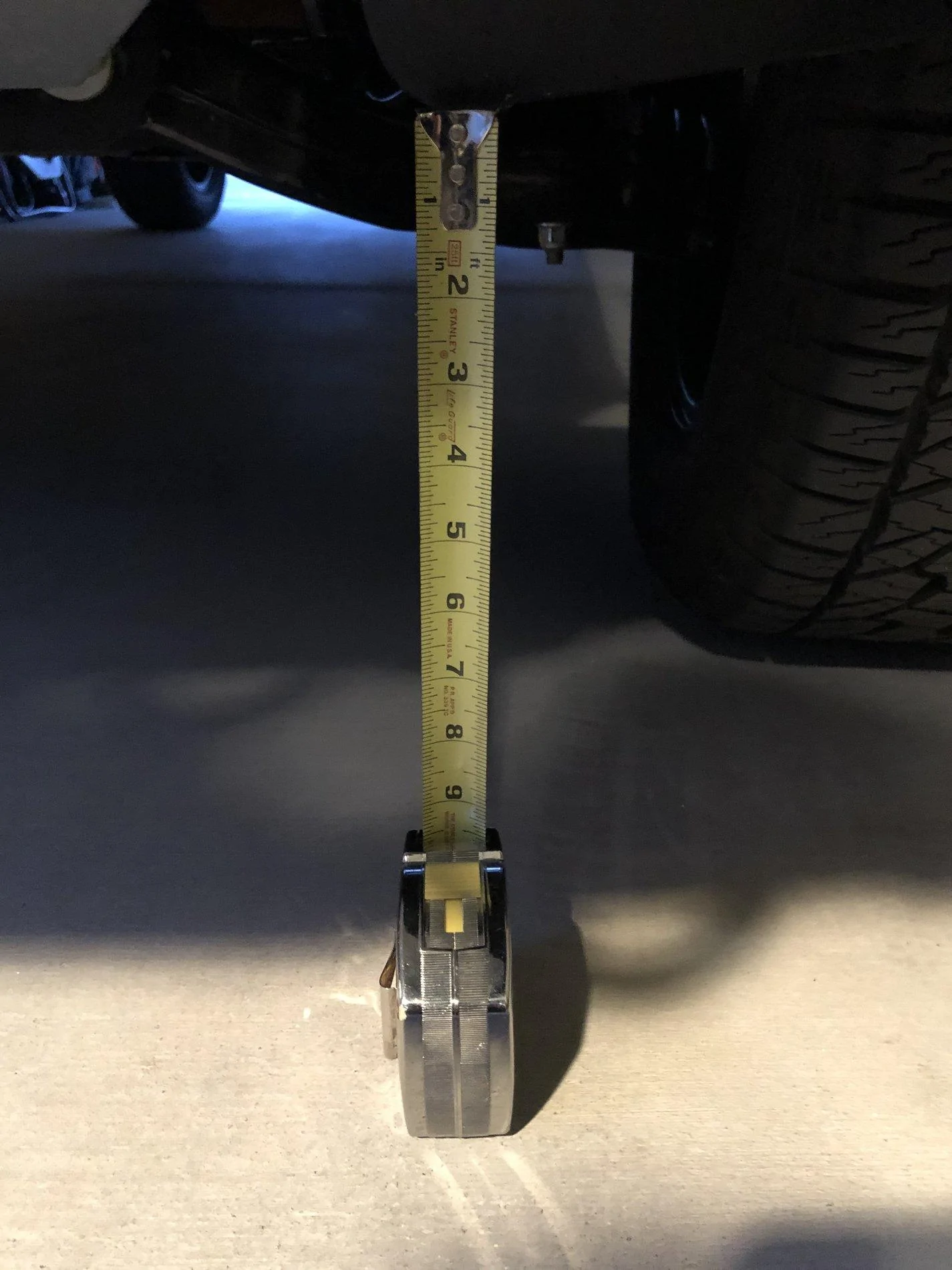

Heh, nice try... So, given that the frame/axle distance is different in the back by 1/2" what does that point at? The leaf springs ? What holds the axle in place off the frame ?

Leafs or shocks, but its gotta be the leafs.. Cant they just replace them ?

Dealership is shimming one side apparently... get it back tomorrow. Is this a viable fix? Can't they just replace the leafs ?.

Got it back from dealership after 10 days.. they shimmed the left side springs
Still looks a bit off, but better. They said it’s not guaranteed to be perfect, but since mine was so visually leaning, they shimmed it under warranty
