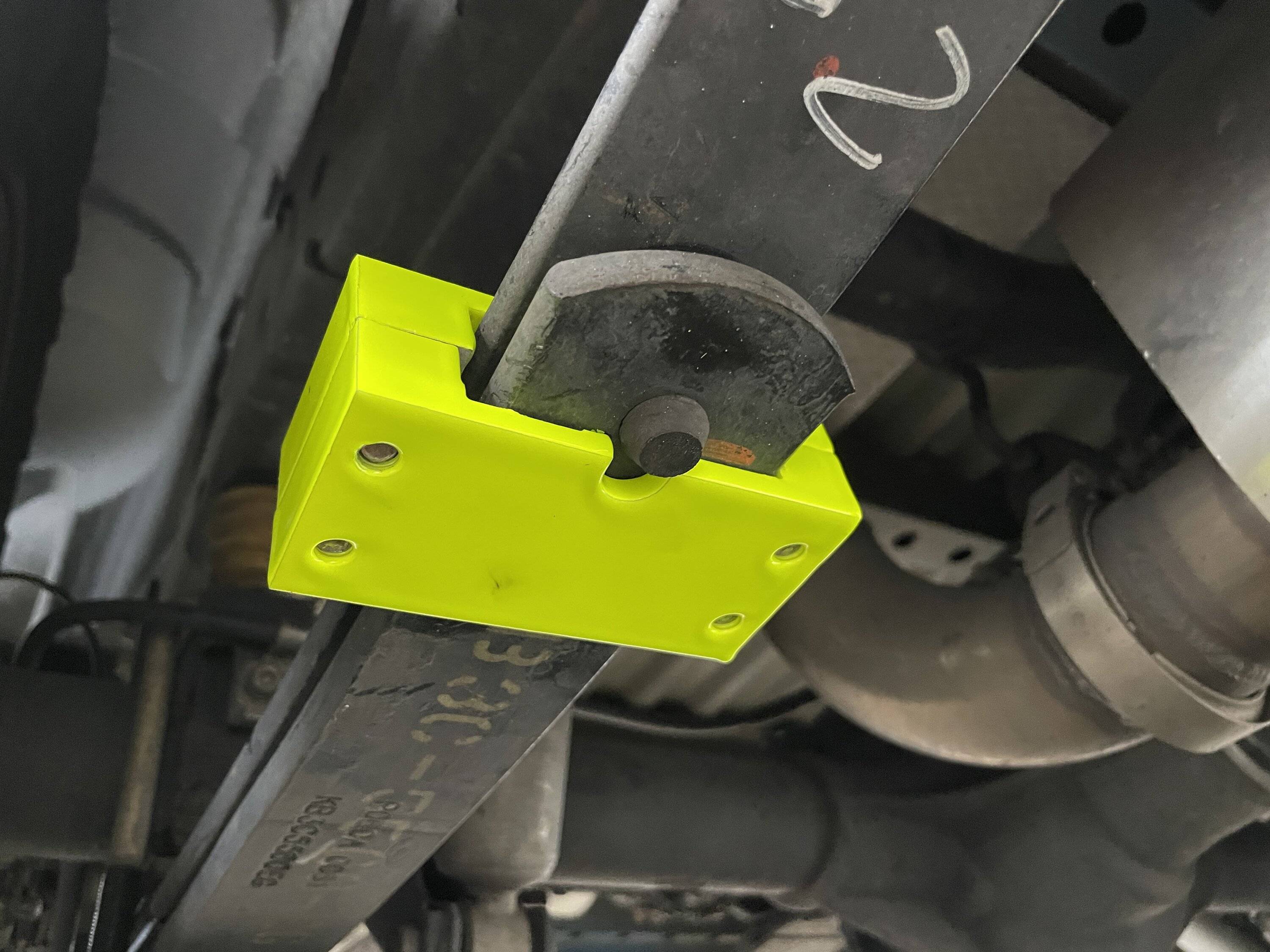

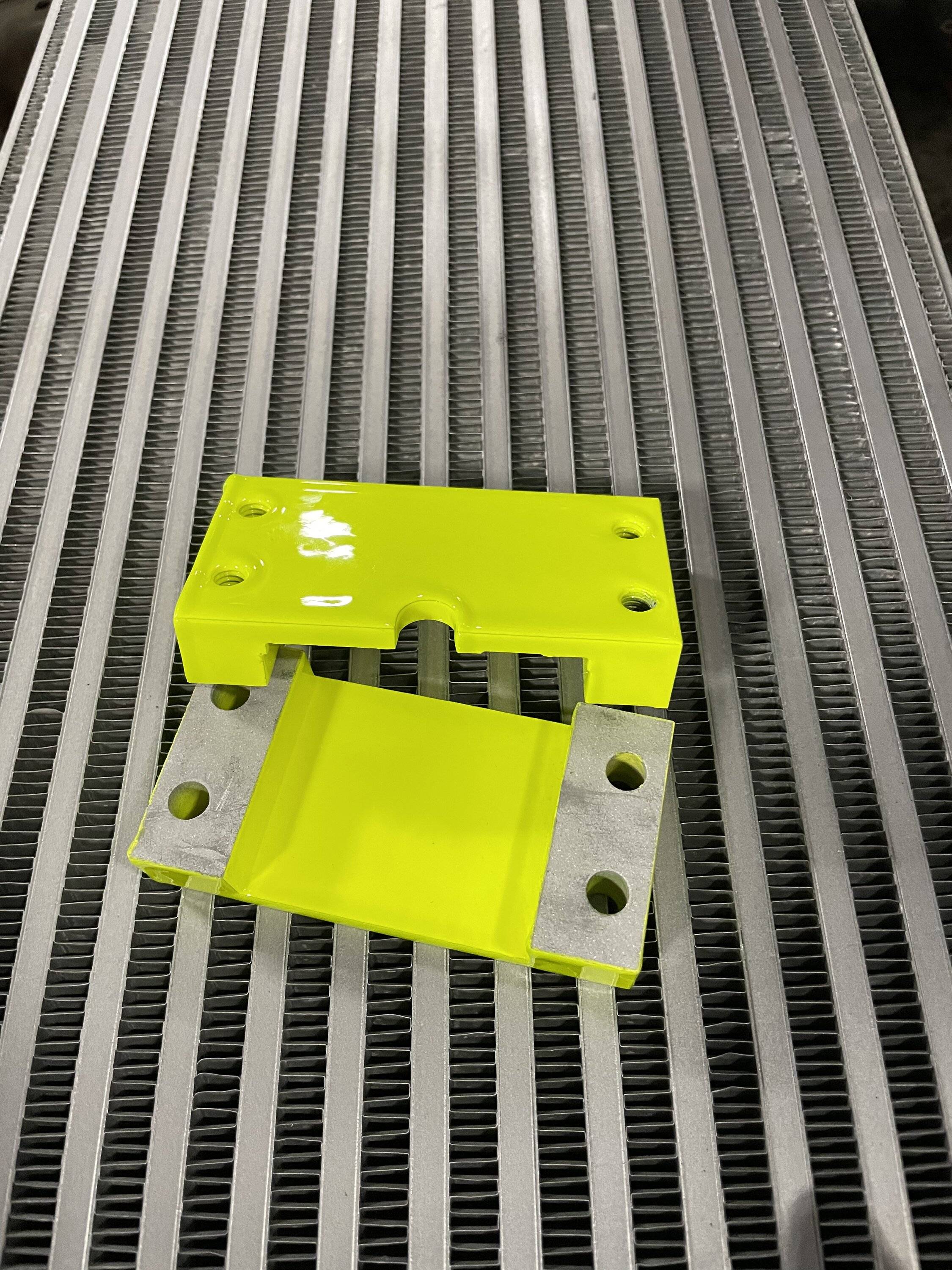

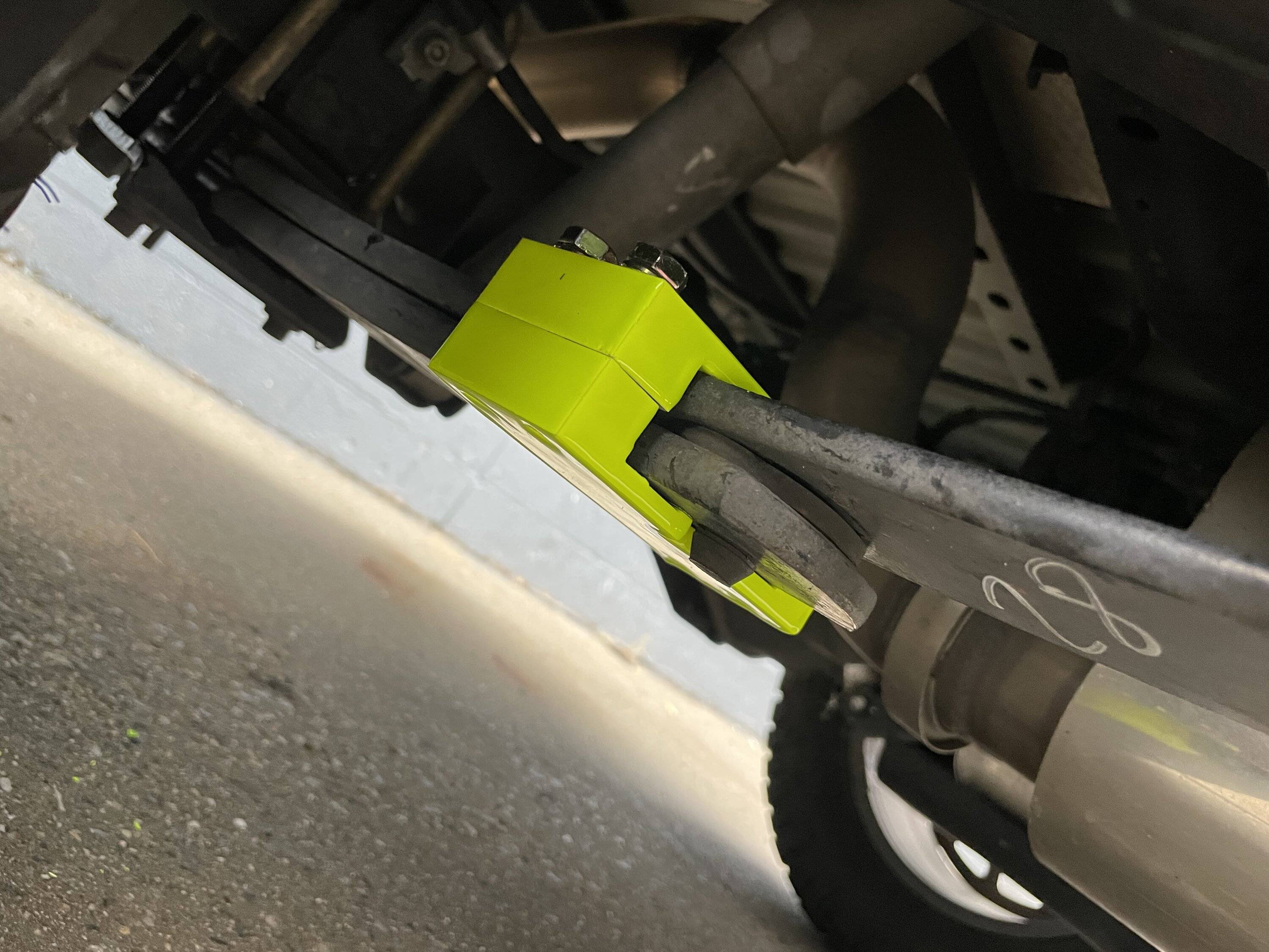

I attacked the problem a little differently. I noticed that my truck had the lean since new. When I lowered it, the lean was more obvious and it bothered me enough to run extra air on the left to even it out.
Go look at the front of your lower leaf spring under the main leaf… is it touching? Is there a gap? Now compare that to the other side. I machined a billet clamp to squeeze the gapped side together and now it’s so much better! I don’t need uneven air pressure now, it handles and rides better and traction is a lot more controllable. Important to note that my truck is already quite modified so my fix may not apply to everyone.
Interesting, I'll have to look at mine. Do you have drawing or are you going to make them? I'd take mine in black not yellow. :D
I’m not sure it’s cost effective for me to make but I’m always open to making things. There’s a $20 steel clamp available from Jegs.
I want to know how this trick works on a more stock configuration before I worry about a product yet.
And no…. I only work in yellow and everyone else must suffer. ?
My truck is stock suspension wise other than Bilstein rear shocks and Sumo springs. I'll look at springs when I get the chance. Right now we are getting someuch needed rain. I'll also check out the Jegs site.
