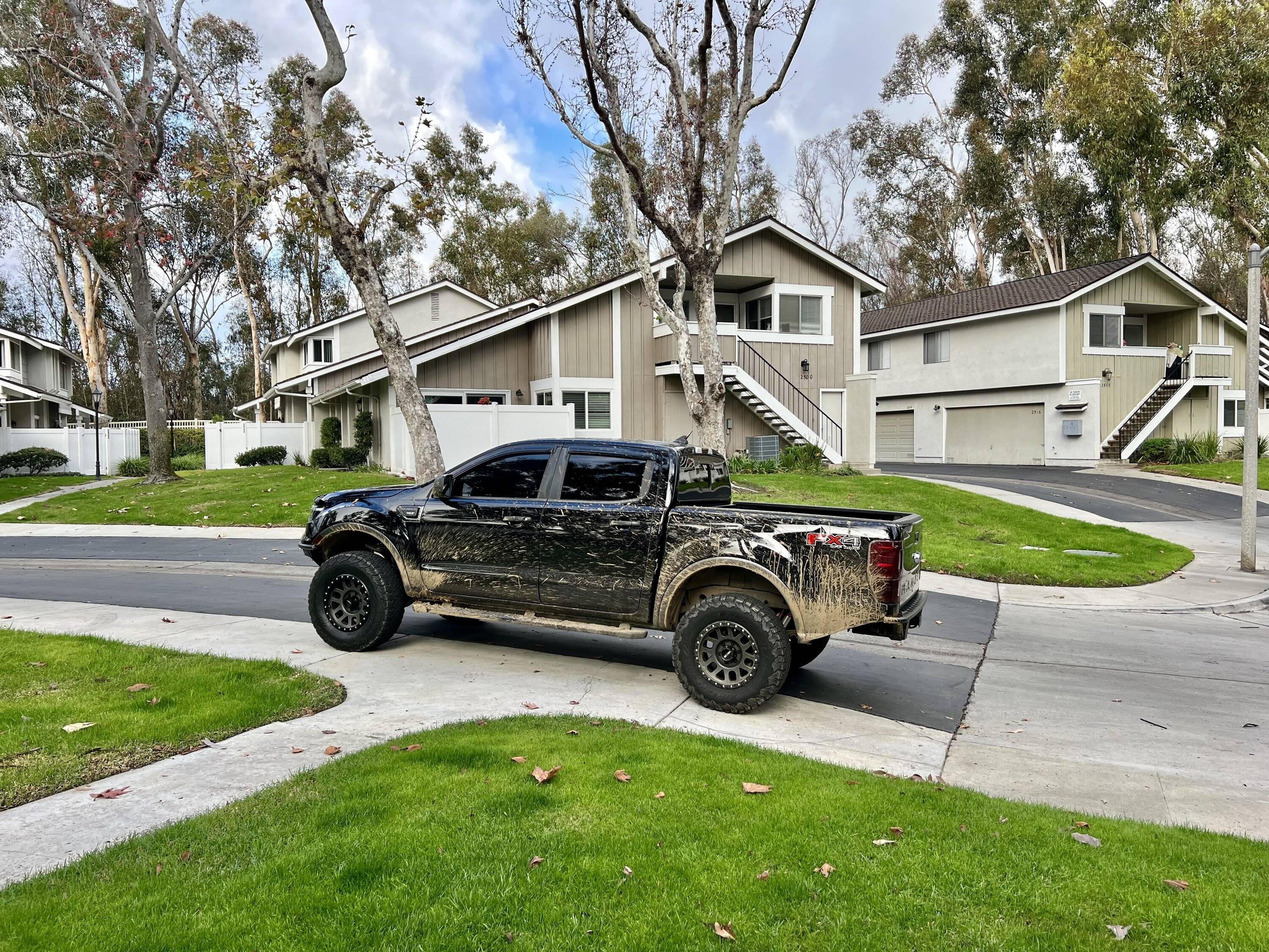

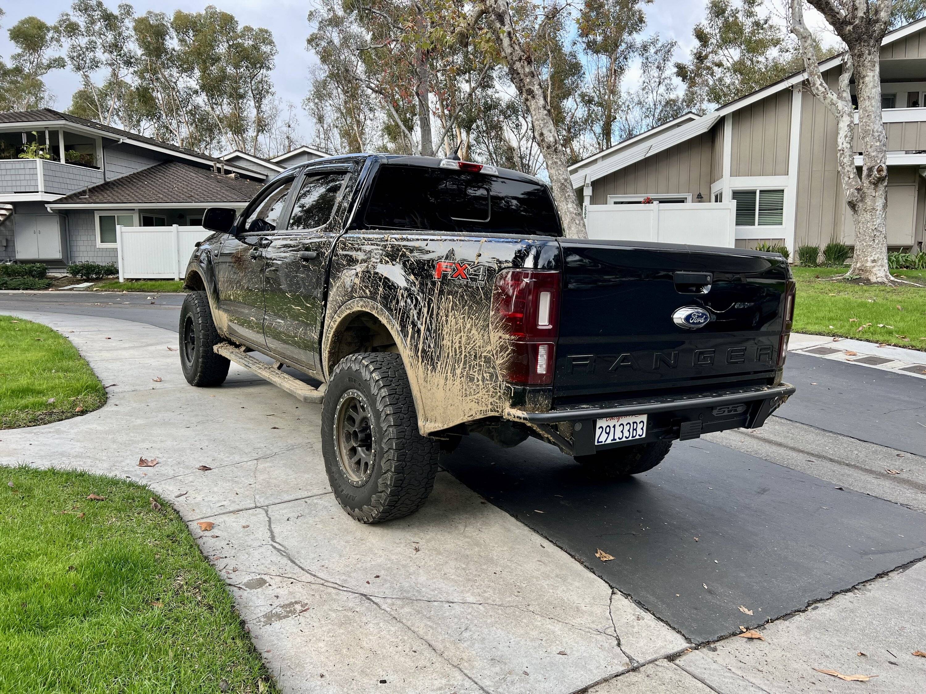

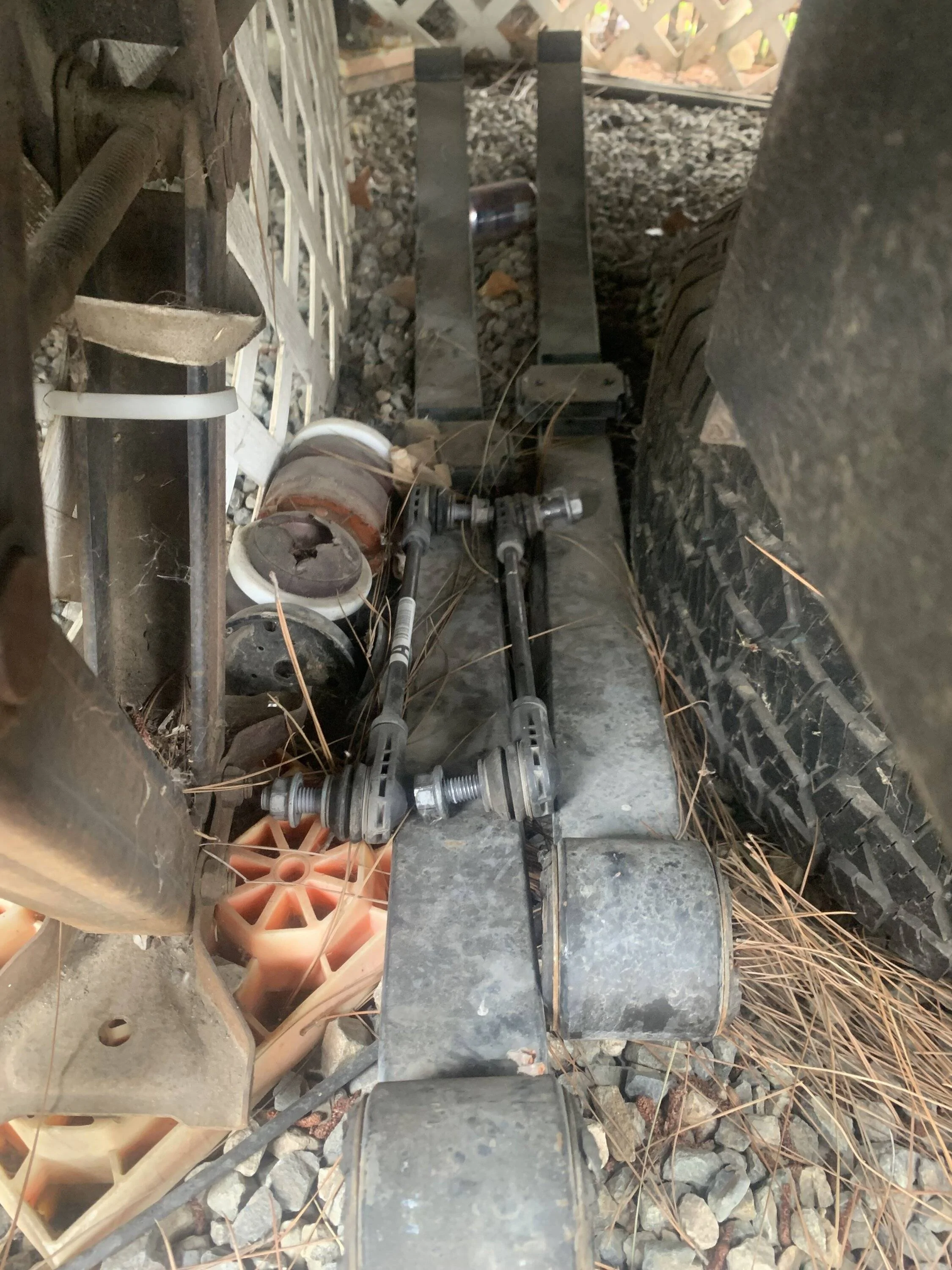

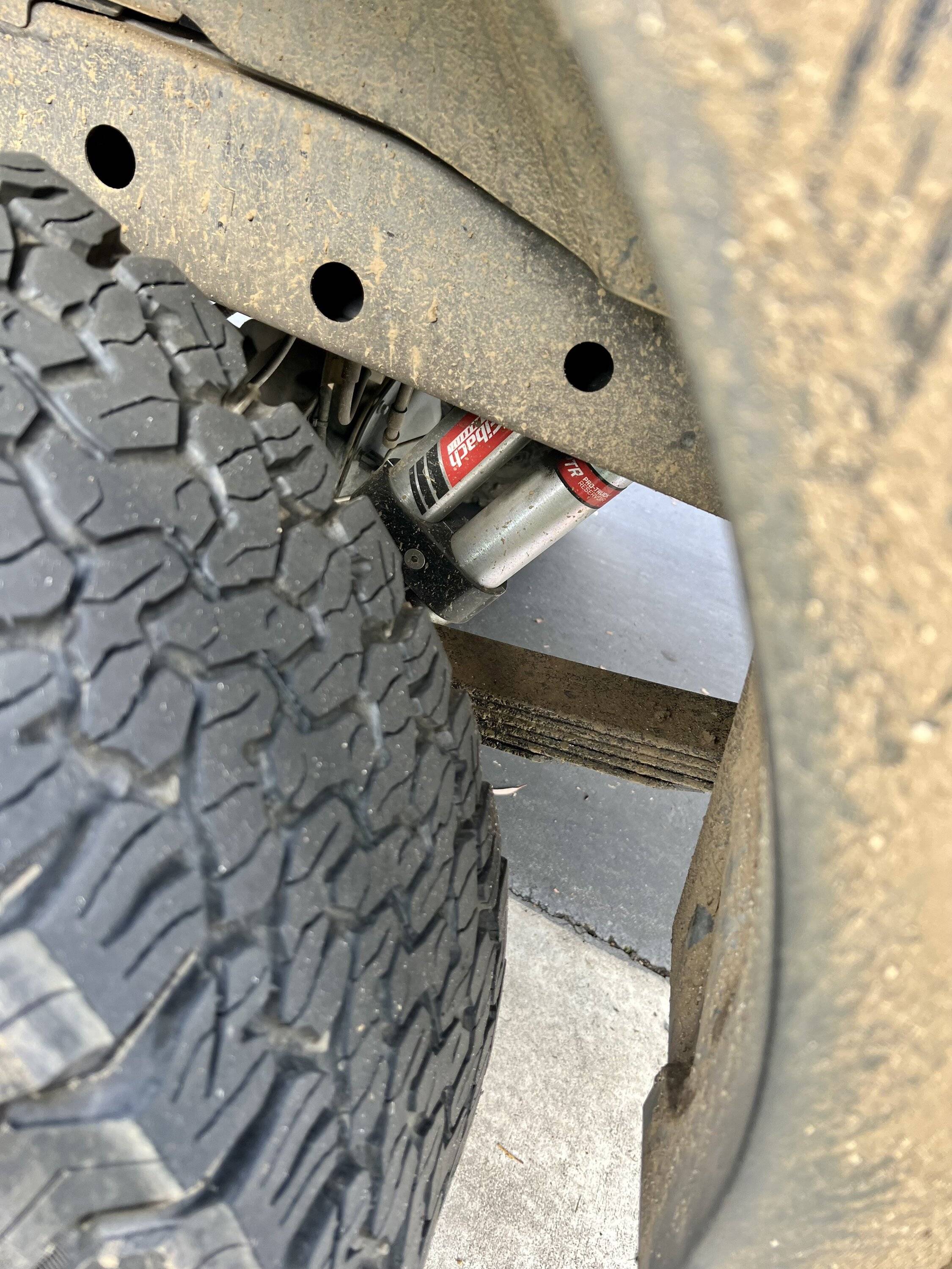

The expedition pack may have 10) but yes, awesome ride. Here are some photos from right now.

Correction: it is in fact 10 leaf springs. I just counted the leafs visible in the photo lol

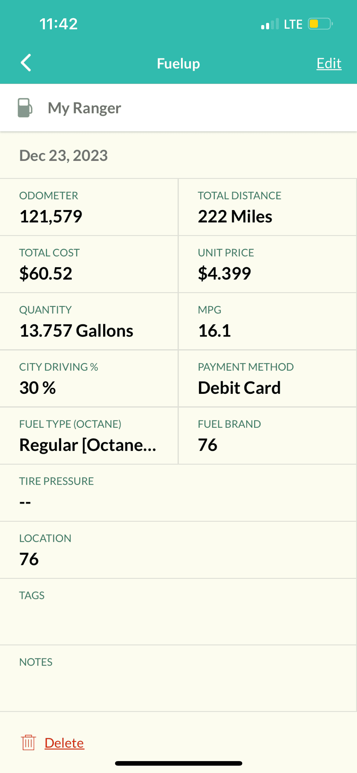

I’m not sure. I know Frenchy is way up there in miles as well. Here’s a screenshot from my fuel up yesterday at 121,579. I’m still on the original transmission. Only major mechanical issue was needing a new spark plug and ignition coil around 115k miles. I’ve done the regular scheduled maintenance and nothing extra or special. I just did the spill and fill on the tranny, diff and transfer case service at 112k. Truck is running like a champ.

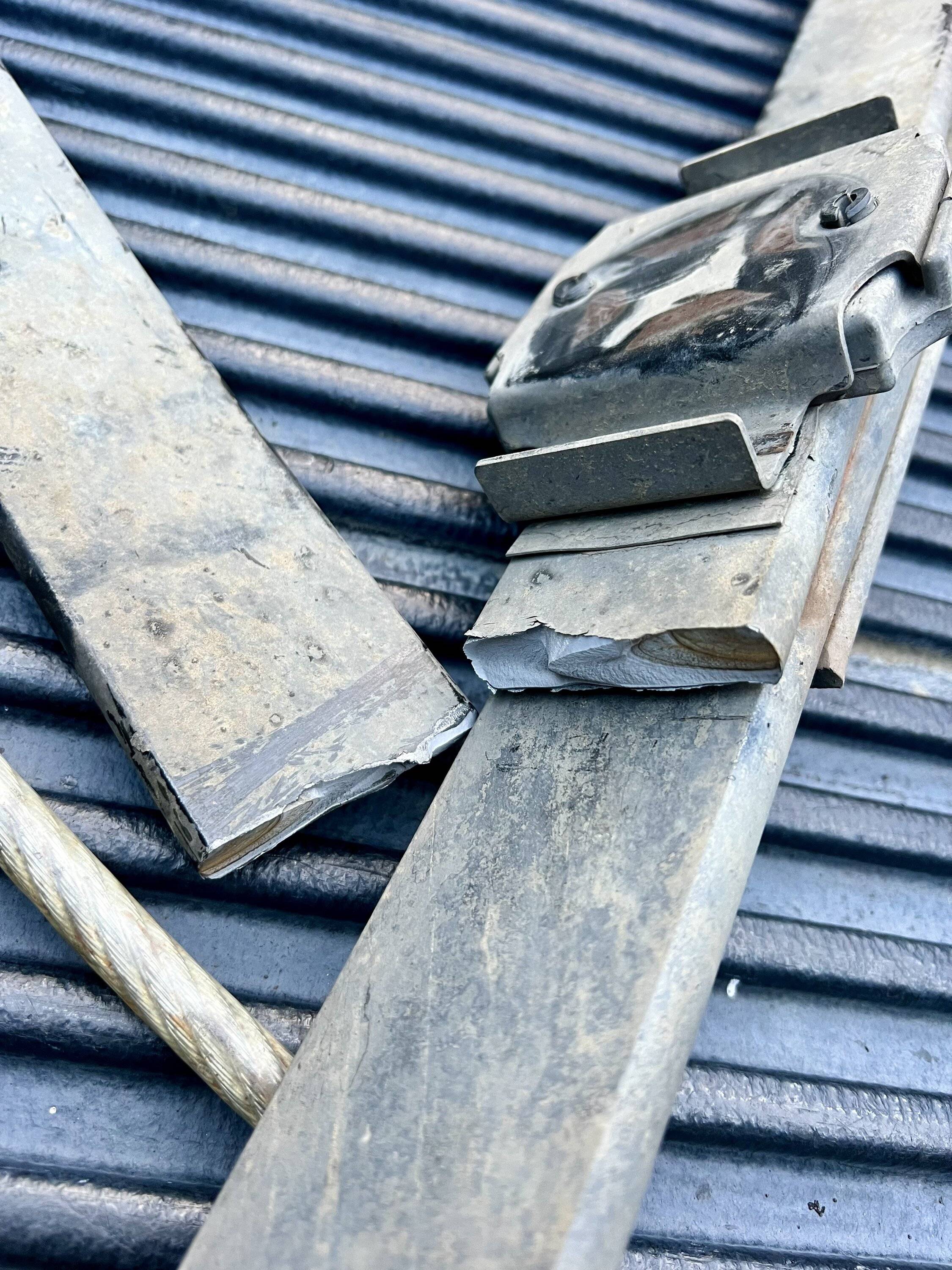

I was hoping santa would bring it for Christmas but that ain't happening, thanks for the aftermarket advice .....was there any reason for your leaf to break ...I barley drive mine thinking it was faulty manufacturing only have 12k on my 2020
Thx dave

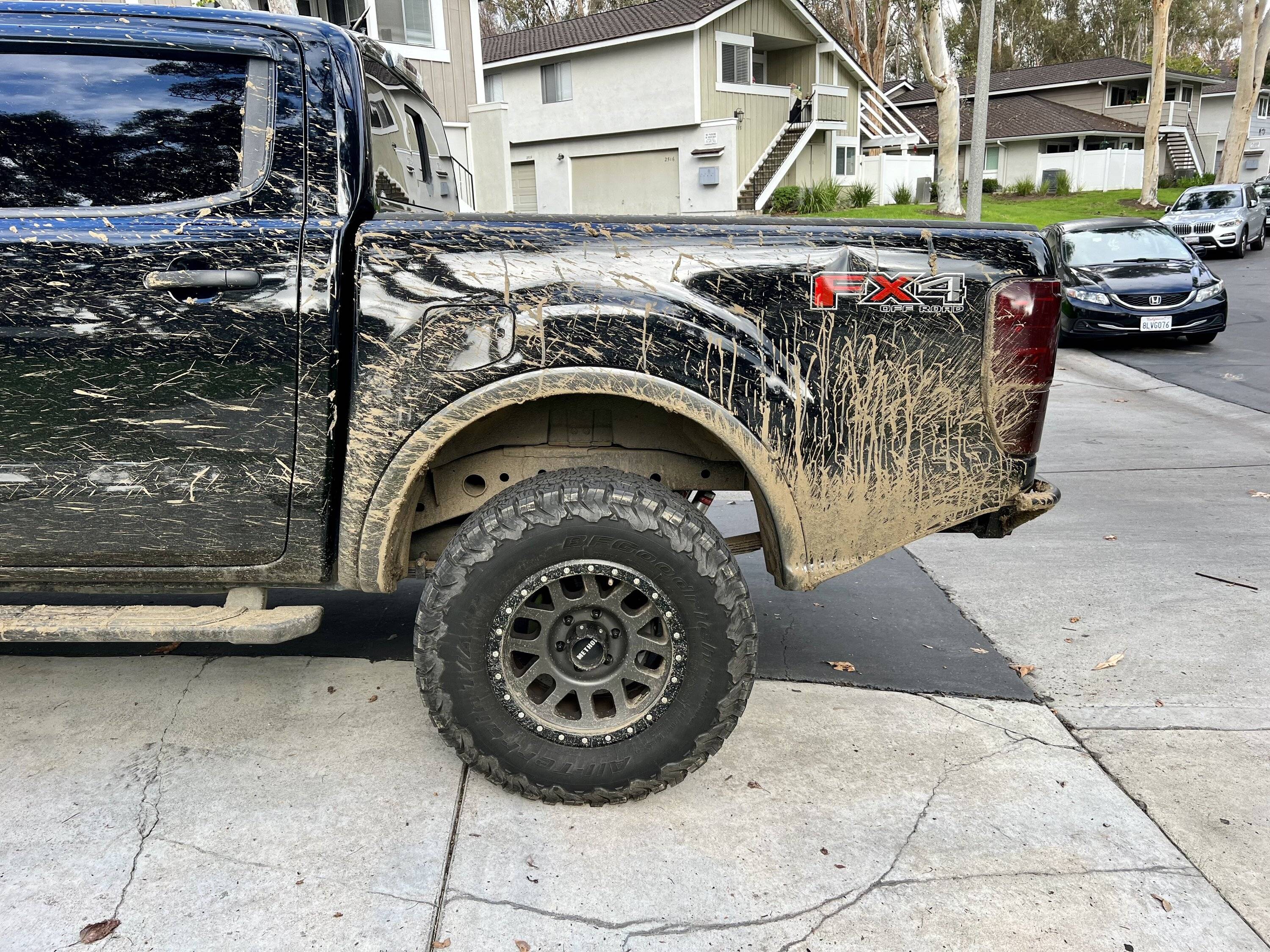

Here’s a photo of the leaf spring. It looks like it was corroded and snapped at the weak point. Dealer service dept had never heard of a newer Ranger or F-150 even snapping one and don’t carry them in stock as it’s so rare to replace. I don’t haul or tow and rarely carry to stuff in the bed. It snapped when I drove out of a 711 parking lot. From the drive approach to the main road and didn’t even go off the curb.
